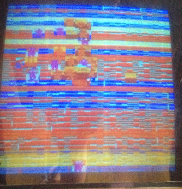

It powers up, the screen works but initially was flickering but few adjustments on the dials stabilised it.
Iv taken a some of pics of the screen after it was on for 10 mins the scrambled mess changed a bit, once the thick layer of grime was cleaned off the screen , it seemed to be in very good condiditon, no screen burn, the colours were strong and image is bright.

Have you tried reseating the roms yet?
I've had 2 DKJr boards that just needed reseating to get them working 100%
If the legs on the chips seem blackened, give them a (careful) clean off with some fine wet n dry.

Thanks for the link , the picture seems to be a mixture of those chip problems. I'm goin to take the game board out soon, it's covered in a layer of dirt there is a little rust on some of the chips. so hopefully after a good clean the screen might give me some hope it'll be working again!

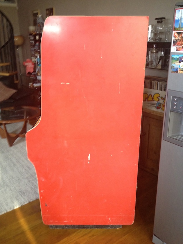

There are a few dings and marks on he side but the old paint still has a nice shine to it and I want to try and keep it as original as possible so will look into touching up minor marks.
Took the pcb out yesterday , accessing the chips is a bit of a ball ache as the boards are fixed together with plastic plugs, cleaned a tiny bit then put it all back in , started making noise after bit like a spring bouncing.

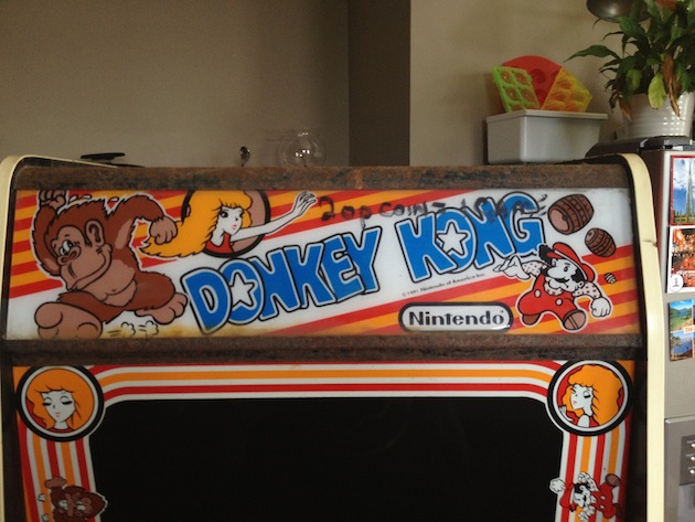

Here are a few more pictures of the cab before any cleaning up. Iv done quite a bit to the cab, and I'll post some new pics soon.
its been thoroughly cleaned, metal parts stripped and resprayed, , new marquee light and Iv had a few large boxes from mikes arcade

I started with easy stuff , got a magic sponge on the marquee and it looked like new after.
The bezel has minor scuffs and is in a surprisingly good condition.

I have cleaned the 4 board set and it improved what was showing on the screen, but far from working. So I decided to order a 2 board set from mikes arcade too

There are a lot of dings and dents on the cab , but overall the formica finish isnt bad. I wanted to retain this colour and finish so found a paint to fill in the gaps. Its not an "as new look " but I like the look , retains some character and history.
