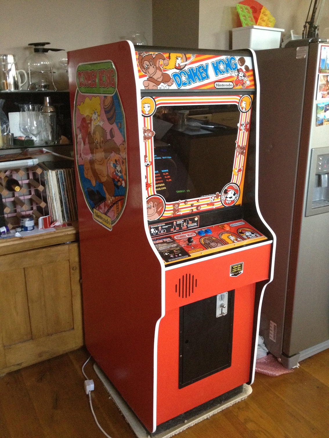

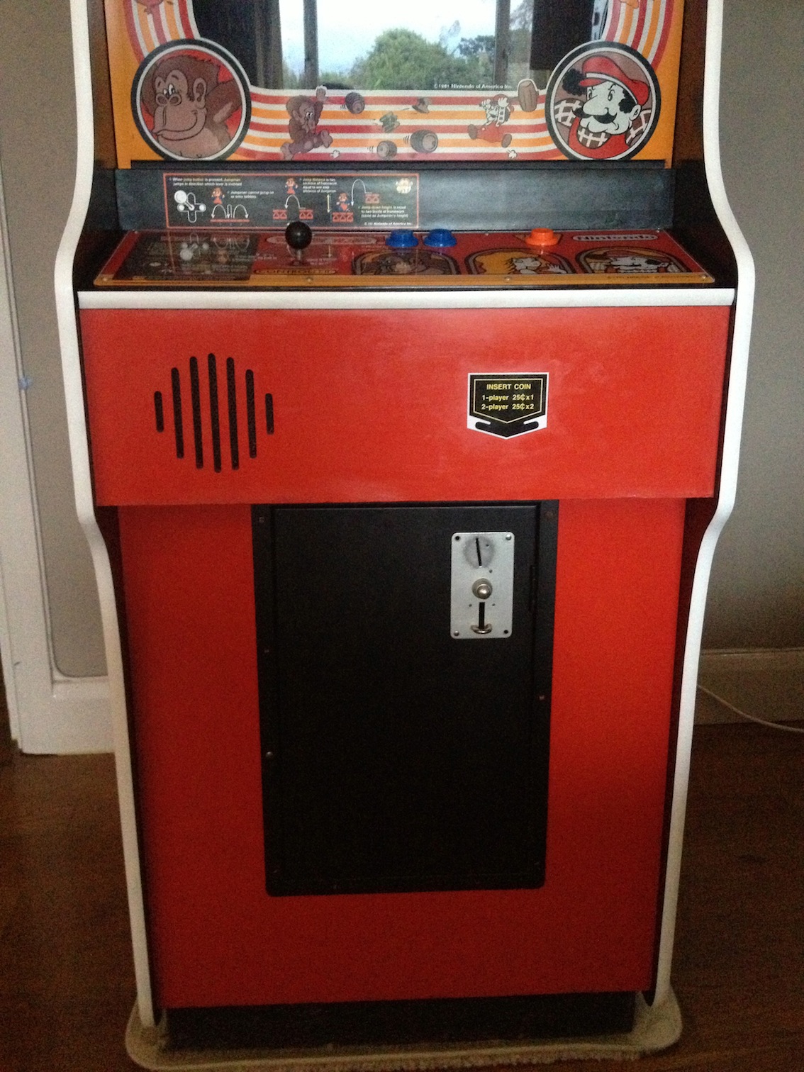

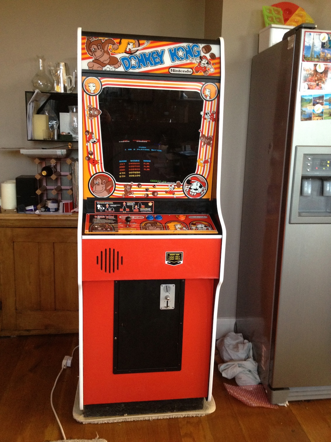

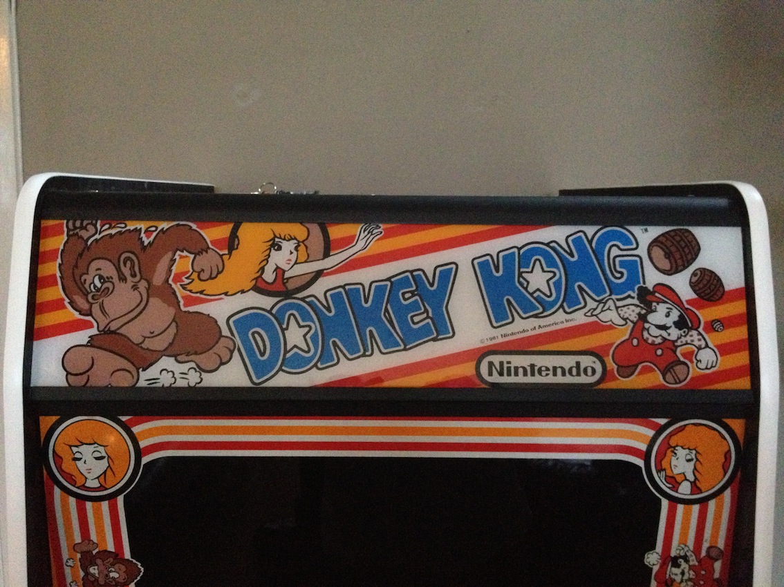

so those are the most up to date photos.

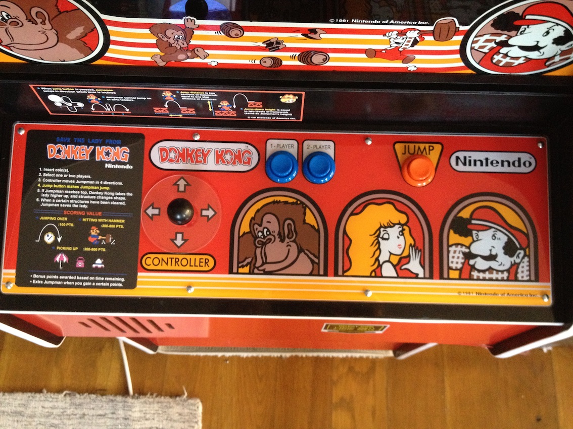

the side art had only been stuck on with blue tac, still need to stick it permanently. Having nothing to compare it too the side art looks really good! was from mikes arcade too and the quality is very good! same can be said for the CPO !
