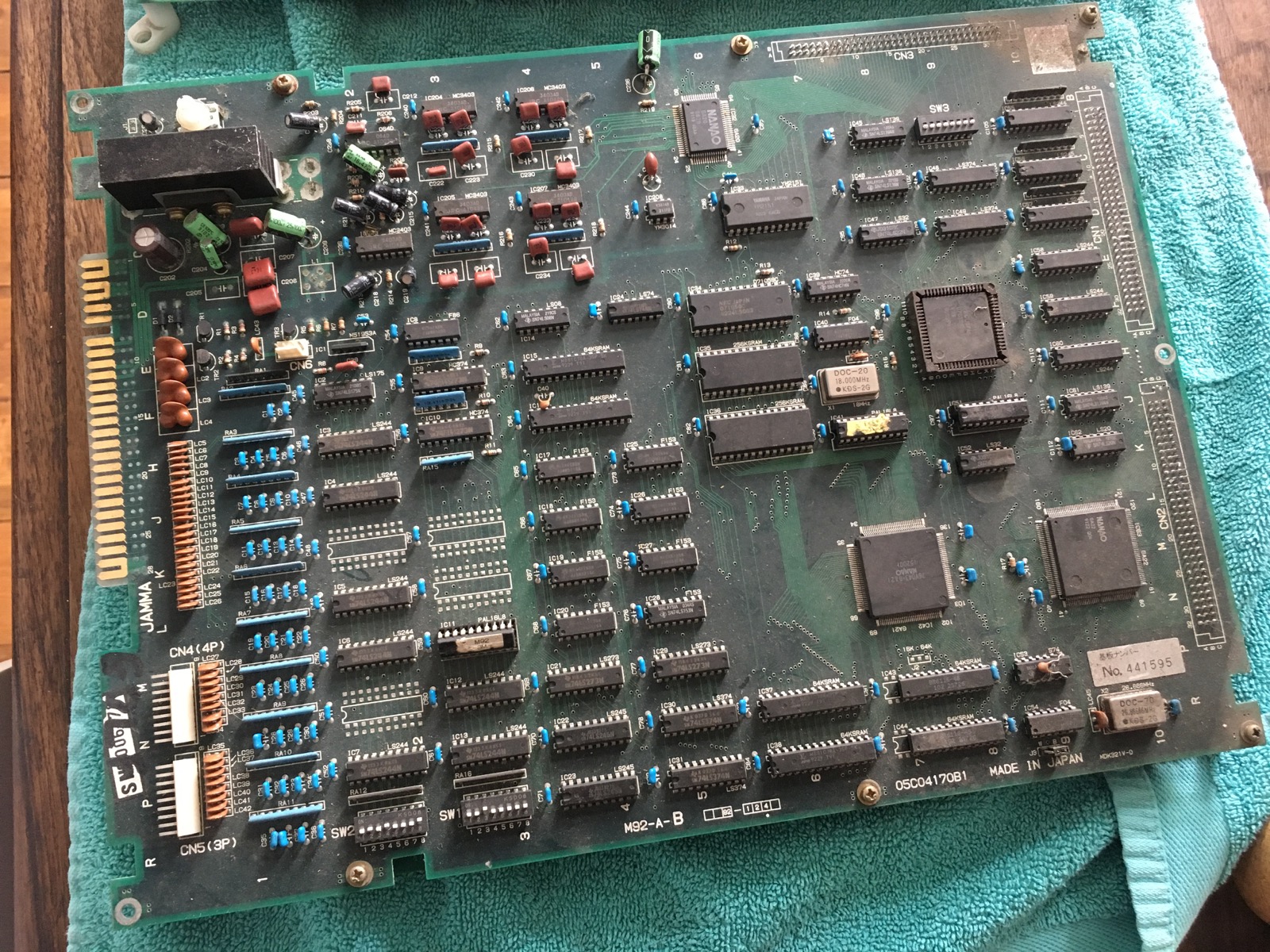

Went to pick up a new pin yesterday for use with board testing and whilst there i picked up a load of old pcbs boards, that had been sitting in a box gathering dust for years, forgotten about.
Seem to be mainly golf games! :( but... Checking through them today i've found this 'NANAO' board..
Under the years of dust i found this label.
Turns out to be an IREM Major Title 2 M92 board original, so, i'm going to have a go at converting to an r-type Leo board for inclusion in my much loved r-type cab :)
More to come when i get to grips with converting this :)

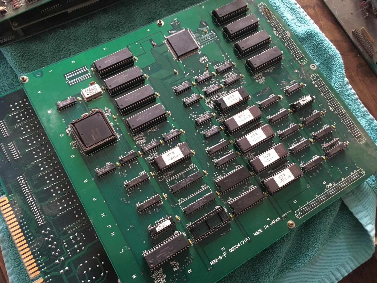

Rear of pcb

Well, my r-type leo board conversion sub project is a go!
I tested the major title 2 pcb that i got recently (with a load of random purchases). Still mega chuffed to get this board in all the junk. Real bonus
Board came up ok and passed a ram and rom test. No sound, just a load of clicking and noise, but i'm hopeful i can fix that
Onwards to the rom swap and jumper changes :)
Rear of pcb
Also, i still need to order my control panel parts from mikes arcade, though i have the list of things i need now done!
Change the green caps. They are notorious for leaking and killing the board.
