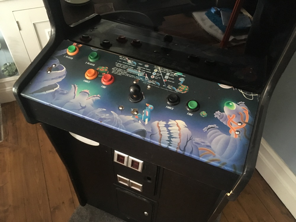

Cleaned up the control panel basics. Will do a full stripdown and rebuild of controls later. Used some magic eraser to take off the grime and engrained dirt off the art work. The buttons need a complete redo!! Rainbow selection of random stuff on there at the mo! I'll be getting all new from mikes arcade here. The joystick itself seems pretty good and responsive, but i guess i'll know more once i play it!. The vinyl overlay isn't in super condition, its ok but has some burns, cracks and missing bits so i may see if theres any replacements around for this in the along term. I need to stick down a few edges where the vinyl decal has cracked and lifted. Also not sure if its a little faded.

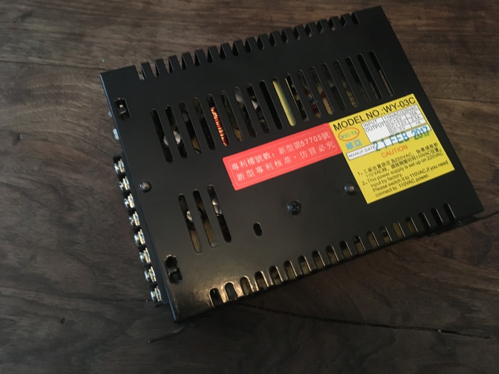

Next up i've managed to source (thanks to Craig for the molex part number) some correct molex connectors for the internal game wiring so i can build a cable for the missing +5 and +12v power supply and use a switched mode one running from 240v in.
This is the switch mode psu i'm going to use for now. My plan is to source an original supply eventually but hoping this will work ok for now and is of reasonable quality. This can be run from 240v in so it will keep the load down on the internal 100v output transformer, so there are benefits here, but its not official or factory by any stretch!
PSU mains input cable using factory molex connectors

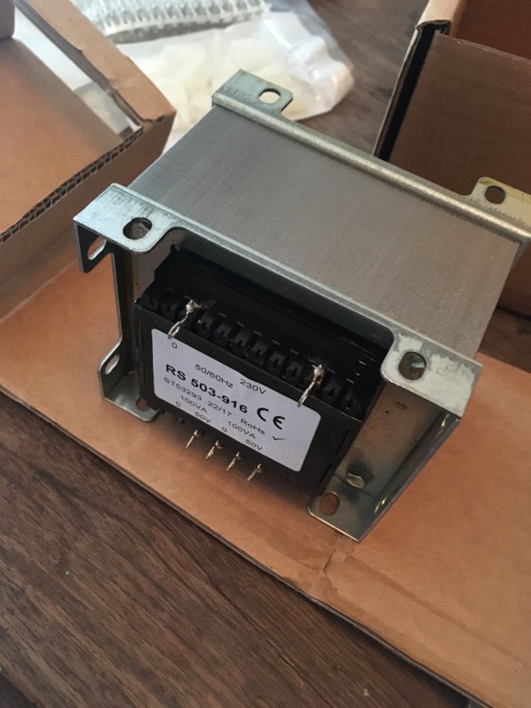

Here is the isolating transformer i have sourced that is 230v in and 100v output. (2 50v taps that can be connected in series) The spec is 200VA total so should be more than adequate for running the monitor and uv tube. If and when i get an original 5v/12v power supply then i may need to look at this again as the load may need to 300-320VA max for that.

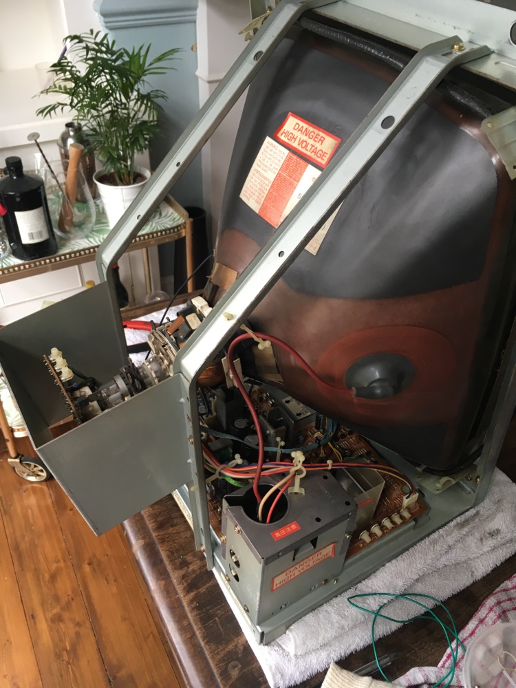

So next on the list is to fix up the Sharp Monitor. This is non working as the Horizontal Width coil heated up too much and fell out at some previous point in its life!! I am currently taking the monitor apart and cleaning up to assess the damage. I have the part that fell out so hoping that it can be reinstalled and the board damage repaired. The tube itself look in pretty good condition. Alittle minor screen burn from the r-type logo page but nothing too bad.

The monitor needed to have its horizontal width coil reinserted (after it had fallen out of the board) plus i had to change a resistor that was burned up that fits in parallel to this coil. Also i needed to change the HOT which was shorted and of course replace a few fuses. And bingo.

Width Coil Repair. The width coil casing had been damaged by the previous issue, but the coil istelf was intact and still ok. I straightened out the pcb lugs and repaired the pcb traces underneath and changed the burnt up resistor with a 'flame proof' modern version.
