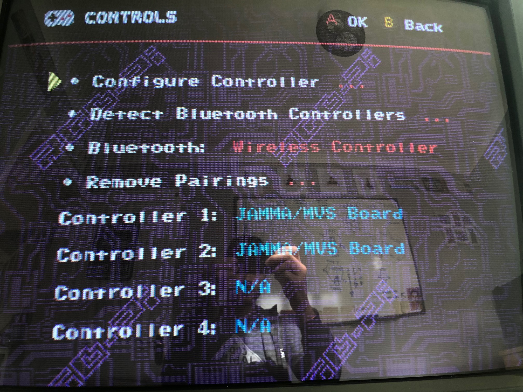

Good Morning All
Does anyone know how to configure a bluetooth controller with RGB-PI, I borrowed a PS4 Controller, i am able to pair it, it detects it after pressing the Playstation button and Share and then under bluetooth says Wireless Controller but then going into Configure controller wont allow me to add controller 3, 1 and 2 are Jamma on my Jamma Cab.
Any Ideas?
