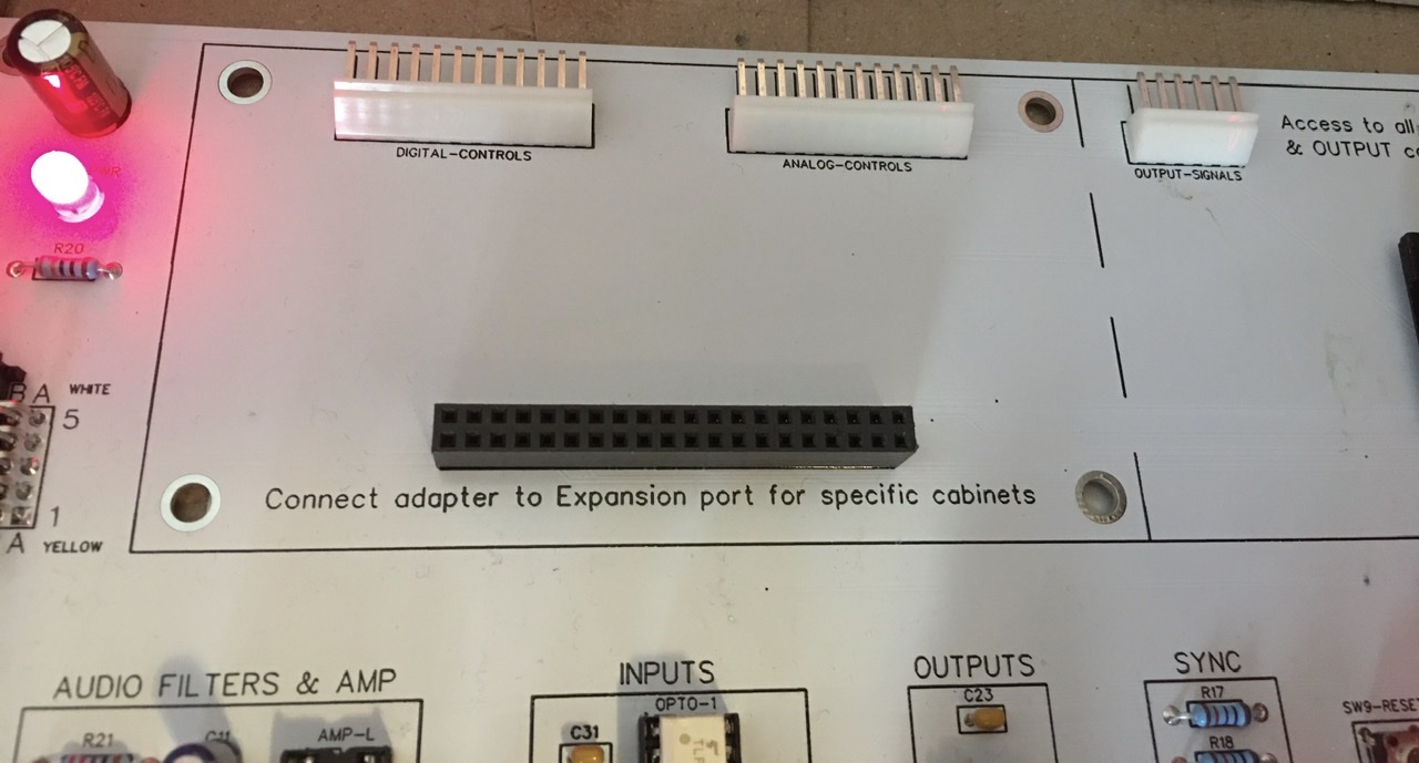

just a thought, its great to have a plug n play solution, but in theory this board could be used for hundreds of games, would there be any merit in making a "generic" 2nd adapter board, say with an easily solderable jamma style edge, that way people could make their own adapters for games that aren't common enough to warrant making a dedicated adapter board.

I am toying with the idea of adding a JAMMA connector to make for easy hook ups of power, video and the digital inputs. The spec is 4 analog axis and 7 digital buttons and a control button so doesn’t really fit in to JAMMA spec for gaming there’s plenty of Pi Jamma adapters out there. The design I already have already included header connectors for the digital, analog and output signals.

Ah that makes sense, are the inputs normal JST connectors? if so wouldn't be too hard for people to rig up a custom harness, obviously the adapter board is the cleanest way but nice to have as many options as possible.
