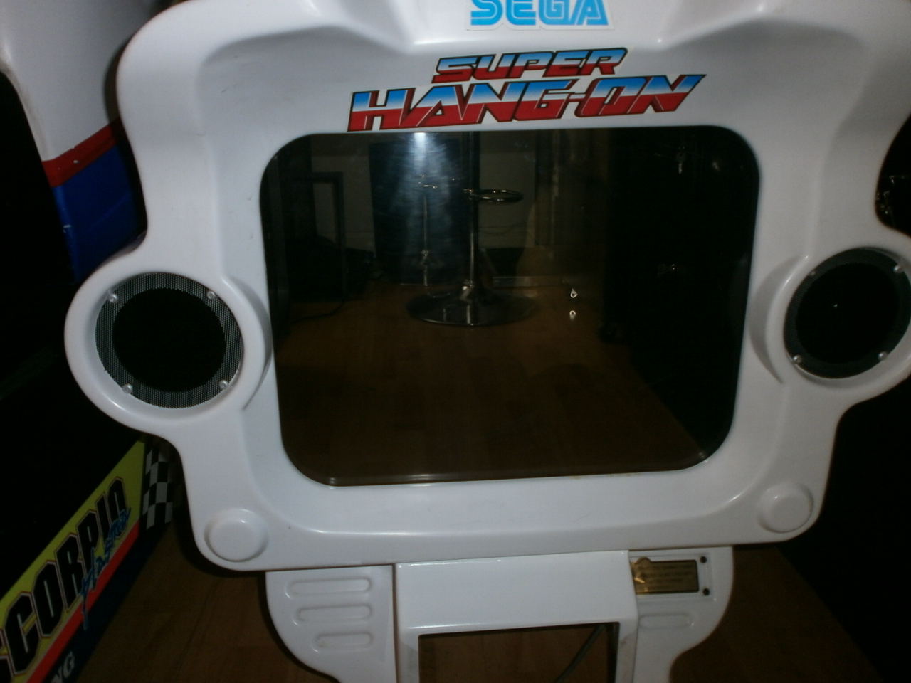

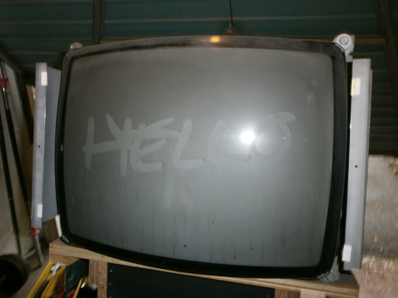

ok then so i taken the plastic hood off the cab to reveal a lovely wells gardner monitor i dont think this has been cleaned since it was new.im sur the picture will look a 100 times better after a clean, the clear plastic on the hood was just as bad too.

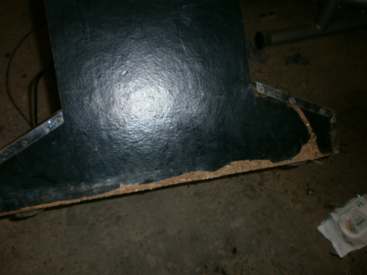

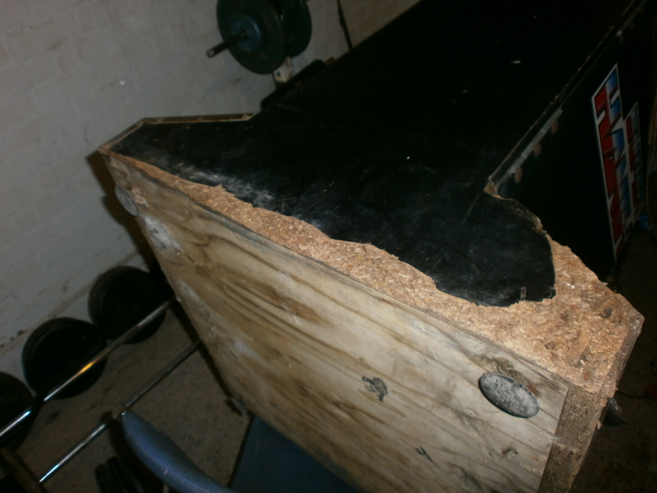

heres some pics of the base where it has been water damaged the sides are not to bad and the front just needs a bit of filler, as you can see the one corner has the most damage ive prepped the the base by removing any loose bits and and the painting with some pva glue , because its a water based glue i thinned it down so it would soak into the wood and give it some strength before i apply the filler
once its dried.
Ronnie Dent
1,205CR
Good start Paul, handy the base is plywood. Not sure how well the pva will work? I tried it on the side of a cab but it was still spongy, ended up cutting a bit out and patching a new piece in.
Ronnie

hey Ronnie I cut a lot of the spongy stuff out so im hoping once the glue dries it will be good to work with . we shall see :)

With the water damaged bits at the base of my cab, I pulled the rotting wood out and then used P38 to refill those sections.
I found an nice collection of dead woodlice. I like to think they were genuine 80s woodlice, but suspect they may have been more recent inhabitants.

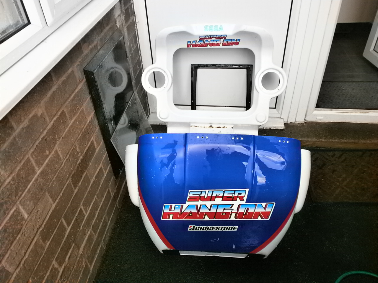

Ok a few more jobs done, in between letting the pva dry and filling and sanding of the base i started on the plastics .

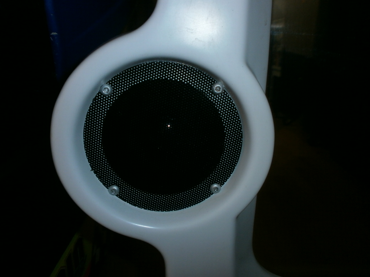

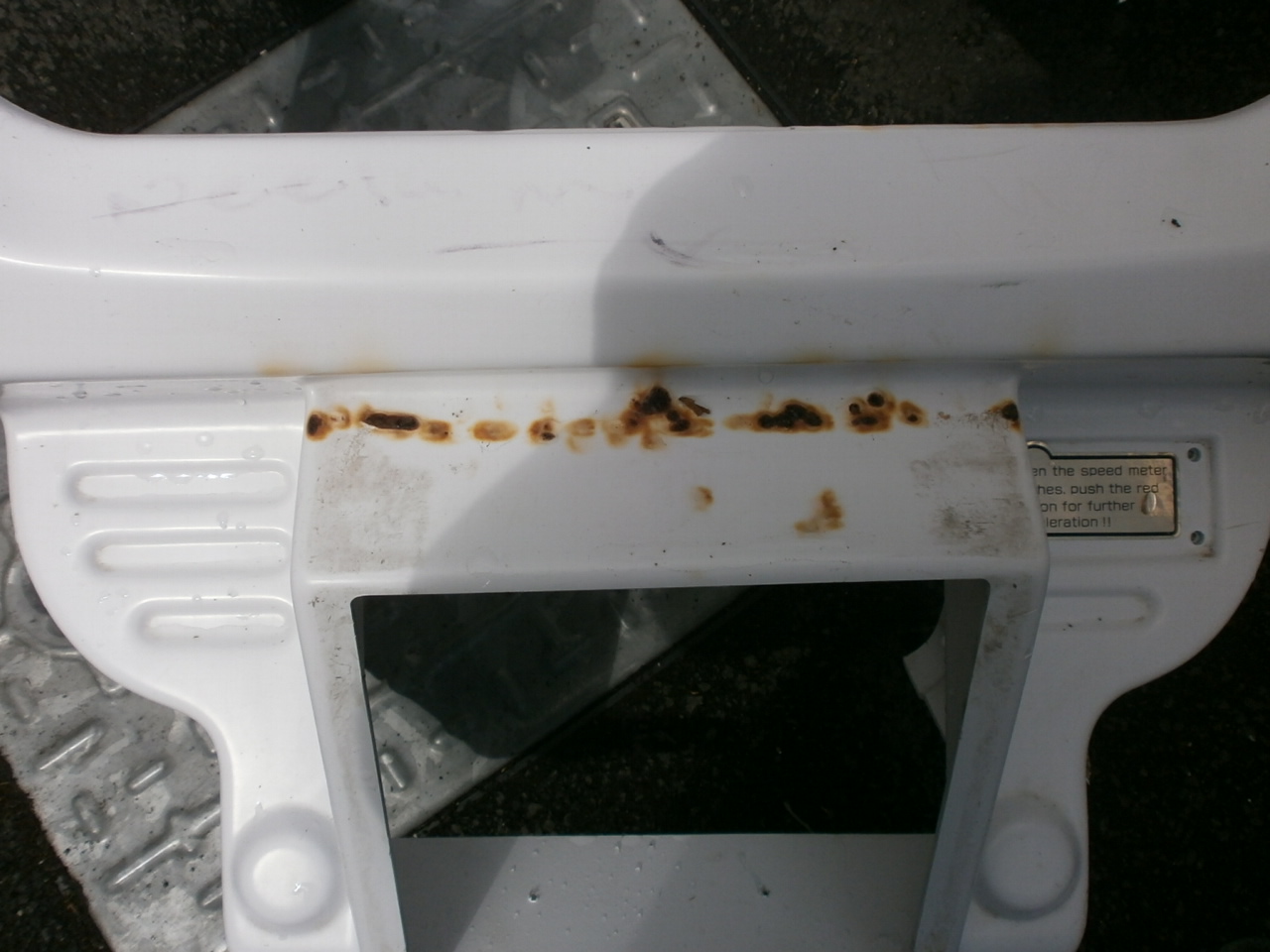

firstly taking the speakers out and plexi glass and then giving everything a good wash with some soapy water , i took all the rusty security bolts and speaker covers and soaked them in vinegar overnight ,it really does get rid of all the rust and paint and takes them back to metal, they were then given a coat of primer and black apart from the ones in the speaker grill that i did silver :)
then onto the ciggy burns on the front of the cab sanded down filled sanded again primes and a coat of gloss white , not perfect but looks loads better :) also got rid of alot of marks on the plastic using a magic eraser , i mad the mistake of buying cheap ones from china they are rubbish compared to a branded type so i will have to go over it again at a later date

cheers Ronnie it looks loads better, those ciggy burns looked terrible .I just need to glue back some of the stickers that have peeled a bit next, then when its back together give it another good clean and polish with some novus . job done mate :) on the plastics that is lol
