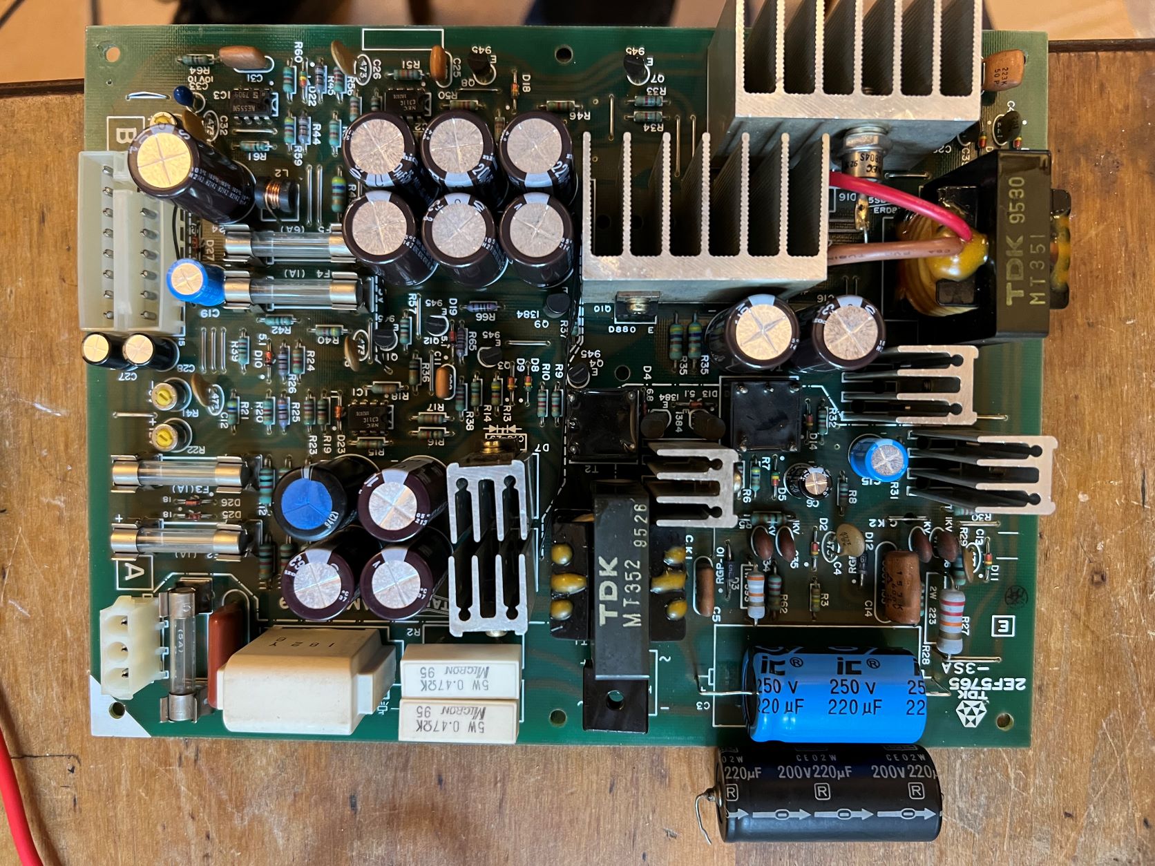

Here is a quick update from me. The table was more or less working well and I have been waiting on the legs being refinished and new CPO's from Olly so not even switched the thing on for a while.
I had an idea to see if I could get Space Invaders Part II roms working but for some reason, the game refuses to start so I have put that on the back burner for now and replaced the Part I roms which got it all back working again.
So, the next time I go to switch the game on, it was randomly crashing/hanging/resetting itself. I did some voltage measurements and it looks like the +5v has become a bit unstable, jumping around by 0.3 - 0.4v.
Whilst measuring, I had a bit of a disaster: I thought I would get some voltage readings with the board stack installed and in moving the board stack around, I managed to touch one of the long board stack support rails against the monitor board which blew the 1A fuse on the monitor board. I replaced the fuse and powered on again and it looks like this has caused some damage to other component(s) on the monitor board and the picture is now stretched somewhat so that Player 1 & 2 does not fit on the screen.
The monitor has never been recapped by the look of things so hopefully, Gunblade is going to take a look for me and hopefully sort that out.
Back to the power supply. It looks like this has never been touched either so yesterday, I replaced all the electrolytic caps. I say all, because I was short of one capacitor so I removed the remaining one and it tested in spec with my cheap component tester. I put it back in circuit till a replacement arrives. The +5v is just the same - still jumping around with a bit of ripple too.
The only other thing I did was to reflow some of the bigger pins like the connector header though everything looks fine under a magnifying glass anyway.
Here is a picture of my PSU board:
You can see the Cap with the blue top is the one I didn't replace. I also replaced the big axial cap (top left) but that one is the largest physical one I could find. I included the old axial cap in the picture for comparison. Is that going to cause problems or should I use a radial cap and run fly leads?
It is looking likely that the problem lies elsewhere so any pointers/suggestions as to where to look next would be very welcome.
Cheers, Mark
Clabs2022-08-26 20:14:44

A little bit off topic - but I'm looking for a connector for position 'B' on the PSU pictured above. Does anyone know what this kind of connector is named or where to purchse this?
By the way: I'm very impressed how clean this boardset is. It doesn't look like 40 year old...
When replacing capacitors of a switching power supply, make sure to use low ESR types only because of the repetitive high currents while charging / discharging. Using (cheaper) standard capacitors may cause problems in function or they may become faulty very soon.
And you also should have a look on the voltage capability of the capacitors. If you're using one with less voltage capability than the one that has to be replaced, you should double check this before using the schematics.

Hi ArcadePCB
I am pretty sure that connector is from the AMP Commercial mate-n-lok range. I don't know if this one is the correct one size-wise etc but it looks identical to mine. Hopefully this puts you on the right track:
https://www.arcadepartsandrepair.com/store/connectors-sockets-pins/amp-commercial-mate-n-lok-products-connectors/amp-16-pin-commercial-mate-n-lok-pcb-vertical-female-pin-header-cf1016/
Thanks for the info about the capacitors - appreciate it. I should have mentioned in my previous post, but whenever I replace capacitors, I always try to go for Nichicon wherever possible as they seem to be highly regarded. I always always try to up the voltage and temp rating too. The only one that gave me a problem this time was the big axial cap - Nichicon don't seem to do anything that big.
I actually found the last missing electrolytic so I popped that in this afternoon but that has made no difference.
What I have found though over the last couple of days is if I switch the machine on first thing in the morning when it is cooler, it boots up straight away. It runs for about 20 mins or so then starts rebooting. I will have to dig out my can of freeze spray and see if that helps narrow down where the problem is.

For the reset problem: I would try to watch the reset line first. If possible, using an oscilloscope (helpful for detecting glitches etc.), but for the first step a multimeter should do the job, too. I would check the level on the reset line first when just powered on and monitor this until the machine resets. Once directely measured at the reset pin of the CPU and once again at the reset output of the power supply. Is there any drifting towards the threshold level visible? Is there a difference between these two test points? Maybe it's just a bad connection. What's the condition of the CPU socket? Nice and shiny or black / corroded? What's the condition of the solder juctions at the CPU socket? Just a few ideas where I would look at first.
Because the reset circuit is on the power supply, the problem can be either there or on the main board.

I already addressed all of the points you highlighted but I do know that unstable voltages are a no-no. Luckily, a power supply came up on fleabay so I bought that. It is grubby and a bit rusty but the voltages are all spot on. I installed it yesterday and I am back up and running again. I was so worried I may have damaged something on one of the boards, so that is a relief.
I would really like to get the original power supply working again but still don't seem to be able to get to the bottom of the unstable +5. I did a lot of google searching and found everything but fluctuating +5v. In view of that, its probably best if I start a new thread as it might be easier for anyone else with the same problem, to find in the future.

That is a good shout about the the 5v pot and it had crossed my mind as I have read quite a few threads where those pots have become unstable. I did already give it a good few quirts of switch cleaner and turned it back and forth lots of times to try and clean the track but it made no difference. I thought the best way to check it definitively was to swap it out with the one from the working board. No difference.
I have to say that I am so glad I bought this Hakko desoldeing gun. It makes jobs like this so quick and easy and puts the minimal amount of stress on the PCB/components you are working on.
I will keep looking!
It's the ripple current you want to look at, not ESR. ANY cap produced today is going to have infinitely better ESR than the ones in the pcbs 40 years ago. Plus it's not a SMPS.
