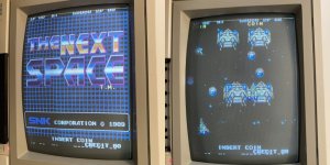

New 24Mhz crystals arrived, swapped out ......
And Voila !!!!
Looking good! just have a dashed line along the bottom of the screen and a dotted line across the top.. Doubt that is supposed to be there

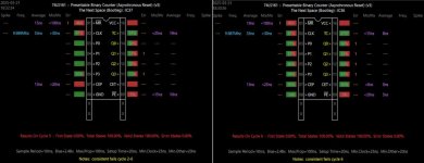

And what is really interesting is when you look at the data from the Slice for those 2 LS161 chips .....
(IC 37 is the first counter, IC36 the second counter in the sequence)
I remember I ran the test repeatedly on these chips (because it felt like they 'only just' failed) and they always failed after between 2-6 cycles. But generally IC37 (first counter) failed earlier in the test than IC36 (second counter) - so is IC37 bad and carrying the counting error to IC36 .... But the really interesting thing is if you look at the fail number on the outputs -it was always 1, and on the /MR (master reset) always 1 .... can't be a coincidence surely .. the game seem to be drawing the picture with 1 pixel 'wraparound' on the screen, and these 2 chips, very likely horizontal counters, failing with 1 error every time ... hmmm.

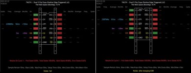

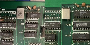

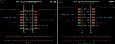

So moved away from that area and had a look back at a couple of the other original chips which failed slice testing and there are 2 LS74 chips at IC74 and IC89 which failed. They are under a bank of 3 LS161's at the top of the board, IC89 had errors in the 4 thousands on the outputs so while I had the time and the soldering gear out I whipped out IC89 and replaced it. Hasn't fixed the error and still getting fails on the outputs but lower numbers now ....
Looked at the other nearby failed LS74 at IC74 and this also now has some differences since the first time sliced .. (haven't changed this chip though)
fail numbers are lower, but also have the opposite signals on the Q2 outputs, I presume because now D2 is no longer floating (maybe due to the repaired trace). But then that side of the flip flop is maybe not being used as there is no clock input on pin11, so those outputs are maybe redundant.
Not sure this chip is faulty, the fact IC89 was showing similar fails but was not at fault makes me think this chip is the same.
