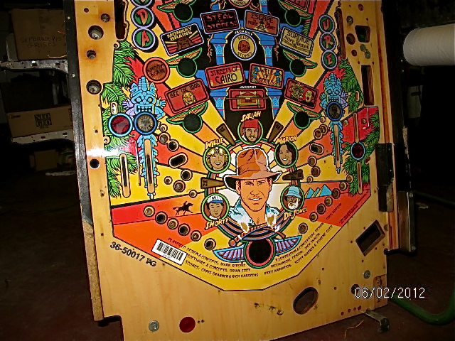

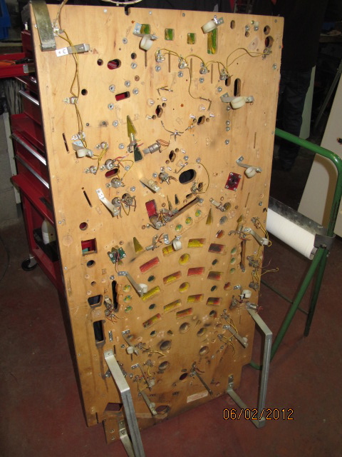

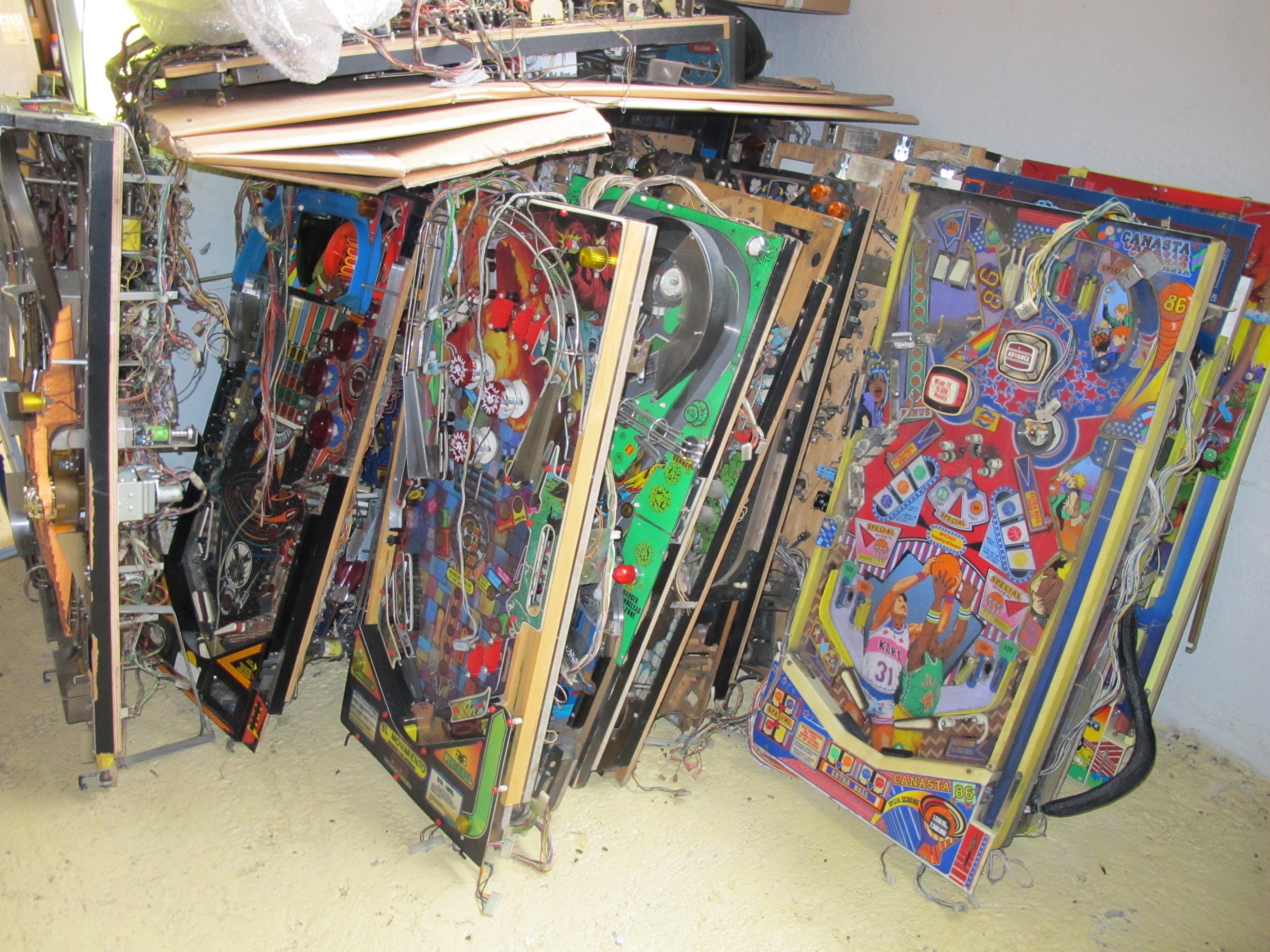

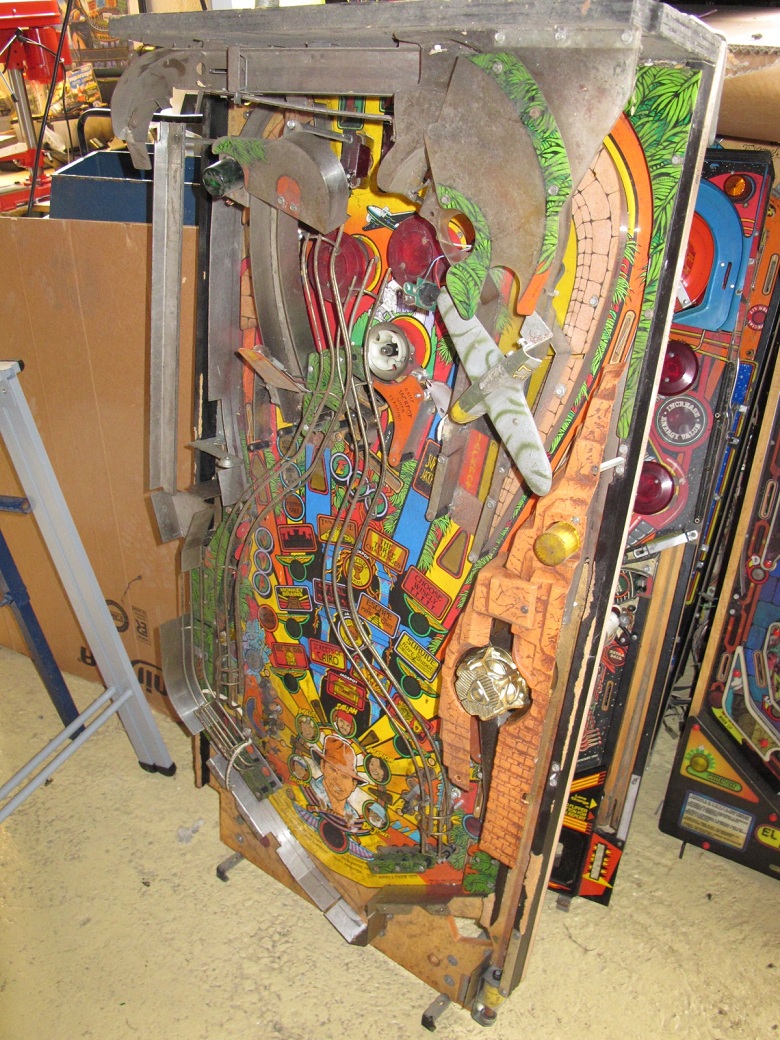

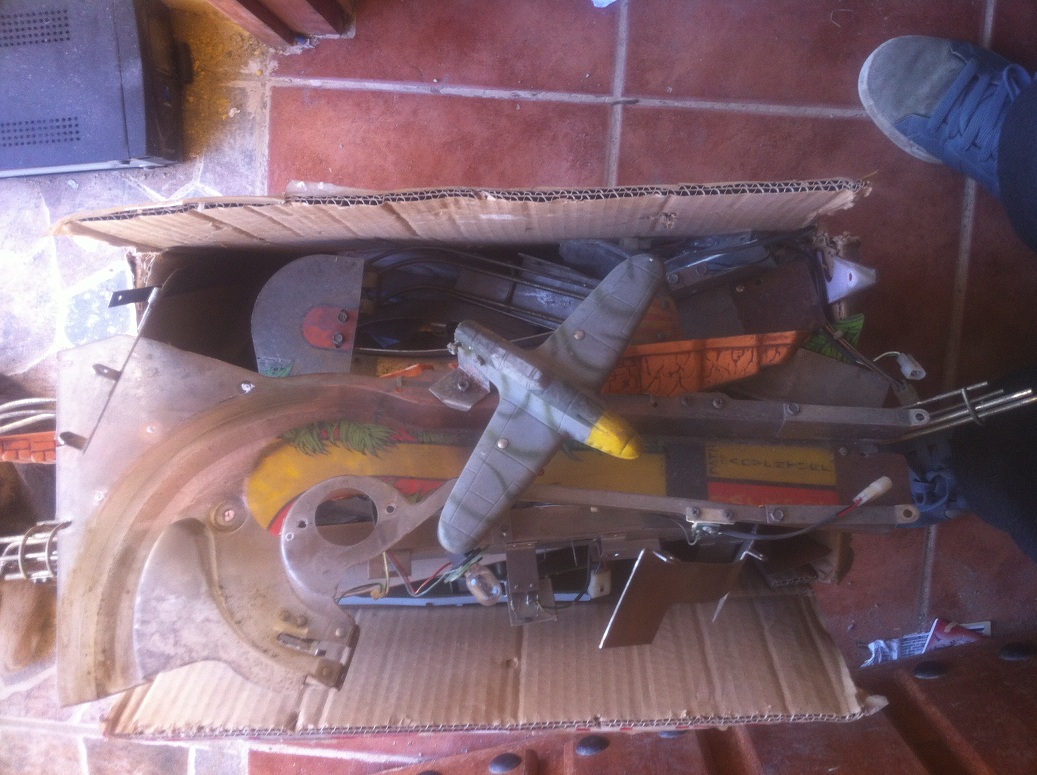

Second playfield
Thanks to some other members I was alerted to a playfield that had some of the missing parts and mechanisms on it that mine needed.
Here's the initial pix, can you spot the playfield?
So here's a better pic

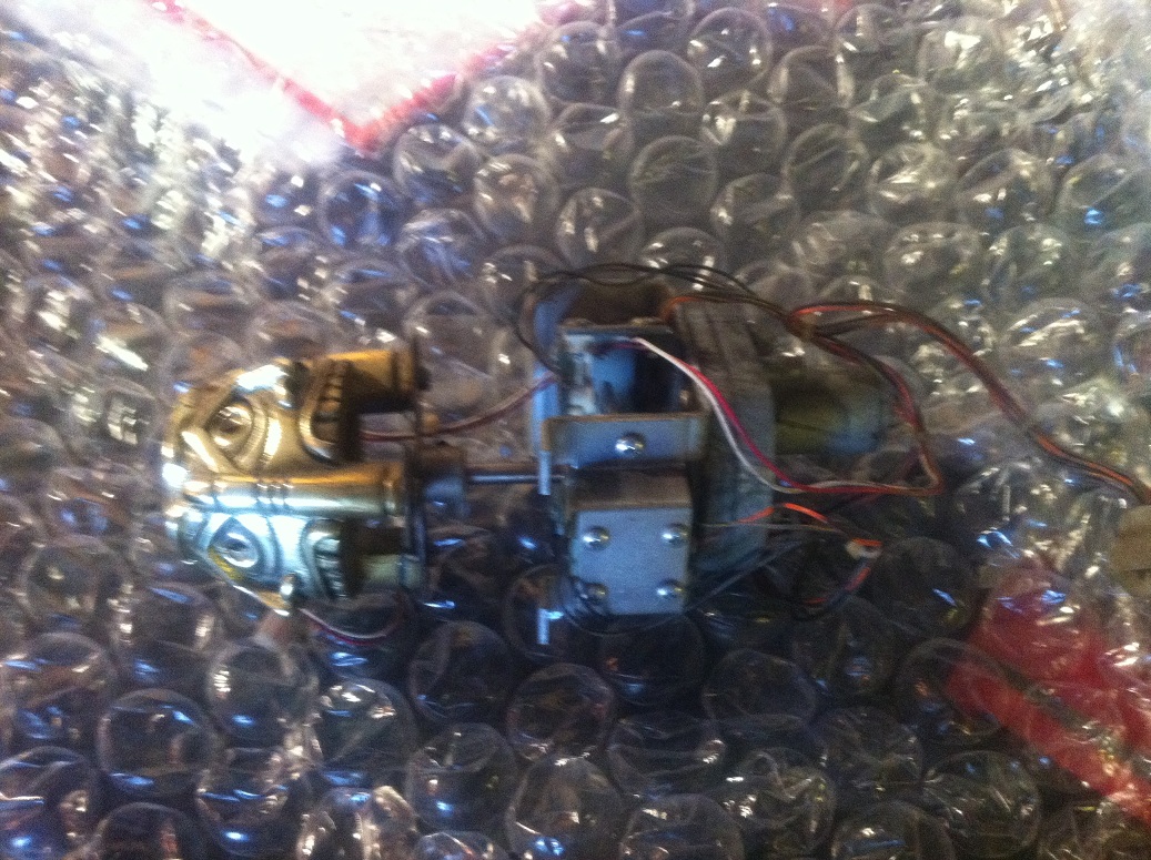

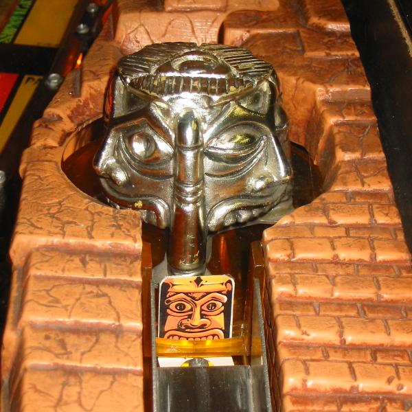

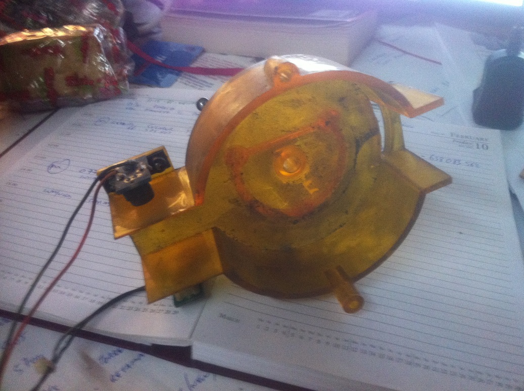

The biggest win here is the IDOL mechanism, for those that don't know what this is it is this:
It is pretty much IMPOSSIBLE to find!
So a deal was struck to buy the spare playfield off the Op, the only big issue was the actual playfield had wear near Indys head. So I struck a deal to take all the parts and leave the actual playfield behind (was loads cheaper, the guy wanted loads for the actual playfield but not a lot for the parts!)
Pix after stripping (you can see the wear here by Indys head):
Stripped!! Should have taken those arm rails though - much nicer than mine!

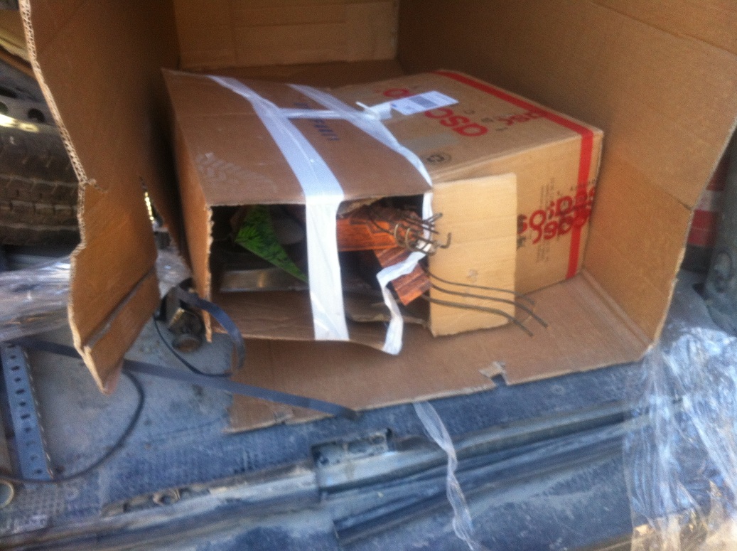

Some random shots of the parts taken off the second playfield
These are old pix, i'll update with newer ones soon.
Updates coming. Stay tuned.

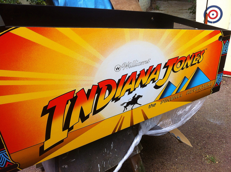

So that means I need for a proper restoration, a good quality set of artwork. Now there is a silk screened run of Williams IJ art - but it had ceased production ages ago and all I could find was horrible inkjet stuff! Doh.
Anyhow after 2 months of searching Andy Heighway of Heighway Pinball found a spare set he had and I grabbed it.
Here's the proper silk screened stuff:
w00t!

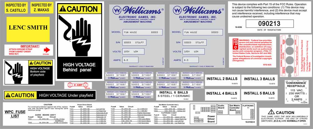

But then I started thinking about all the serial stickers around the cabinet that will be lost. So I used a service in the USA that reprints all your serial stickers and other associated pinball stickers out for you. You just provide your original details like US/UK/Export and serial number.
Here's an example:
So I supplied all the details and have a set on order!
w00t!

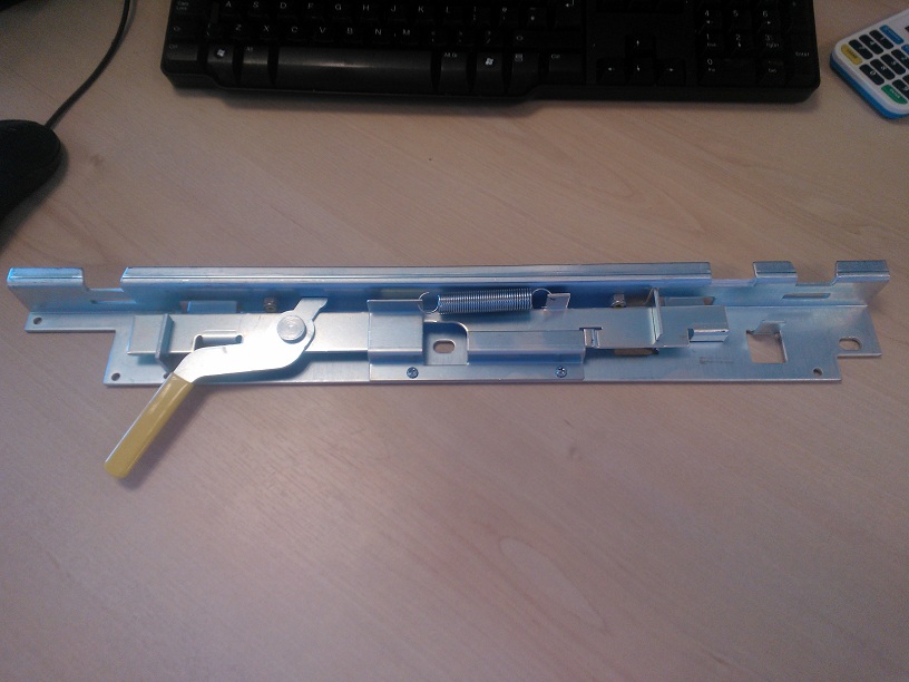

I've also managed to source a NOS lockdown bar assembly. This is coming in from Australia, I believe that's where the guy that bought all the Williams/Bally pinball stock lives.

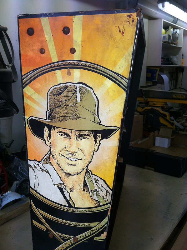

Right so I haven't got time to restore the cabinet myself so i've decided to outsource. This ensures it gets done really well and I know this person produces outstanding work. His name is Manny and his website is www.woodtechworkshop.co.uk
Here's a link to some of his work on flickr:
http://www.flickr.com/photos/woodtechworkshop/sets
Here's an IJ cabinet that has been restored - i've asked for the exact same finish.
My cabinet has been sent off and is having this done and I should be getting it back the first week or two of September.

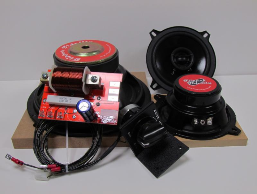

Here's a pic of the Flipper Fidelity speaker kit i've ordered. This is coming from the USA (airfreight though! I am impatient

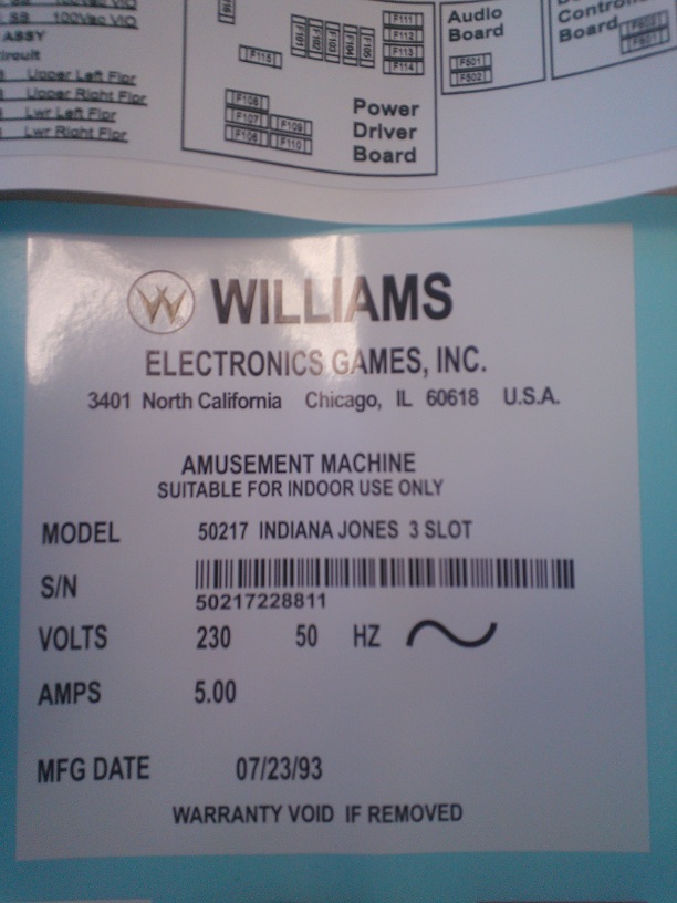

Popped home for lunch to find these goodies waiting for me..
First up the serial stickers have arrived!
Compare the old:
With the new:
Secondly the lockdown assembly arrived also. It is minty fresh!

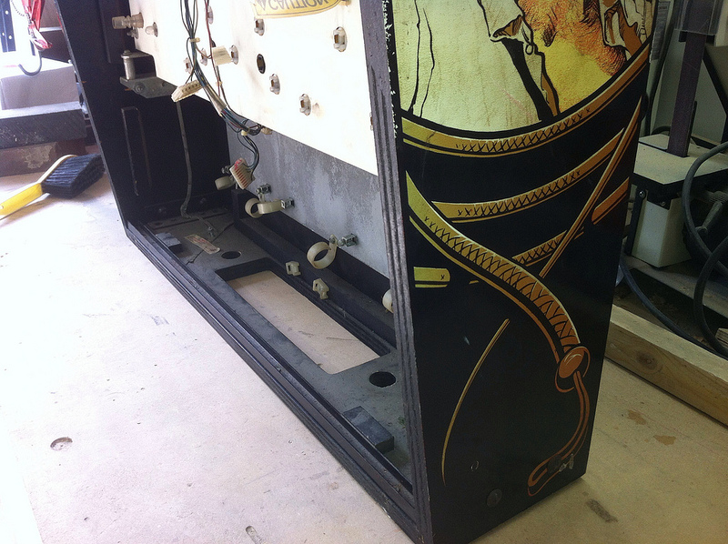

Update!

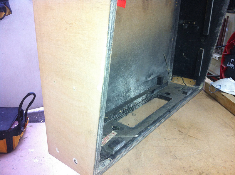

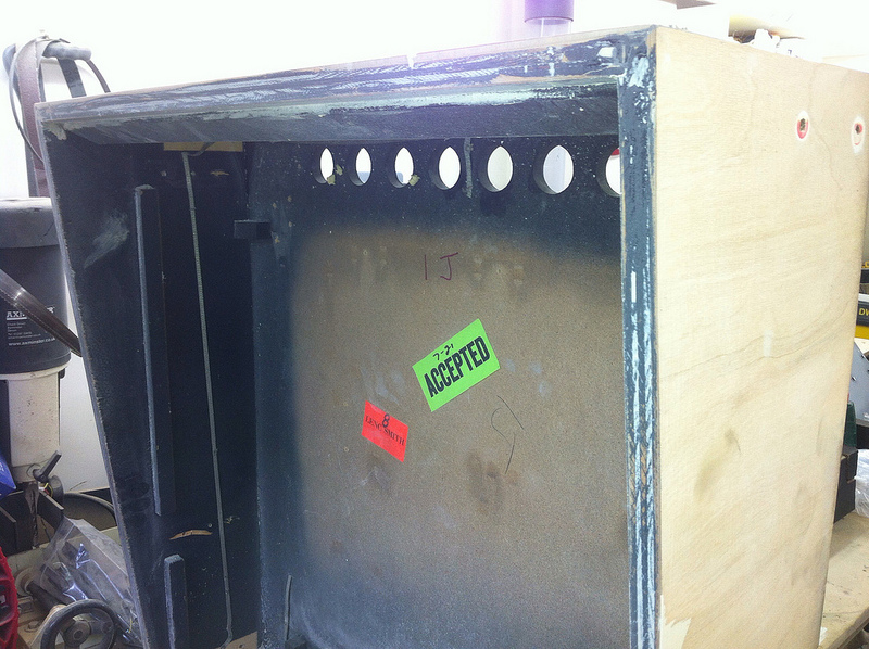

So work has started on the cabinet restoration yesterday. Here's some sneak preview pix of the head from Manny at WorkTech Workshop.
As you can see the head has been stripped and is being prepped ready for mintyness!
