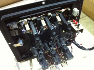

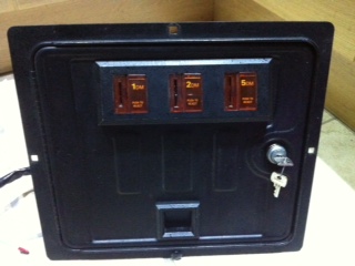

Well i've been considering the chrome coin door as you know as I think it looks pretty ace, and the black door I didn't think went to well with the Indy art work.
But I have been baulking at the price of those chrome coin doors, they are $449 plus shipping! add to that the fact they are only 2 coin slot versions AND they are only chromed on one side!... I can't justify it.. I thought this was unfair to my pin as the serial sticker explicitly states she is a 3 slot! She needs to be a 3 slot dammit!!
Gah. What to do.
Well Manny at WoodTECH came up trumps with a really NICE and complete 3 slot door. My one is in absolutely horrible condition with holes through the actual door due to hole punched plates that have been put on.
Most of the internals of the door are also missing and the harness has been cut. So I knew I needed to get another door, as that would be cheaper than sourcing the parts and fixing the dents and holes.
Anyhow he sent me pix yesterday of this:
Woohoo!!
So my thinking is:
1. Buy this door! It's lovely and complete!
2. Chrome it!

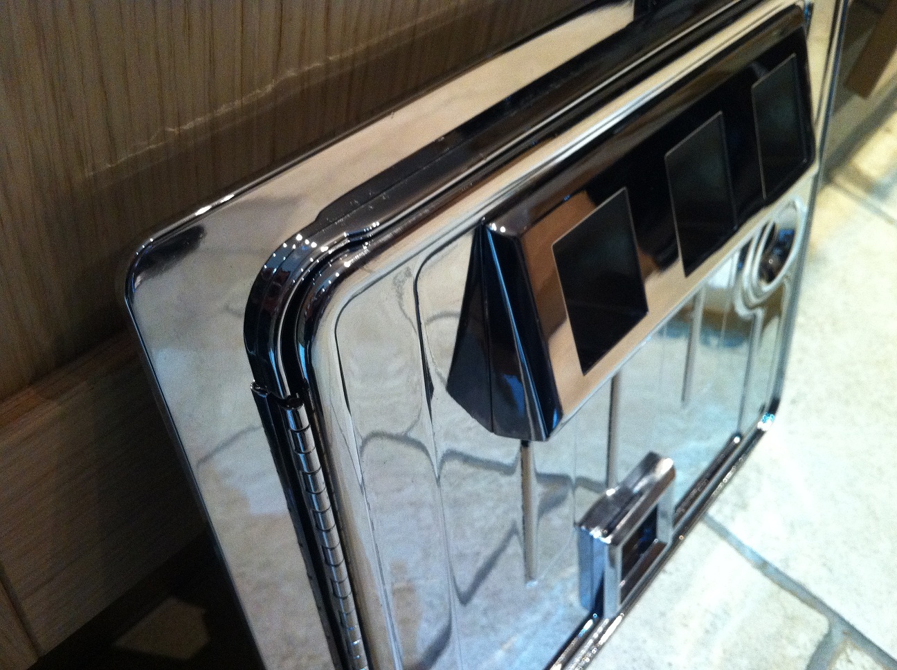

Anyhow Manny then came back and showed me this pic...
This is a 3 slot coin door he restored and chromed and mirrorpolished...
HOLY sh*t I NEED THAT DONE!
So Manny was the solution, the above coin door is now having the above done to it! Result!
3 Slot chromed goodness here we come

The coin door looks nice in black but i think i'd have to chrome it.....been toying with the idea of chroming my MC coin door as it's an Irish cab with a silver coin door anyhow.
May even chrome my house front door also!
Nice update....keep 'em comin' horse!!
