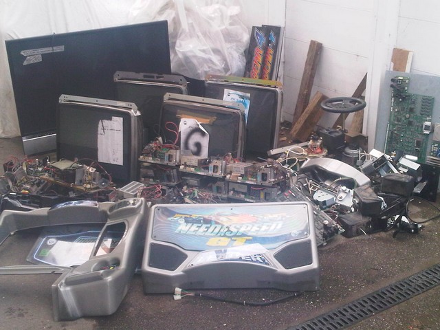

Ok, so I finally got everything into one spot to take a picture (most of it was still in the car!
), just as it started to rain typically! How I got all that in a Mondeo Mk3 Estate i'll never know!
Outrun2
Colonel Outrun
1,141CR
I remember the huge rear projection screen going in, but didn't realise you followed it up with four CRT monitors!! Amazing job fitting all that in, not to mention stripping down those cabs with the light fading fast in the first place..
..we have a raid Tetris winner!
