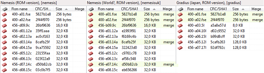

what? Why is the gradius pcb (non bubble) so expensive?? Is the nemesis (european) more common than the original gradius?
hmm wonder if its a simple romswap? (guess not, since its so expensive...)?
Original gradius rom version has fewer and bigger roms.. so the pcb might differ.
Strange.. why would they do like that?

It would be interested to see if you can put the Japanese Gradius rom set on to a Nemesis PCB, someone like DaveSpicer might be able to compare (are they both in MAME?) and see.
That would be a great mod!
Calling Dave Spicer to the thread!!
cmonkey
1,658CR
The memory map for the two games is completely different, thus making it an extensive code rewrite if you wanted to run Nemesis (GX400 hardware) on Gradius (GX456 hardware), or vice versa. Even then it may not be possible.

The bulk of the hardware is functionally identical and would be easy to retarget. Big gotcha is the RAM space which IIRC is larger on the GX456. Running Gradius on Nemesis hardware is very dependant on the extra space not being needed.
