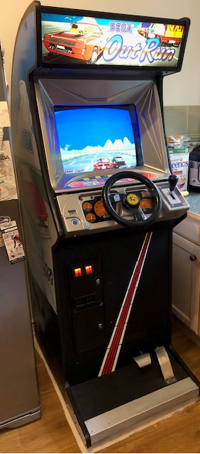

Just got a Deluxe this week. Plan on doing a full restore. She needs a bit of work to get into a proper working state. PCB has graphical glitch issues and the monitor is very dim. Not steering full right either.
The castor wheels and leg levellers need to be replaced as they are either flat or bent. Would anyone happen to know part numbers or suitable replacements? I can't see them listed in the deluxe owners manual.

The Steering on the DLX should be an easy fix at least.
Start with a 5K pot adjustment while it is on the test screen.
Your going to need some serious wheels to hold it up.
Much work to do, but so very worth it.
That's a lovely clean upright you have there sicoe.
I see those Springs have bought that Steering nicely into line,
but worth checking the arm plate are not bent (as so many are)
and are sitting flat on the arm bar.
Don't forget to lube the base to keep it sliding around cleanly.
