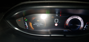

Well where do I start !!!! I had owned the for around 5 months and was ok apart from once when it stopped (Stop / Start) at a set of lights and then would not restart, After a few tried myself it started and for a few weeks it seemed ok but I was a little nervous when I went start stop kicked in (Be honest it hardly worked anyway , never worked most of the time). Then on my way to work I got this :-
I took this to a friend who owns a garage but his machine would not give him the error codes so he suggested I take it to an approved Peugeot garage , So thats what I did , Took it to the local Stoneacre (Start of my mistake !). To speed things up I have listed exactly what they did to the car and the approx cost below, all had the exact same error on the dash. This happened over around a 6 month period (Error occurred after around 3 - 4 weeks after they reset it) :-
1) Dec 2022 - Emissions Fault - Told the 'ECU' needed a software update as this issue was known and if not updated it can ruin the injector. This was free of charge !!
2) Jan 2023 - Same again - Told the car needed a new Injector and Adblue tank - Cost £1900
3) Late Feb 2023 - Same error - They had the car for week , Then told it just needed resetting - No charge
4)Late March 2023 - Same error - Told its a different fault , Told them ' Bullshit '. They had the car and then presented me with a bill for 4 x Diesel Injectors & A NOX Sensor. Cost £2600.
*** At this point I was considering getting rid of the car and started to look at new ones ***
5)April 2024 - Same error - Car went back into them and then said they need to pressure test and were waiting for new the tester. Car was with them for 4 - 5 weeks why they waited as the car was prety much undrivable as the ' Start impossible' could not be reset (Also bullshit). Had a call to say that the CAT needed replacing , again the cost = £1800.
After this the car was fine , I questioned them all the way through telling them that A - The ECU wrecked the tank so why was I paying ??? B - The work they had done Prior to the DPF was unnecessary. As a gesture of good will they gave me a free service !!!!!! Approx cost = £6300, Well worth the service !
I am unsure why I got rid as there was nothing else could go wrong !! Everything had been replaced. I truely believe that all the issues were the cat so in my opinion it should have been diagnosed correctly and I would have been charged £1800. But what can you do ????
Ah, the Adblue system failure.
That went on my workmates 208 (I think) and after the first big £1800 bill didn't sort it we just told her to get shot of it. Was a lot lower mileage than the 100k yours had too. With dealers only using official, brand-new parts and no intention of any illegal bypassing stuff, it can easily become a nightmare.
That and DPF failures are one of the big drawbacks to diesel car reliability (as I said in the other thread, we killed a DPF on our S-MAX in 17000 miles using it around the doors - £2000 under warranty, but it'll almost certainly go again in a year or two).
