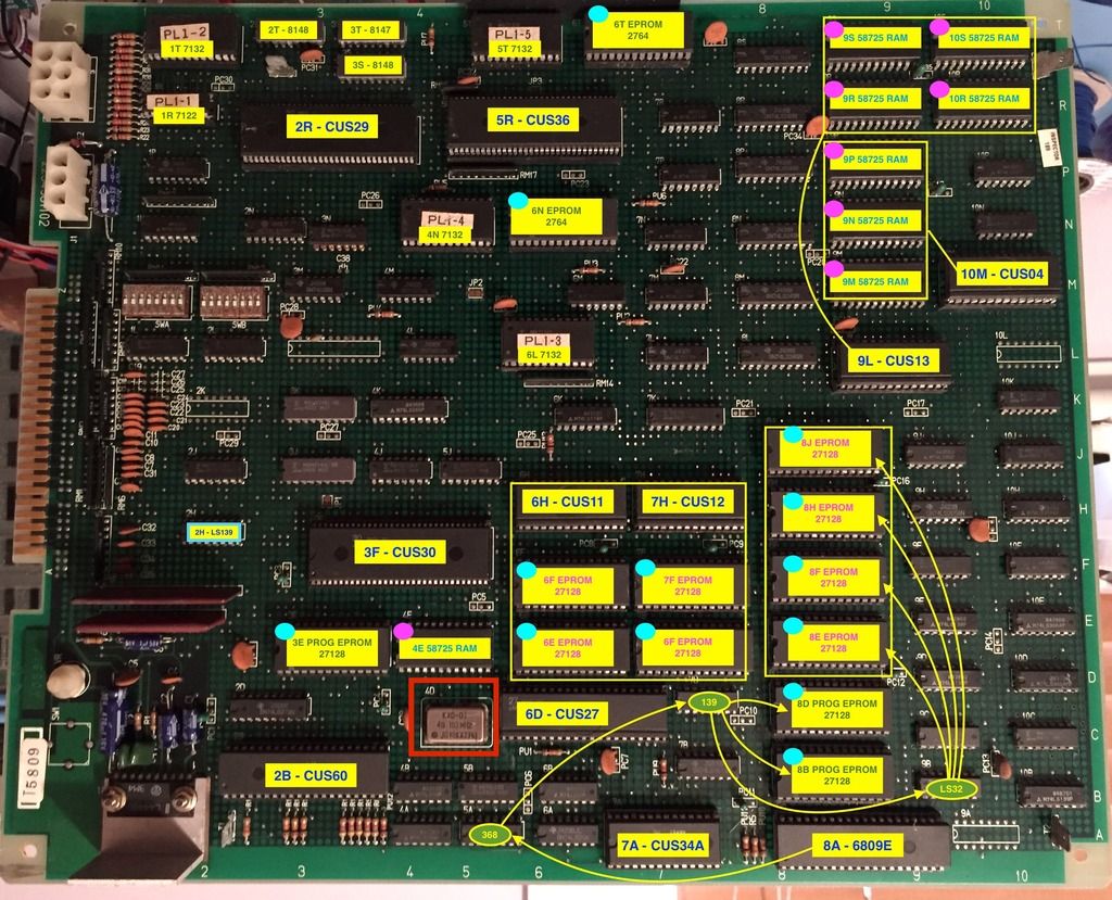

Hey Paul, I've started to look at a Pac-land PCB which is 6809E. How hard would it be to add support (even partial support) for that board? There's 8x 6116 RAMs and 13x 27128 EPROMs to exercise.

Since this is a 6809E you'll need to find the first clock stage so you can use clock mastering. Typically it's a 74xx04 somewhere new the crystal (if it has a crystal) or near to the oscillator IC (if it uses one of those).
You'll need to remove the IC and socket so you can replace that clock with one from the tester. Then it's a matter of adding in the game description.

Thanks Paul, there's an oscillator at 4D (see red square on pic). You want me to socket it and when I hook up the Arduino I should remove it and have the arduino run the clock signal? Is there a wire I need to run to the socket or is it all done through the ICT header?

1,117CR
That is an oscillator - to be sure it's the right one MAME usually carries and indication of the processor speed that should be some divisor of that. For example, in the MAME driver, "pacland.cpp" (from the MAME source code package), this line shows which oscillator applies to the 6809E:
MCFG_CPU_ADD("maincpu", M6809, XTAL_49_152MHz/32) /* 1.536 MHz */
Also in that file you'll see the memory map for the ROMS, RAMS & IO addresses etc. A similar format is used in the game descriptions in the tester software.
Because the oscillator is awkward to remove due to the hidden pins and is rare to replace, it's usually easier to find the IC that the clock out is connected to nearby and cut that out instead. If you're lucky, it might go to a custom that's already in a socket. Bend out the clock input pin on the IC and attach it to a fly lead from the aux connector on the ICT shield (same as Star Wars, J14 AUX pin 8 (next to the 2-pin GND pin)).
