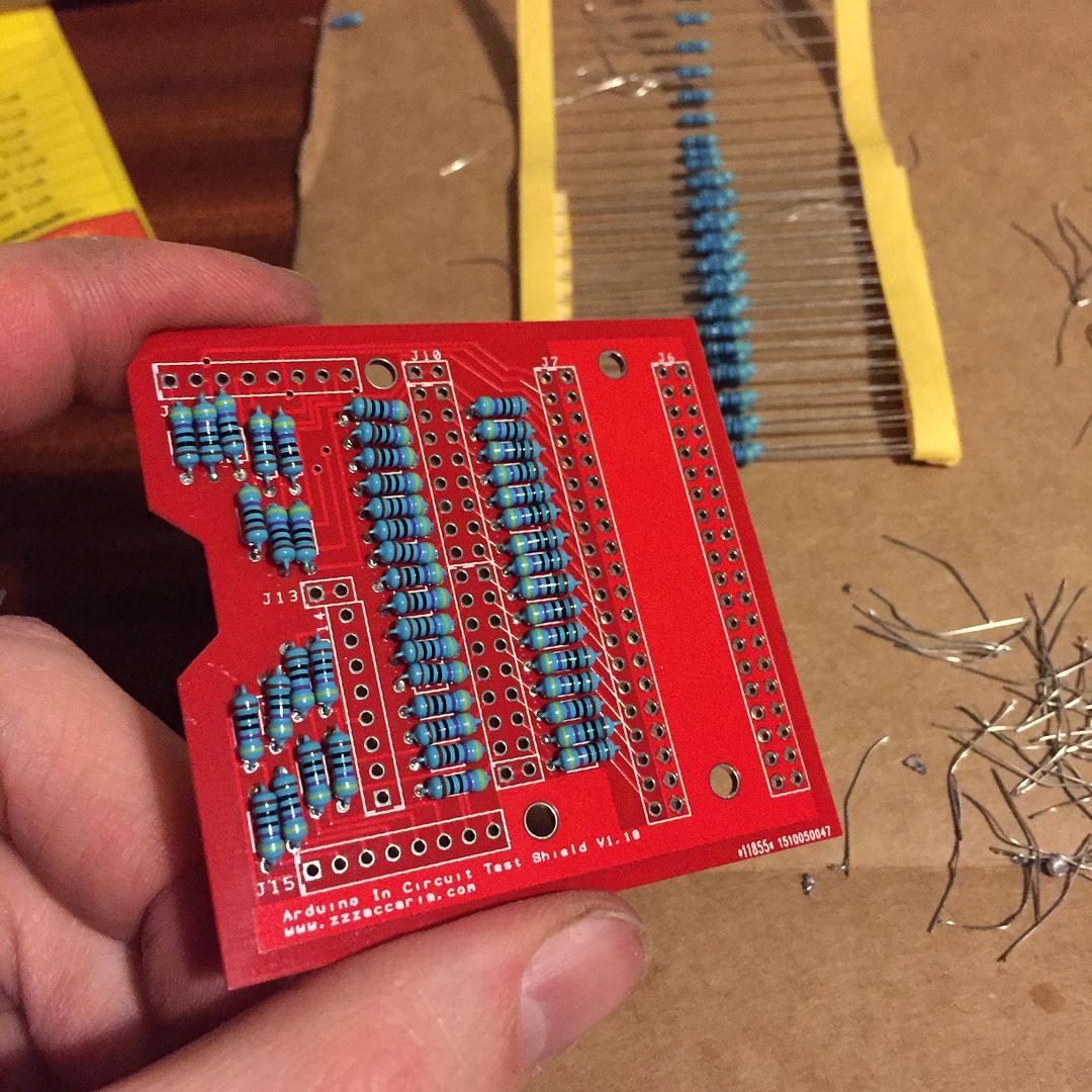

One helpful trick I used for mine was to get a pair of nail clippers and use them to clip off the bottom of the resistor legs once soldered in - means you can remove any excess leg and solder and keep them all well away from each other

@Phill - check the resistors up in the top left near your forefinger, they look like they're overhanging where you're going to need to put the pin headers.

Hey Paul, after fitting the shield into the arduino alongside the lcd I think there's a small change you can make to the pcb layout to make the fit more snug. I found that the resistors in the top left (see my last photo) were about one resistor's width too far left. This meant that the edge of the lcd shield sort of sat on the far left resistor. I managed to push the resistor's right a little but probably better to address it on the pcb layout itself. I'll get a better photo of the issue tonight.
