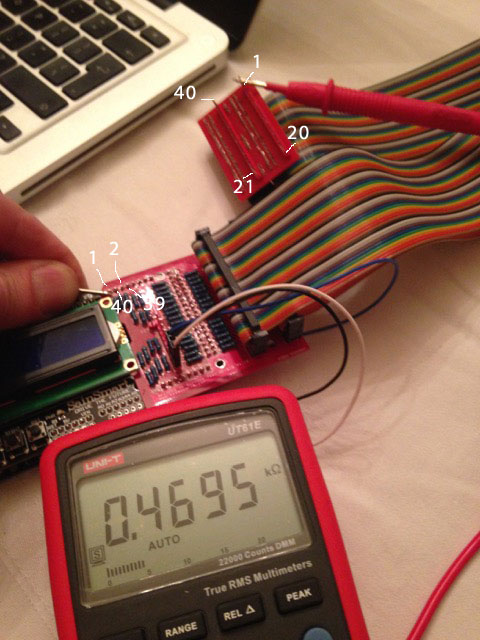

guddler said:
Regarding the cable. Bottom line is there's no real substitute for checking it with a meter.
When I say "beep" below, I mean 470 ohms (and mine reads around 420 Ohms - although the battery light is on in my meter)
Pin 1 on the CPU should beep out to pin 14 on the Arduino (top left of the shield as the keypad is the correct way up), pin 2, CPU = pin 16, Arduino. Pin 40 of the CPU = pin 15 of the Arduino, pin 39 of the CPU = pin 17 of the Arduino.
Just checking those 4 would be enough to make sure you are correctly orientated.

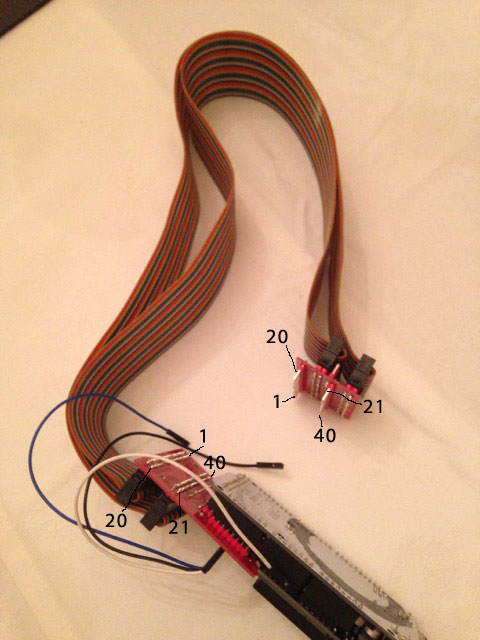

So I'm back from being away and metered mine out and my second setup of lead orientation is correct
Here's some labelled pictures for everyone else to reference
It's not that obvious on the CPU board, but Pin 1 is J2, top-left as you look at the top of the board and has a tiny '*' on the board just by the solder
Paul - maybe on a next revision it might be good to add pin numbers (*or I can add them if I can borrow the source board layout files)?
@Guddler - .4695 kOhms - spot on
Alex
