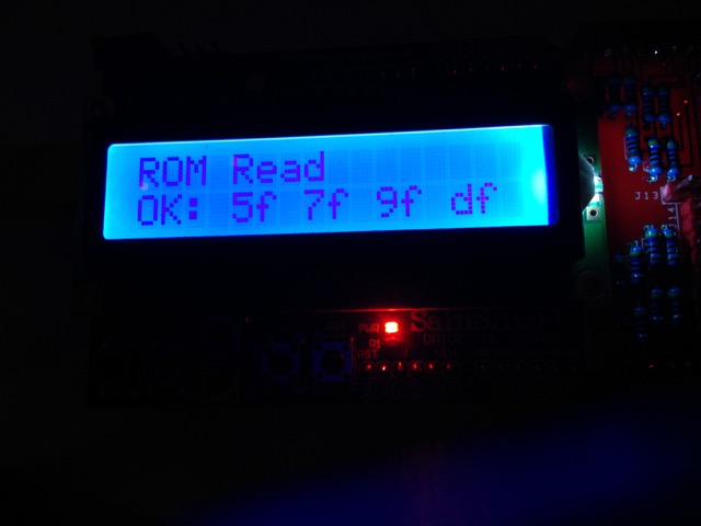

1. ROM Read

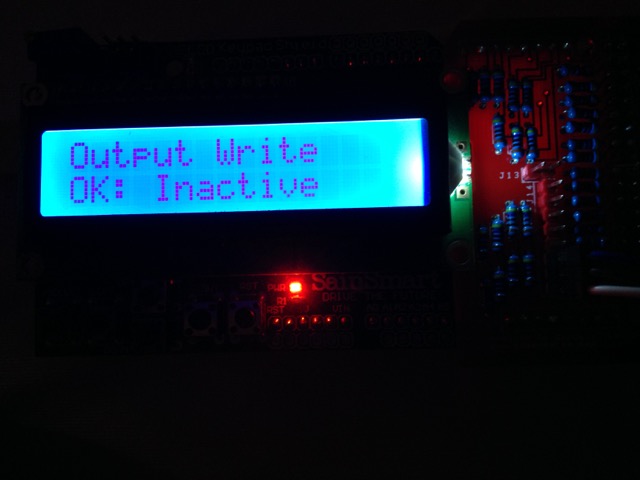

2. Output Write

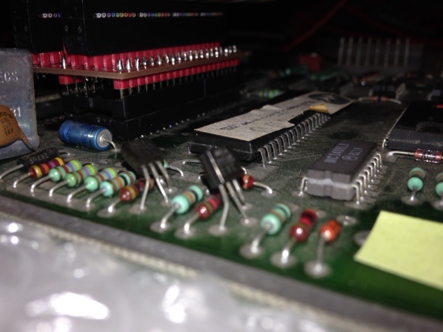

3. The rig

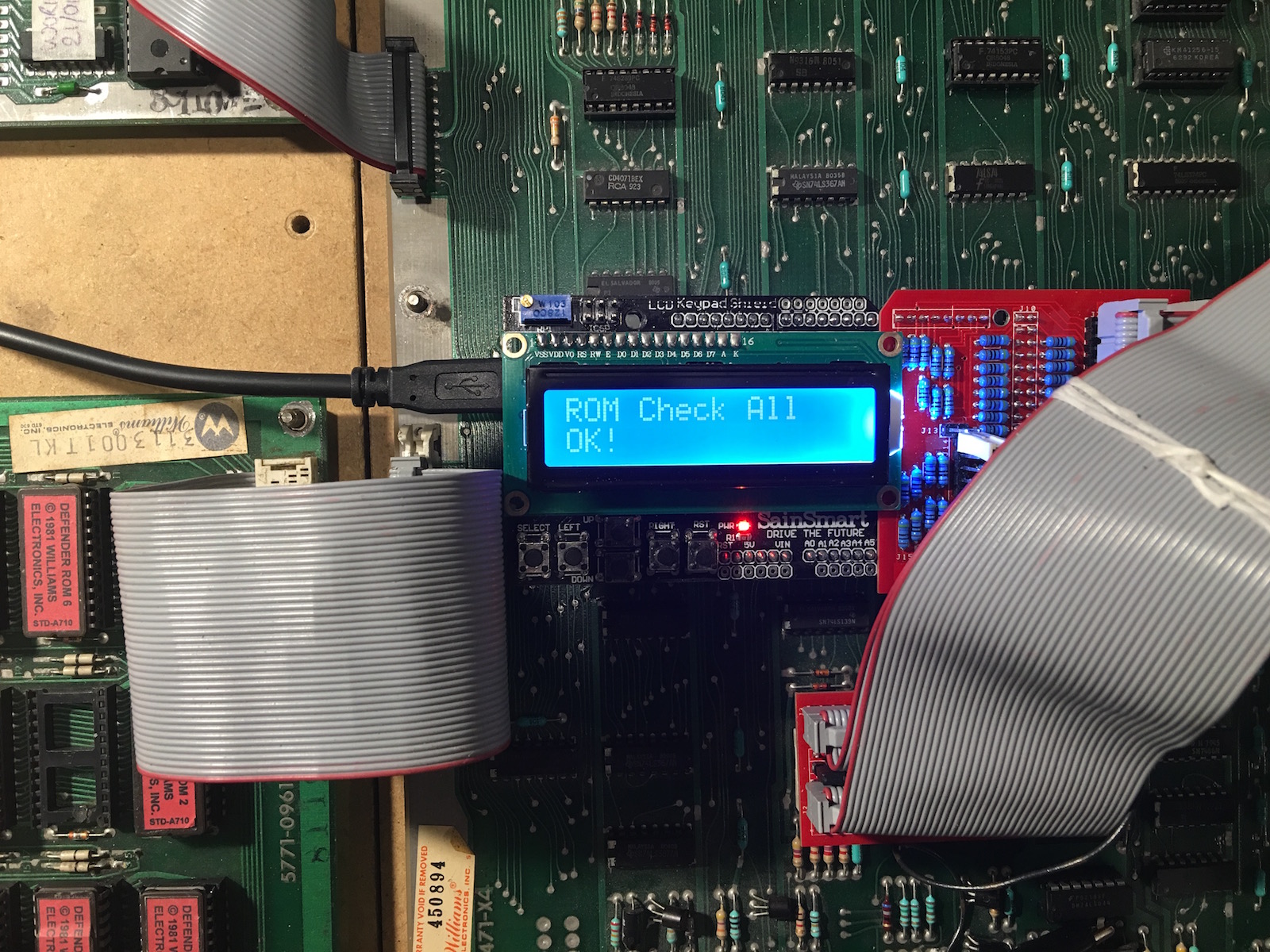

So I've been working on the Defender CPU/ROM/Interface board code again over the weekend.
I now have it working to the point I can test:
All the ROM (red only for now)
CMOS RAM
Inputs
Outputs
What I still need to do:
Interrupts generated by the ROM board PIA (Interface PIA Interrupts are not used)
DRAM
Custom routines as required (to start off one to cycle trough the sound outputs like the in game test does)

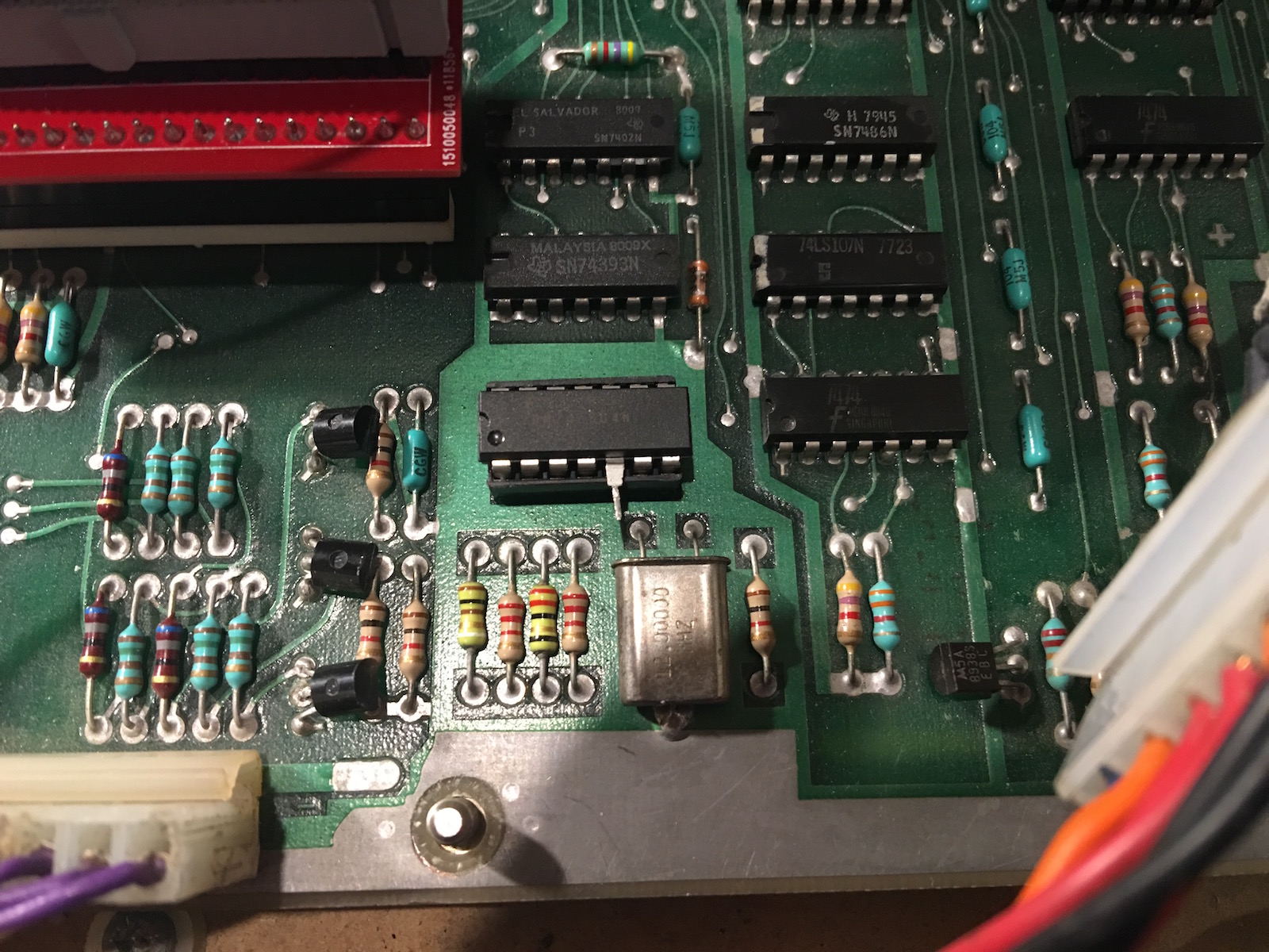

As I suspected the DRAM doesn't work out of the box.
I'm using an early series CPU here s to use the clock mastering I socketed 3B and the clock input goes to pin 5:
ROM Test results:

Judder
991CR
Hey Dave
Here some feedback on the soundboard testing code (and two sets of test results below)
Bus Idle, ROM Read All, RAM Write All AD, RAM Write All Lo, RAM Write All Hi, RAM Read All
All of these return OK even if the tester isn't correctly connected.
The most useful (from testing) are RAM Write-Read and ROM Check as these give definitive signature results

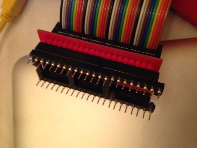

I originally had mine not connected properly as the pins on the test 'POD' are a bit too big for the CPU socket, so was getting false positives
To make things fit together, I fitted pin sockets (the 'turned' ones don't fit so I used the spring type ones) to the bottom of the test 'POD' so that the pins going into the Williams ROM socket are much thinner = successful results
@Paul - not sure what we can do about that with the use of the jumpering pins, but they are a bit too big for easy slot in / slot all different boards
Results of a Stargate and a Joust sound board - which I'm guessing is showing that the Stargate ROM is incorrect and needs to be replaced, but the RAM is good

One addition on the best way to adapt the jumper pins the POD is using to the CPU sockets of the motherboards being tested
I found that if you use a standard 'sprung' socket to connect to the legs on the jumper pins, these fits nice and tightly as the sprung socket can adapt to the wider size of the jumper pins
However the legs of the 'sprung' sockets are very weak as they are meant to be soldered to the boards, so I used a 'turned' socket next in line to provide stronger mounts - here's a quick picture
Works very nicely and reliably...

I didn't use the square pins on my CPU connectors, instead I use turned pin headers. Still using a sacrificial socket though.
Dave2084
453CR
Judder said:
Hey Dave
I did add check for power and busses to the memory tests, but commented them out to improve performance. I'll take a look.
Judder said:
Results of a Stargate and a Joust sound board - which I'm guessing is showing that the Stargate ROM is incorrect and needs to be replaced, but the RAM is good.
ROM Check f800 ff U12 = E:U12 f840 04 1b
Sort of ... the test is telling you that 0xf840 is 0x1b and should be 0x04.
In fact if you look at location 0x40 of the Stargate sound ROM you'll see that it is actually 0x1b. The reason? A typo in the constant set up for expected values. In the beginning I was typing these in manually and here's the result.
I have since written a PHP script to do it for me automatically on the command line of my Macbook as once you get to full games there are too many ROMs to do it like this.
To fix it for Stargate you need to change line 46 of CWilliamsSoundGame.php from:
static const UINT8 s_romData2nSet2_IC12[] = {0x0f,0x8e,0x7f,0x6f,0x6f,0x04,0x04,0x1b,0x5a,0x97,0x96};
to:
static const UINT8 s_romData2nSet2_IC12[] = {0x0f,0x8e,0x7f,0x6f,0x6f,0x04,0x1b,0xcb,0x5a,0x97,0x96};
as you can see I got 40 and 80 wrong here!
I'll run the script on all the sound ROMs and push the change to github tonight.
Dave20842016-02-16 12:50:05
