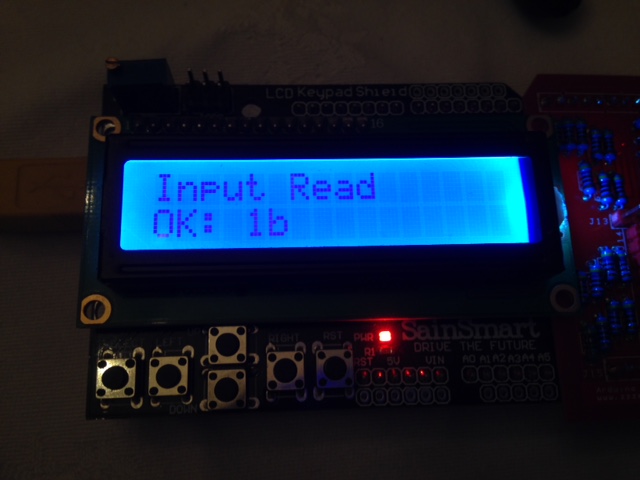

Also is the "Input Read" test checking IOJ3 Sound Select input (CB2, PB0, PB1 etc.)?
Input Read test is giving
U10 ff PB0-7 = 1f
but not totally sure how to interpret the results!

Actually answering my own question, the result of the test can be deduced from the table in CwmsSoundBaseGame.cpp
Grounding pin 5 = 11111011
x, PB7, PB4, PB5, PB2, PB3, PB0, PB1
as pin 1 isn't connected, so the result should be 1b, which it is :)
U10 ff PB0-7 = 1f
More source code comments:
Code:
// Input region - IC10 6821 PIA Inputs from ROM board (PB0-7)
// Sound board Inputs on 0x4000
//       4J3-1 - Key                                         0x01  PB0 - 4J3-3
// 0x02  4J3-2 - PB1                                         0x02  PB1 - 4J3-2
// 0x01  4J3-3 - PB0                                         0x04  PB2 - 4J3-5
// 0x08  4J3-4 - PB3                                         0x08  PB3 - 4J3-4
// 0x04  4J3-5 - PB2                                         0x10  PB4 - 4J3-7
// 0x20  4J3-6 - PB5 (W4 Installed & W9 Removed)             0x20  PB5 - 4J3-6 (W4) / DSW-2 (W9)
// 0x10  4J3-7 - PB4                                         0x40  PB6 - DSW-1
// 0x80  4J3-8 - PB7 (W12 Installed)                         0x80  PB7 - 4J3-8 (W12)
//       4J3-9 - No Connection
// 0x40  DSW-1 - PB6
// 0x20  DSW-2 - PB5 (W4 Removed & W9 Installed)

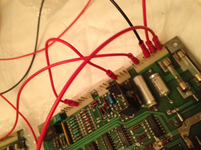

I'd probably add a little comment highlighting the grounding of an active PIA pin in the 1.5 second window to test.
It works great BTW
Also works great and testing on a Defender I get
9 8 7 6 5 4 3 2 1
N/C CB2 PB4 PB5 PB2 PB3 PB0 PB1 x
0 0 0 1 1 1 1 1 = 0x0f
0 0 1 0 1 1 1 1 = 0x1f
0 0 1 1 0 1 1 1 = 0x1b
0 0 1 1 1 0 1 1 = 0x17
0 0 1 1 1 1 0 1 = 0x1e
0 0 1 1 1 1 1 0 = 0x1d
which is correct as if we put them in binary sequence
PB5 PB4 PB3 PB2 PB1 PB0
0 1 1 1 1 1 = 0x1f
0 0 1 1 1 1 = 0x0f
0 1 0 1 1 1 = 0x17
0 1 1 0 1 1 = 0x1b
0 1 1 1 0 1 = 0x1d
0 1 1 1 1 0 = 0x1e

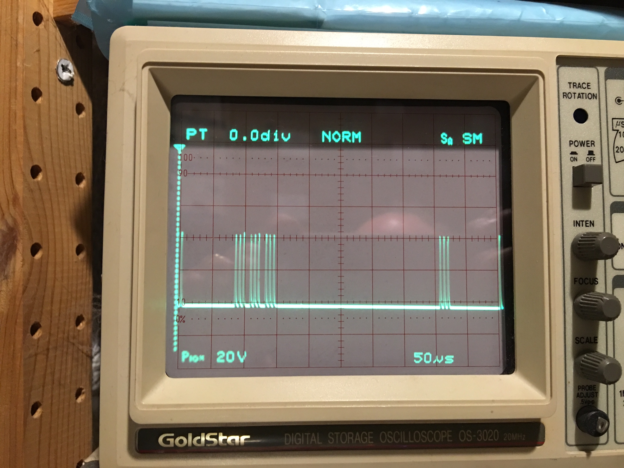

Looking at the /CAS and /RAS timing for the DRAM we're around 0.4ms which is just too slow, it also doesn't help that the clock pulses are bursted rather than constant. In fact looking at the photos below again now it seems they are both following the clock (note the scales are slightly different here). I'll have to examine some more ...
/CAS and /RAS at 100uS/Div
Clock Pulses at 50uS/Div
Dave20842016-02-21 19:21:10

Can you confirm what operation your scope traces represent? Read, write or write-read, for example?

Unfortunately, I can't run a read/write cycle as it falls over straight away and location 0x0000 so that is a read.

It would be useful to see a trace of the master clock versus RAS. If you are doing only reads then the long & short RAS traces seem unexpected. If anyone has a spare Defender board they're willing to send me I can take a look myself also.
