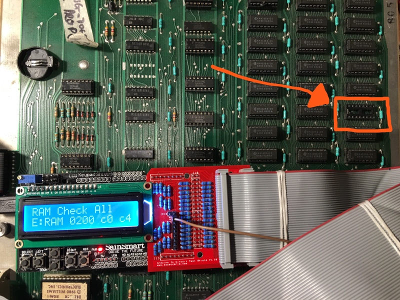

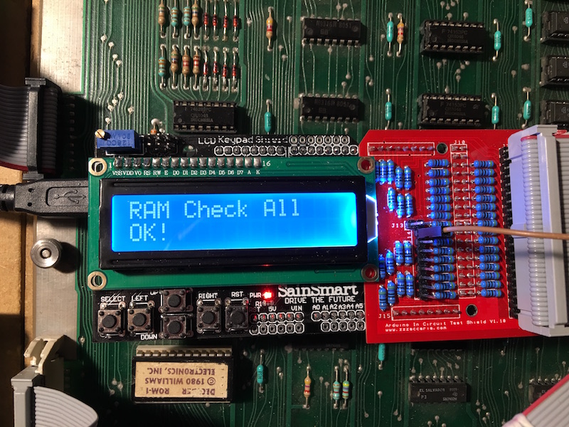

Doh, I totally forgot to set the clock cycles to 3 when constructing the CPU class!
When properly set to 3, the RAM test works!
It is slow, it takes 3 minutes to check 0x0000 to 0xbfff.
Now this is working, to prove it will detect a fault I removed RAM 33 from it's socket and ran the test again and was greeted by this which is correct as RAM 33 does indeed start at 0x0200 and is D2:
Dave20842016-02-27 22:44:06

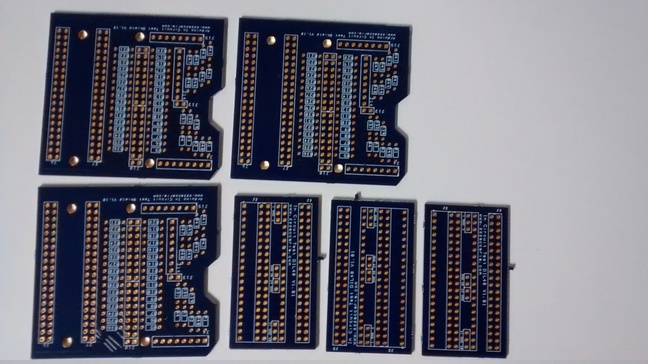

My ICT PCBs came in the mail the other day, so hopefully this week I'll get a set of them assembled.
I have some Williams PCBs to go through, so I'm really looking forward to trying this out. As a side note, any suggestions for how to clean Williams PCBs without loosing the stickers that are on the board? I plan on removing all of the socketed chips before any cleaning, so that will eliminate many of the stickers, but there are some (e.g., serial numbers) that are attached directly to the PCBs. As you can see, these boards are rather filthy.

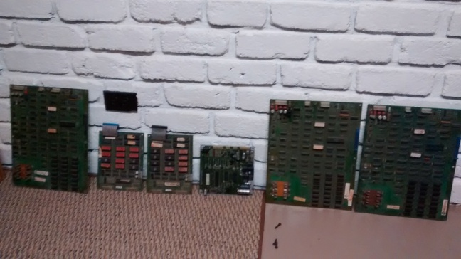

neutrino
15CR
Dave2084 said:
Do I spy some bubbles boards there?
Good eye! You sure do. Two Bubbles CPU/video boards, two Bubbles ROM boards, a sound board currently strapped as a Big Strike Shuffle Alley (to become the Bubbles sound board) and a Rev C CPU/video board. I picked these boards up in 3 separate ebay auctions. I have a converted Bubbles cabinet (currently a Green Beret) that I'm in the process of gathering parts for in order to restore it.
