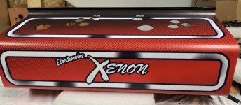

After what feels like days of spraying, sanding, finishing and prep on a few Electrocoin control panels today was vinyl cpo replacement day. Woo Hoo !
have chosen to do everything in my work shop from start to finish rather than sending off for blasting and powder coating mainly as have lots of different ele,emts and finishes on the go.
Ok CPO time !
Xenon first !
All cpo's shown purchased through Olly at Arcade Art Shop. I have to say they look absolutely fantastic as you would expect from Olly ! He truly is a top professional and his attention to detail in creating and reproducing these is top Draw! Big thanks

Flyback2021
43 (100%)
2,359CR
Cheers mate appreciated.
Very happy with it, artwork is great and will match on a fully restored cabinet as Olly looking at side art and lower section I will be sending.
Have done 3 new overlays and prep is key, remove all rust then prime and finish making sure as smooth as possible. Changing cpo is a good time to clean out the buttons (leaf in particular on xenon’s) cleaning and servicing joystick .
If the overlay is original and complete I would not normally replace, the ones I have dealt with either have way too many button holes ( had some with 8 per player 😂) and CPO torn and lifting due to rust.
