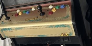

Spare few hours so turned my attention to another Electrocoin cabinet today - Neo Geo 4 slot MVS.
First up control panel - tired cpo lifting in most places where it hasn’t already cracked and peeled off. The rust can be felt under it in places !
Scrape and orbital sand with 80grit for a while..
Countersunk the screws on catch locks so they don’t pop through new overlay. Added some nylon washers on other side and filled flush with some
JB weld.
Metal paint added .
Flyback2021

Neo Geo overlay time !
Did a finish coat on panel with a foam Roller and a light sand with wet and dry until mirror like finish ready to apply overlay. Done a fair few overlays in last few months, always a lot of double checking and measuring.
Fantastic quality overlays from arcade art shop @muddymusic on here.
Triple measure and clamped
Up.
Flyback2021
41 (100%)
2,209CR
Hour later and ready for a yea but went well , trimmed off excess and will put under weight for 24 hr to improve contact adhesion
Added the trim on top lip - love this stuff as has adhesion inside
