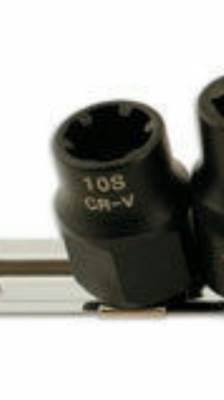

the top one looks like a security torq bit like below
the bottom one is something like a 6 node security bit or similar

I think it's one of these. As mentioned above a garage will have one.
If you could get it out properly you may then be able to clean it up and get the original part back in.

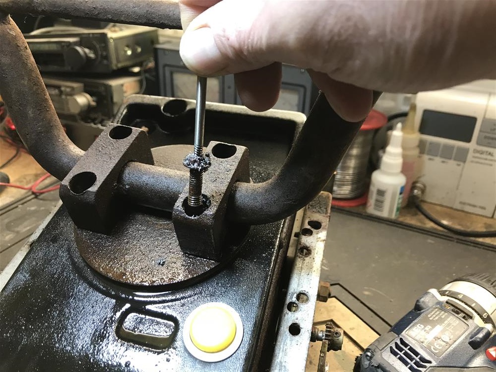

So i decided after soaking the bolts to remove the top ones which i had the drivers for, they came out really easy so i decided to give the lower ones a try with the easy outs i have and promised myself i wouldn't try to hard risking snapping one off in the head, after a centre punch i used a small sharp 2.5mm drill and then a 3.5mm drill being the optimal size hole for the chosen easy out. gave it a go and out they popped! Phew.
I was disappointed that i still cant get the plastic off until i strip all the shaft out behind but i was going to do that any way, i just wanted it off NOW Grrrrrr. At least i can take all the rusty bits to be blasted now. I assume the reason for the cut in the metal plate was so the operator could get it off without getting the bars off.
Ill mig weld the plate and grind it back, it wont show

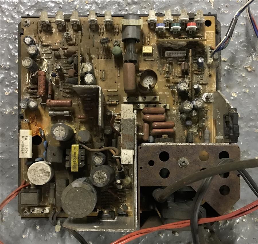

How did you clean up that monitor PCB so well?
There's probably enough of that artwork for someone to shove it in a scanner and redraw it to fill-in the blanks (if it hasn't been done before).

I was bad, real bad and stuck it in the dishwasher!
Should be ok, gonna change all the caps and I sealed the pots on the HOT so no water got in there.
The truth was that I was going to buy a new one anyway so just stuck it in with the plates from the roast we had earlier. Came up so well I decided to try and fix it. I’ve blown it out with the airline and sprayed all the pots with contact cleaner. Let’s see what happens.

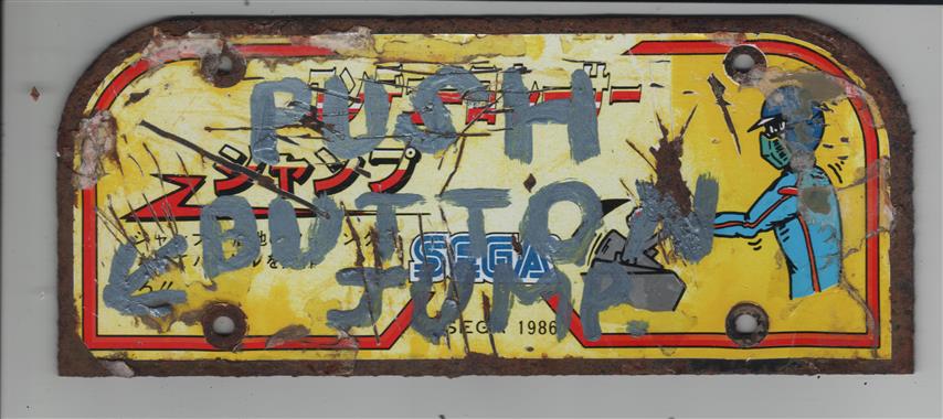

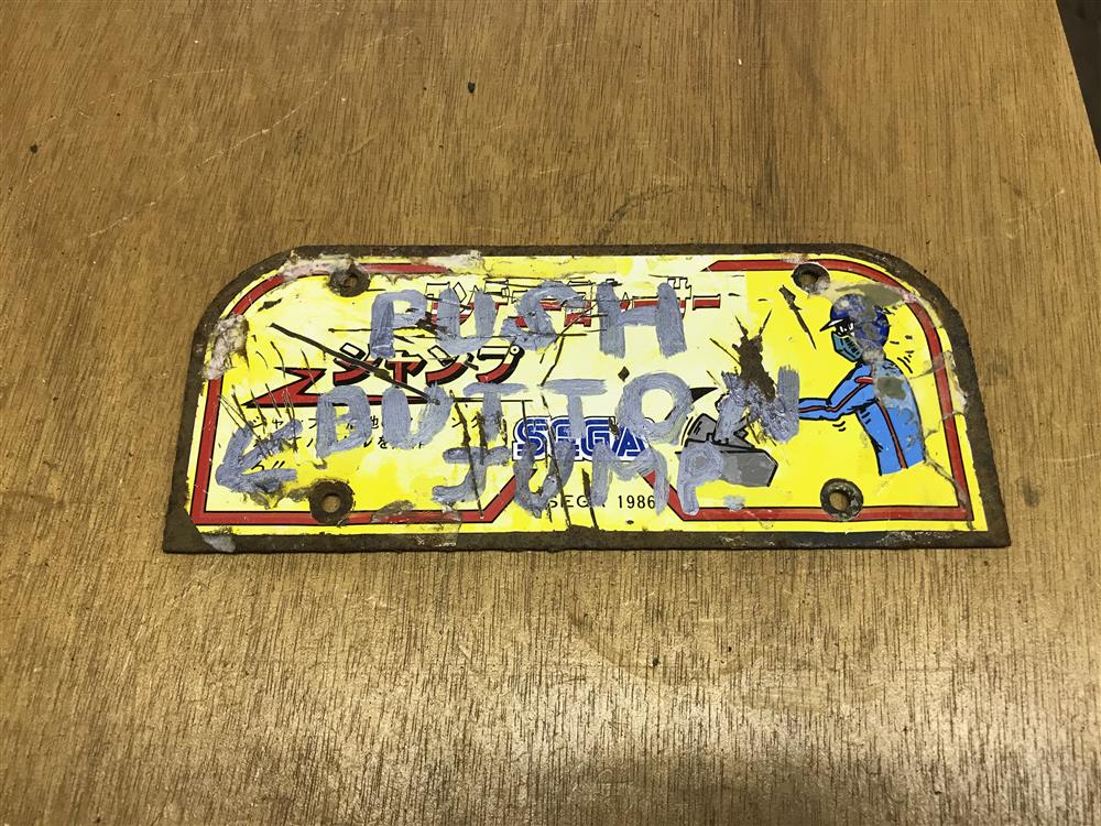

I scanned in the handlebar art work so i could ask if my sister in law if she could spank it in photoshop and only after doing the scan, i spotted its not even in English. Humm what now, ill turn the net over and see what's out there.

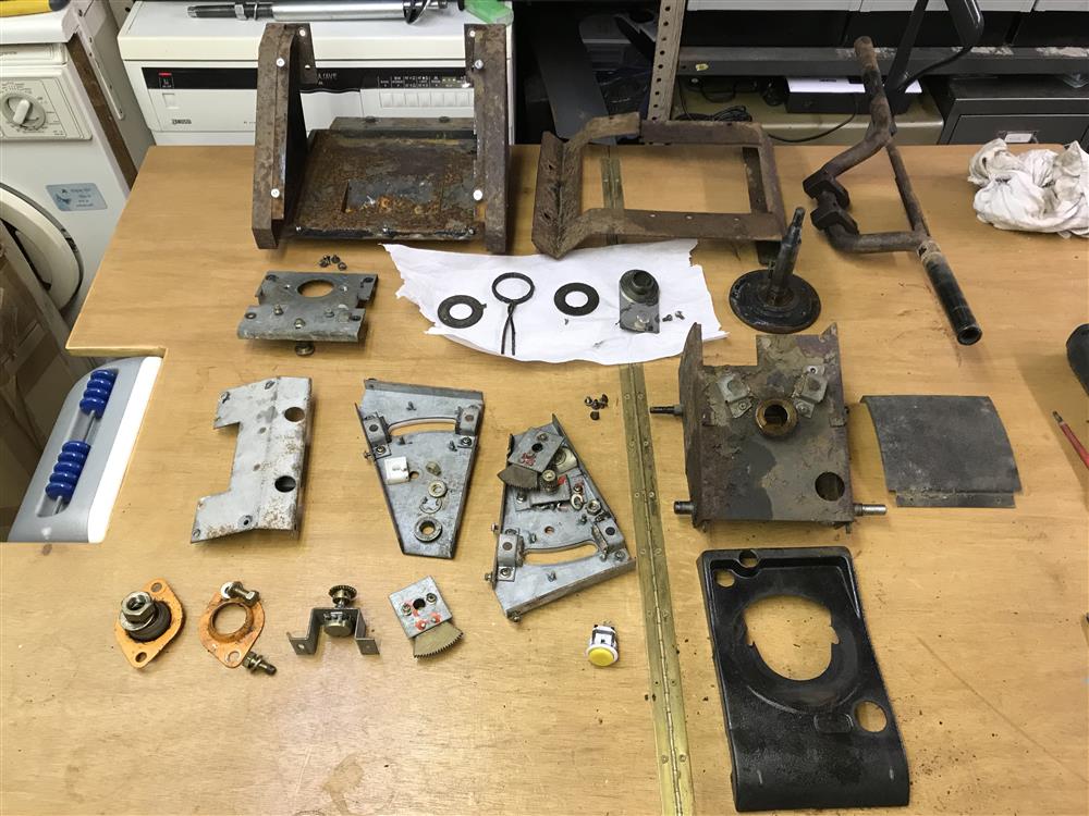

Bars all stripped ready for the rusty bits to get grit blasted and powdercoated.

Arcade Fix It have an image of a US version, says out of stock. You might be able to use it to help with making your own.
