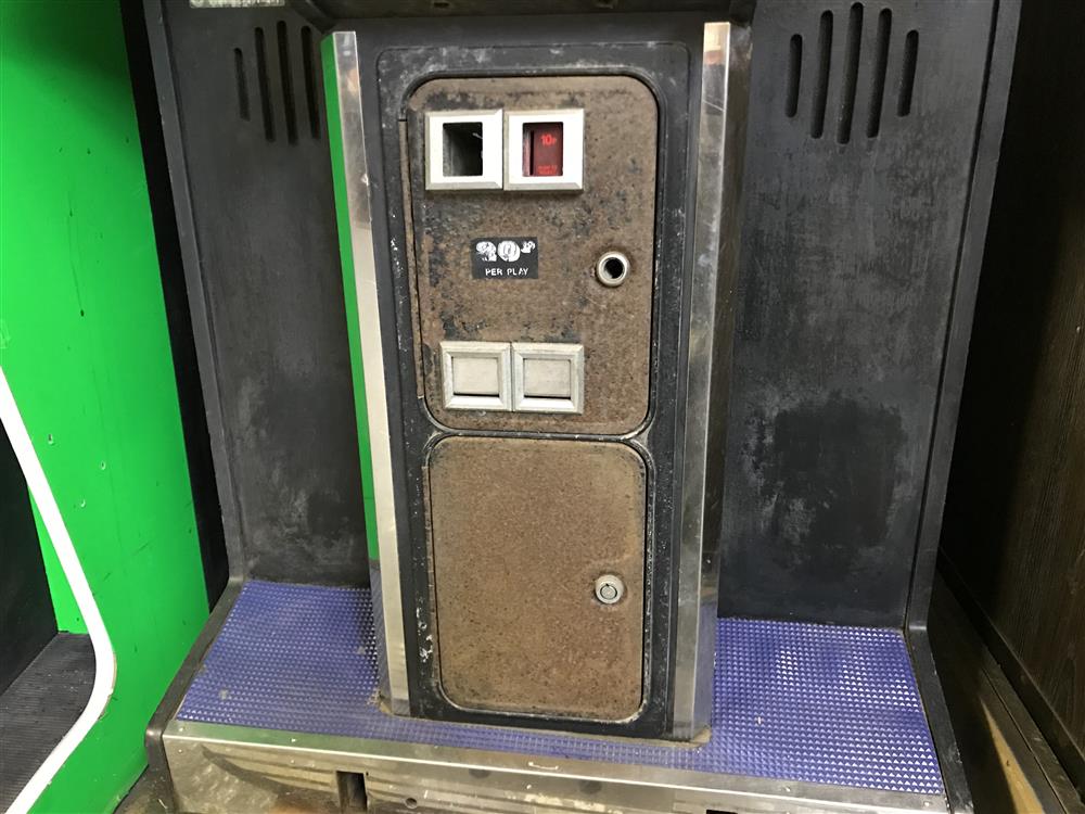

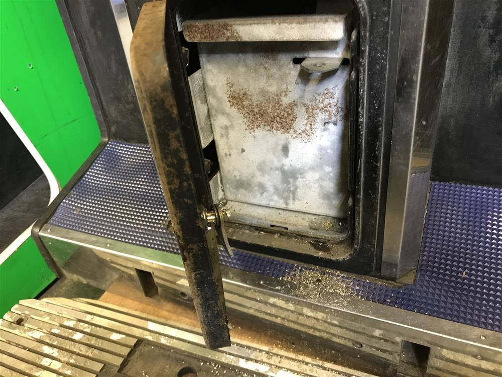

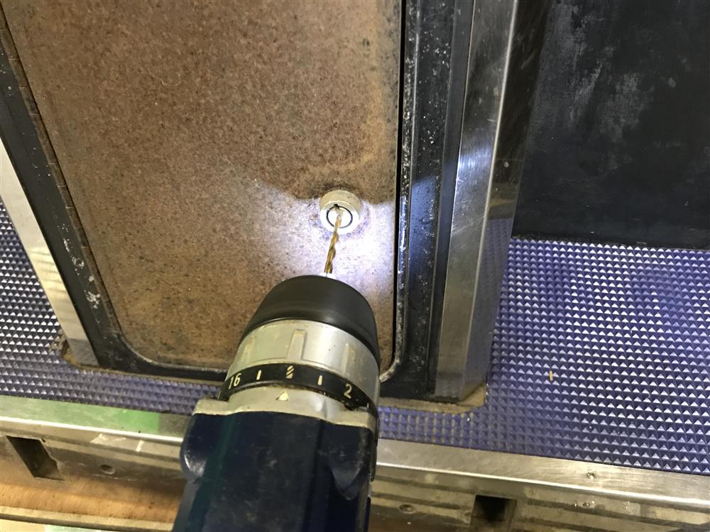

Whilst waiting for parts in the post, i got the lower door off.

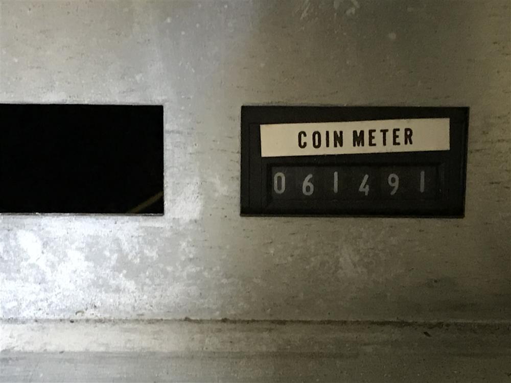

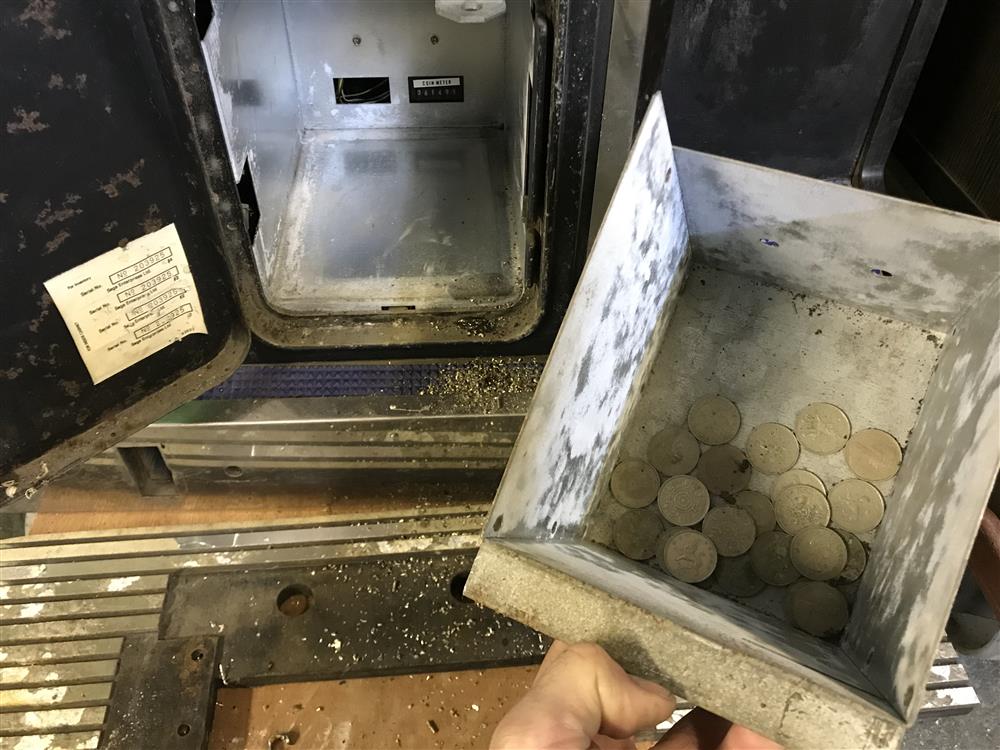

So how much cash has this taken? i assume its always had a 10p mech so that's £6149 10p
and if it 20p a go then its had 3074 plays. is that lots? or not?

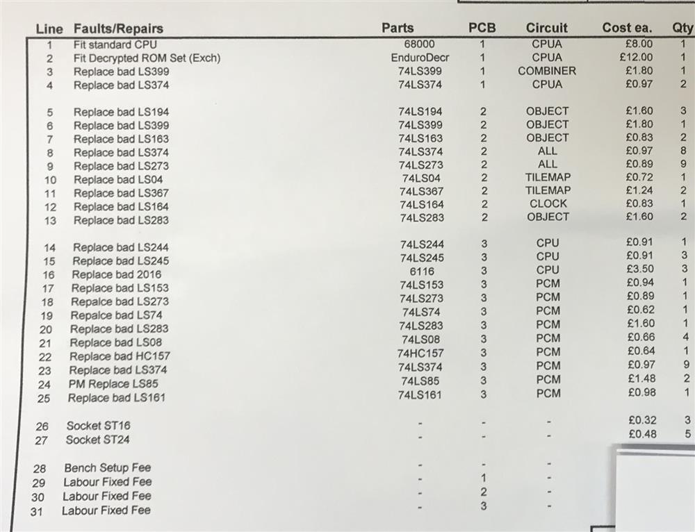

Update from Retro Clinic -
look what just turned up!
Going to leave them protected until i am ready for them. He sent me a video of it working. such a cool service, kept me posted all the way
https://www.youtube.com/watch?v=THpC0sl1Bkc
In the picture I kept the money private, all i can tell you is that he spent two full days on it and it was worth every penny.
Amazing how much he replaced, hopefully its going to work right into the future.

Those batteries last forever. It's outlived most of the other TTL logic components on the PCB! I still have Sega boards running on their original batteries from the 80s no problem. dj_yt2017-11-22 18:17:30

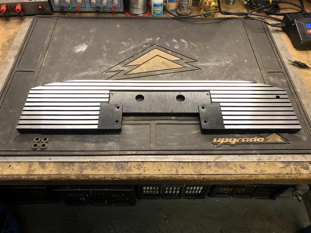

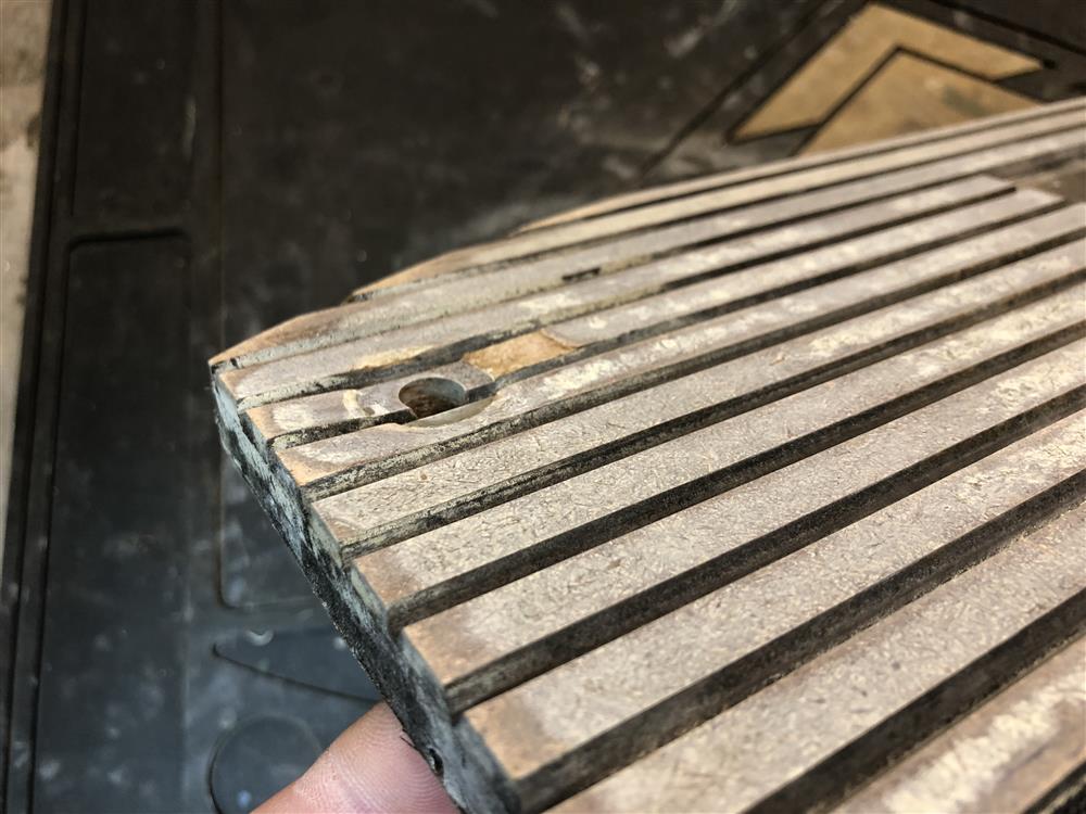

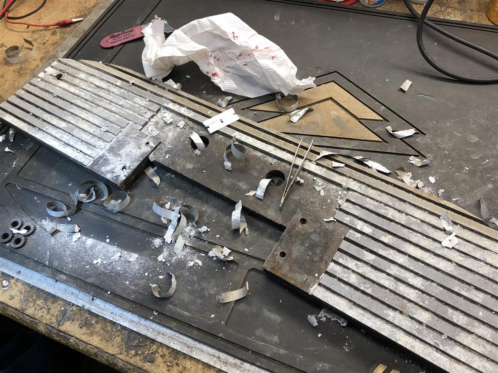

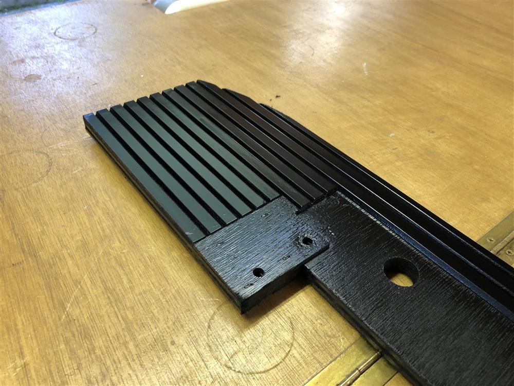

Dashboard - Finished
You can see where the bolt has been overtightened and squashed the
wood in.
[font="Verdana, sans-serif"]Using a ruler with sticky back 240 grit sand paper with a small wedge which i casted from a surviving area of the dash, i was able to sand the original profile back over where the damage was.[/font]
[/font]
[/font]
[/font]
[font="Verdana, sans-serif"]Some Matt black paint and good as new.[/font]
[/font]

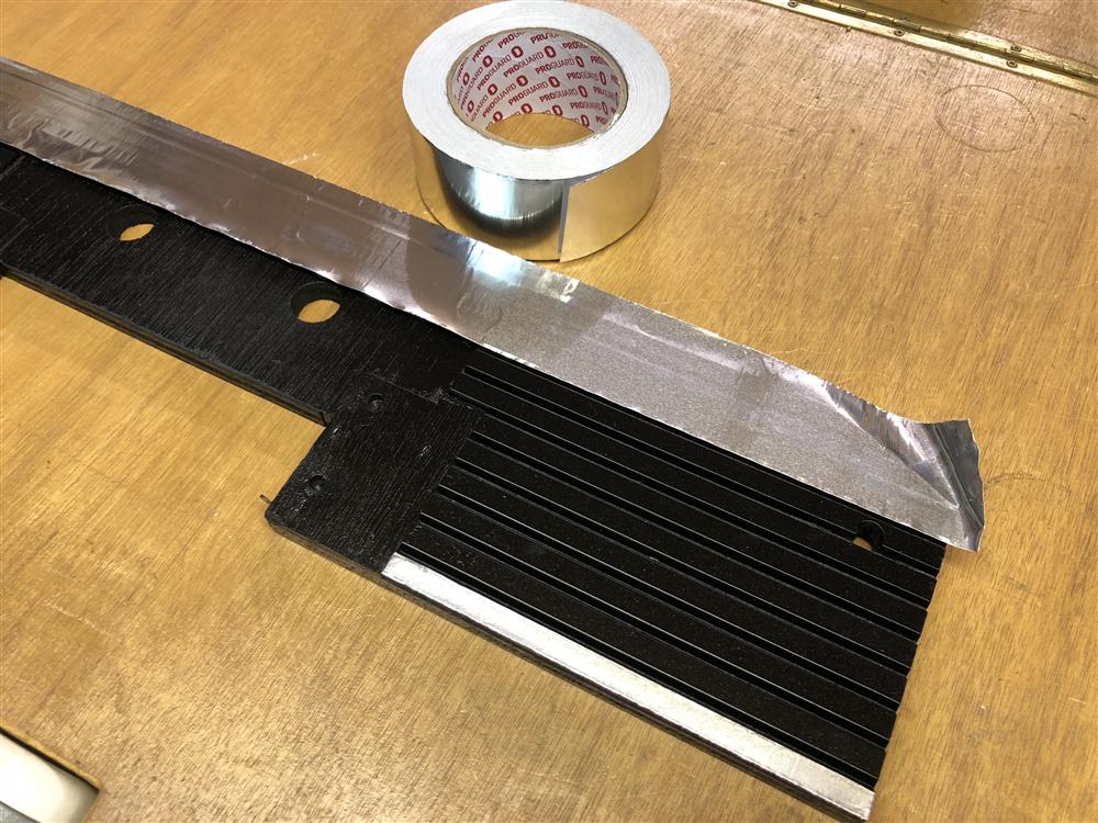

[font="Verdana, sans-serif"]Now the tricky part, it turned out ok but i wish i had thicker ally tape as some of the imperfections showed through.[/font]
[/font]
[/font]
[/font]

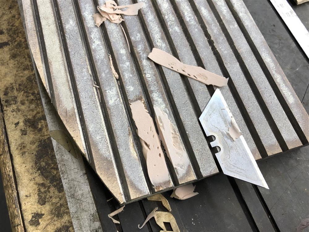

[font="Verdana, sans-serif"]Using a blade i run carefully down the edges and removed the unwanted tape.[/font]
[/font]
[/font]
[/font]
[font="Verdana, sans-serif"]Pleased with the results but if anyone knows of any thicker ally tape let me know.[/font]
[/font]
[font="Verdana, sans-serif"]More to come soon, just waiting on parts.[/font]
