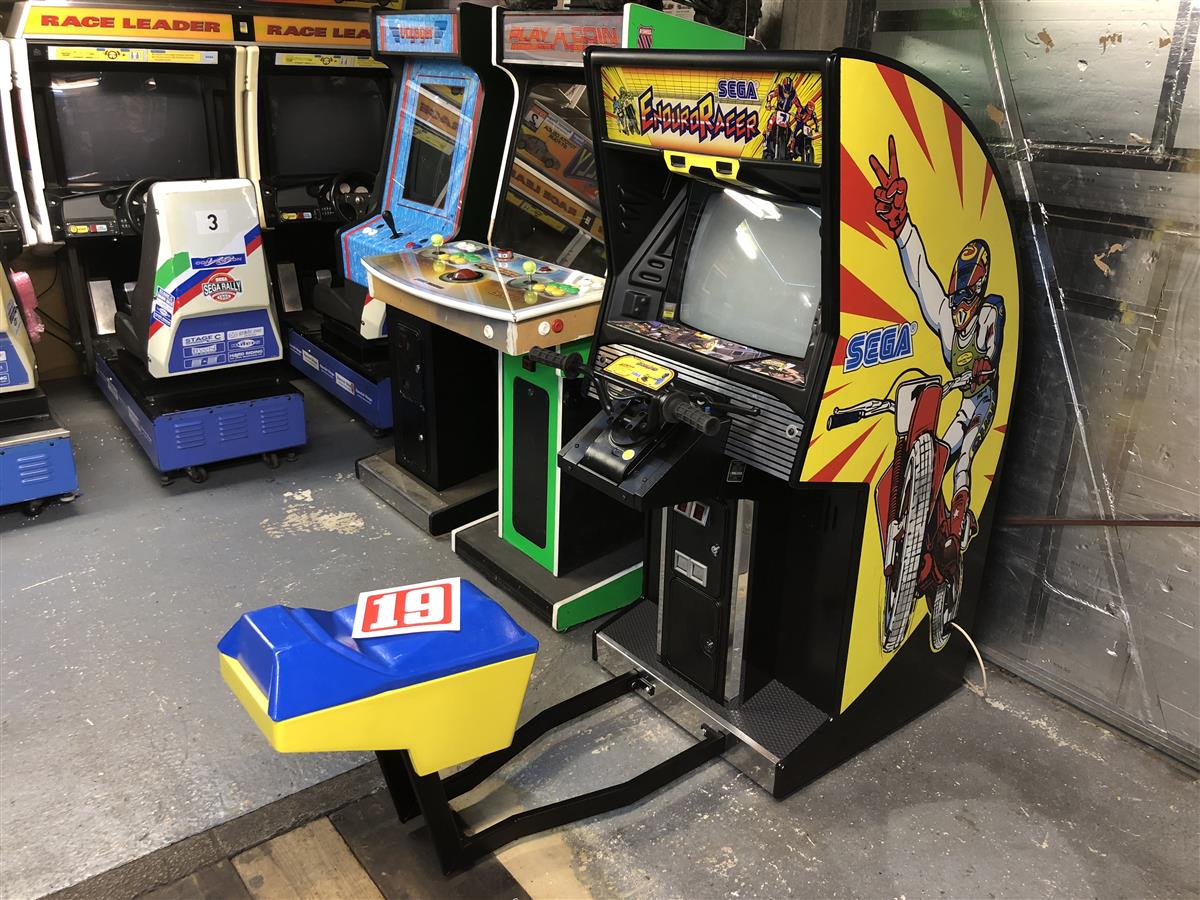

So is this a sit down cab without the seat or has the base of an upright been chopped?

No its not been chopped, its an original sit down.
As far as i can tell there are 3 types:
1- upright
2- sit down
3 - full DLX that (2huwman) has on here.
Mine is the sit down which we didn't realise existed till recently and it was hard to find a picture of on the net.
Previously in the thread i have made a base that fits under mine which does two things, allows me to move it around my workshop as i made it with wheels and also it brings the height up allowing it to be played without stooping down when the seat is away. The seat would get in my way if it was permanently attached. If you look at the speaker grilles below its easy to see the height difference.
blazerfrazer2018-03-28 11:23:08
dj_yt
787CR
Yes Sega made static sit-down variants of a number of their games of this era:
Space Harrier, Hang-On (never seen one in the UK though) and Enduro Racer. There's also a static but enclosed OutRun cockpit (Japan only).

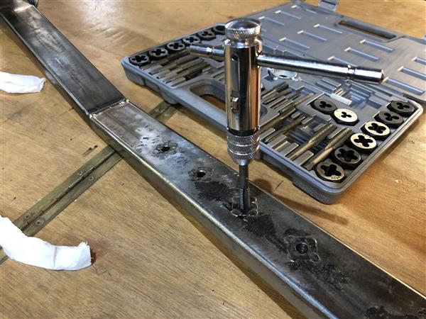

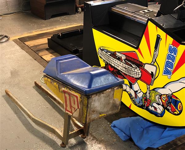

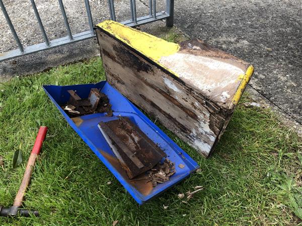

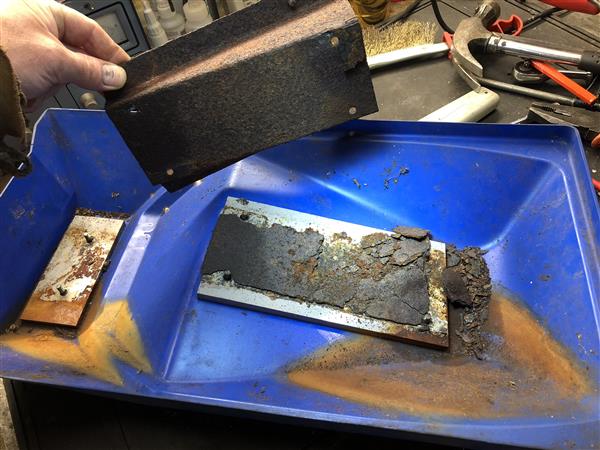

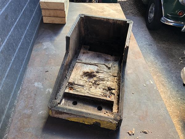

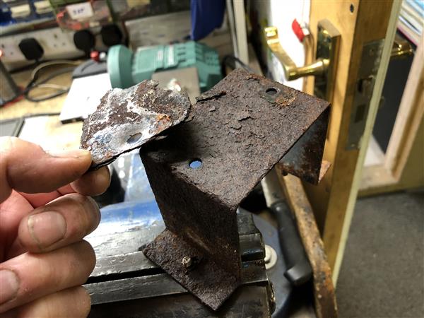

Its been upside down in water i think, well rotten and i'm not sure i can save the bolts.
With heat and patience i managed to cut the nuts of and leave the bolts in tact, after i run the die on them, they were good enough for new nuts, result. Look at all the rust, its 2mm thick. After it hat it in my grit blaster, i was please to find enough strong metal to allow me to use the original brackets.

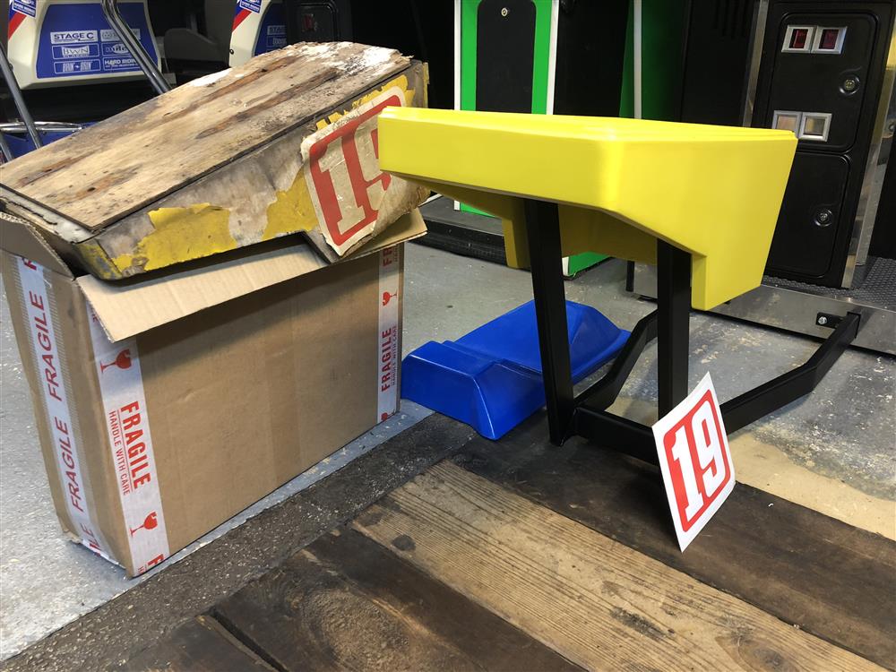

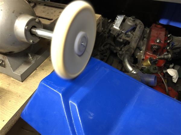

Using my mop i gave the seat a little polish, no cracks anywhere which is good. I did the best i could. Looks presentable.

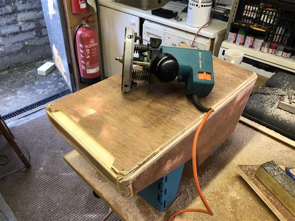

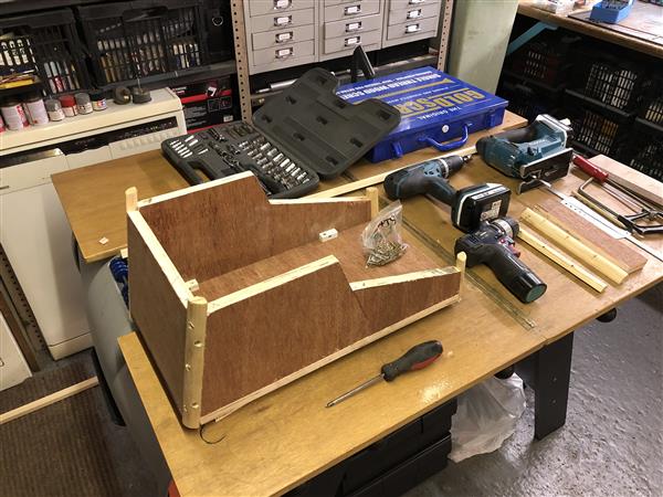

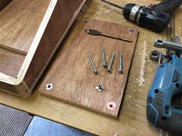

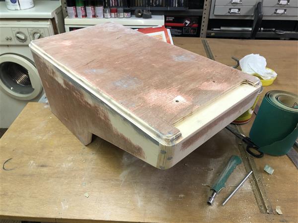

This is going to be tricky... its totally rotted away. I will make a perfect replica.
There has to be a gap around the outside so the
plastic seat only loads the centre brackets and not buckle the sides when there
is a person on. This was tricky to work out. All joints are screwed and glued.

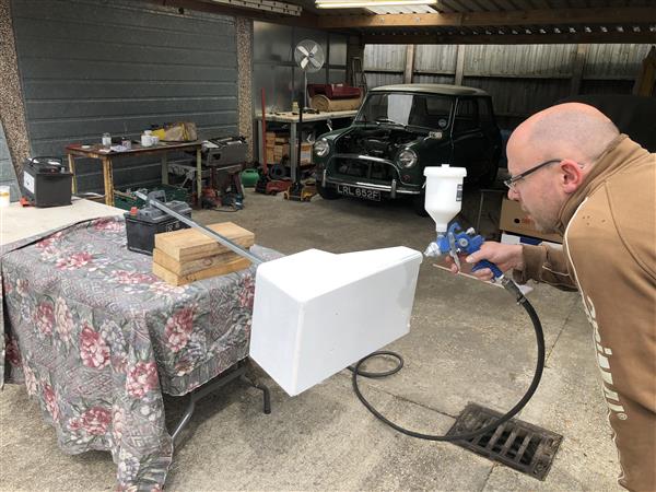

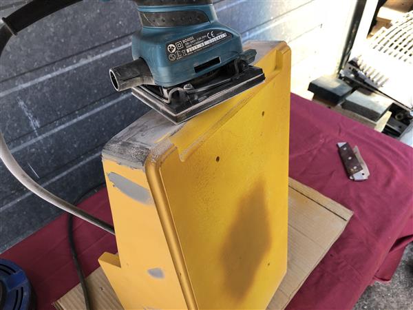

Several coats of filler primer and filler to hide the wood grain and any little blemishes, took ages.

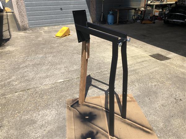

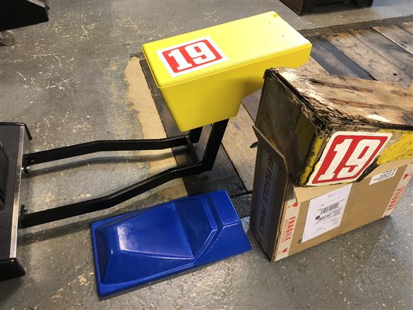

Frame next.

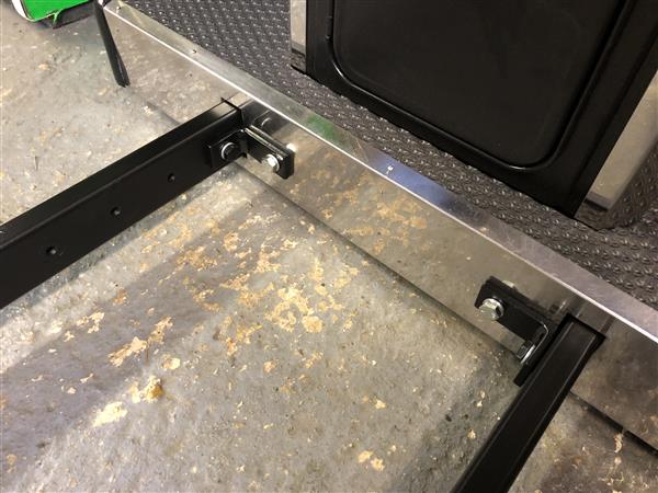

I had forgotten that the brackets that secure the frame to the machine were missing so i fabricated some.
Some welding and some black paint, a few new bolts and lock washers later and it was done.
The frame was originally chrome but no one locally could do this for weeks so i settled for semi gloss black. Perhaps one day i will have it chrome again.

So this is it! it really is finished. I cant wait for you guys to play it, If you see me and Finley at Revival, come and say Hi and show me your skills, i haven't played it much at all, too much restoring going on.

That seat is a work of art! You should start a production line. This is one of the best restorations I've seen. Yu Suzuki should come and sign the machine!
