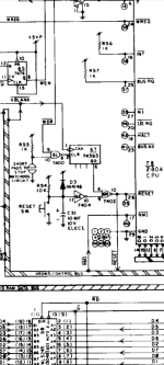

Reset stuck low and reset cct looks like this. H/L being a pulse. I presume that pin 11 at 6E ought to be H. However without a reset switch to check I'm lost again (and going rapidly backwards (again)).Screenshot_20231008_164902_Outlook.jpg
NivagSwerdna
840CR
6N is a NOR
A H at either input will cause the CPU in reset.
If pin 9 is H this will cause a reset. In normal operation this should ALWAYS be L. And the input pin 11 of 6E should be H, pulled high by R54. The only exception to that is when power is applied for the very first time... pin 11 of 6E will have zero volts until C31 charges up (through R54). The initial charge thing is to keep the CPU in reset as the board is powered on.

All the reset cct chips seem to be doing their jobs. Can I force pin 11 high to see if it triggers the reset high and therefore proves the fault lies in c31 or its equivalent.

Resistors in non-power circuits rarely fail. It is more likely that you have missing power or a broken trace. It is possible that the capacitor is shorted but again probably unlikely.
Just use some deductive reasoning as you probe around.
On my Galaxian bootleg the components are located almost identically to a real one.
ArcadePCB
509CR
Have you checked the reset switch already? To draw pin 11 / 6E low, there are 3 possibilities in this circut:
- Reset SW is shorted or there's a short circuit on the PCB. Check the solder side of the PCB for bend IC pins or solder spots.
- C31 is shorted as mentioned above.
- R54 is open. This would not lead to a defined low level at pin 11, but it would lead to a floating pin 11 which could be interpreted as a permanent low. As mentioned, this is not very likely, but check it to be sure.
R54/C31 is defining the time constant (100ms) for the power on reset.
So pin 10 / 6E should be high immedeately after power up and become low after 50ms ... 150ms when the circuit is working.
