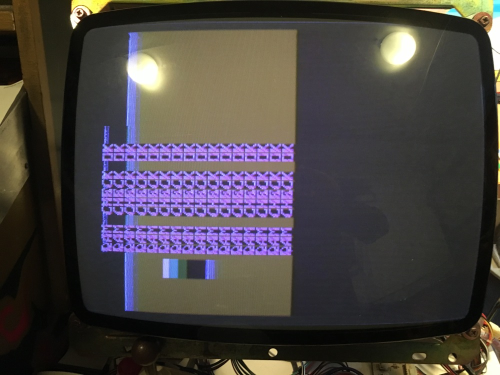

I've been on quite a journey with my board since the last update.
So my board's video issue is now solved and i can now also (with the std game roms) get passed the zero screen and be presented with a text screen message, so i'm pretty happy right now! No more scratching around trying to rsolve the video sync issue or using the screen flip option to see what's going on.

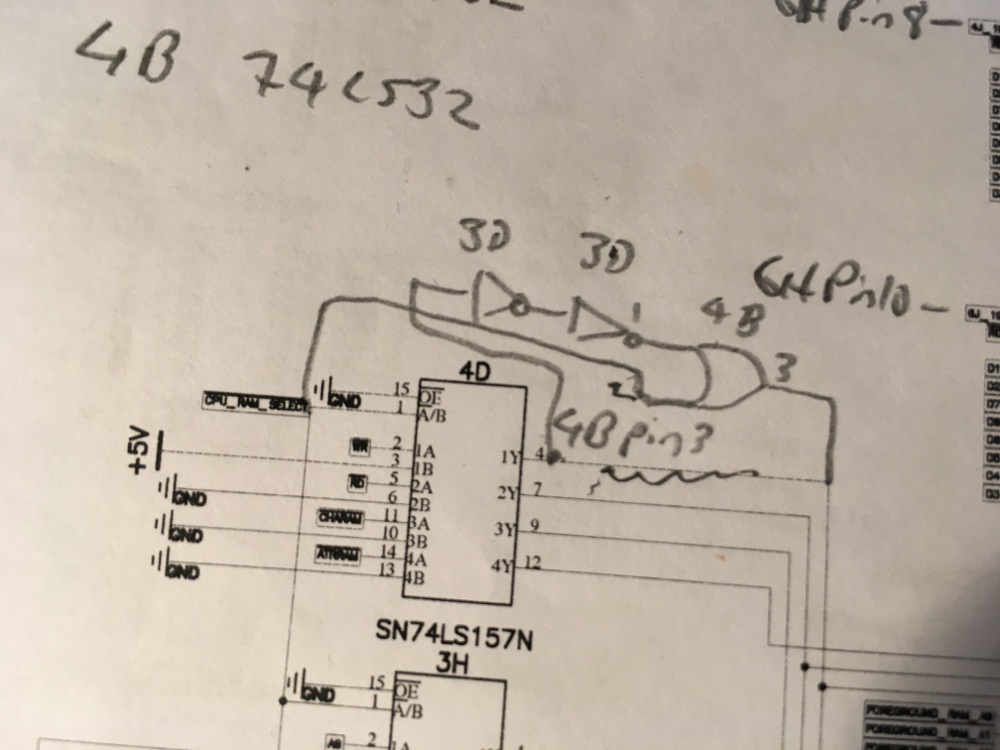

Both issues of no visable image in std mode and also no text or characters on screen were both related to the same issue. What i worked out after hours and hours of debug is that there is another difference on my board to the schematics. Yes, another modification/slap right change is needed. I found that there was no write enable access to the foreground ram chips and when i traced it back i found some inverter gates and an or gate in the logic. Seems that the write enable line is buffered (possibly for timing needs) and as such looks like this.
I can draw this up better if you cant decipher the change. The chip at 3D is also used in some logic for the screen flipping. (shown at the bottom of the schematic page)

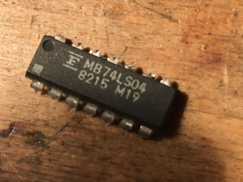

I also found that this inverter chips was a Fujitu brand and i've had lots of issues with these chips dyeing over time (in many other boards). So much so that it is a known idea to just shot gun all Fujitu ics when you have a bust board!
Anyway, with regular roms i now reliably at power on get to this:

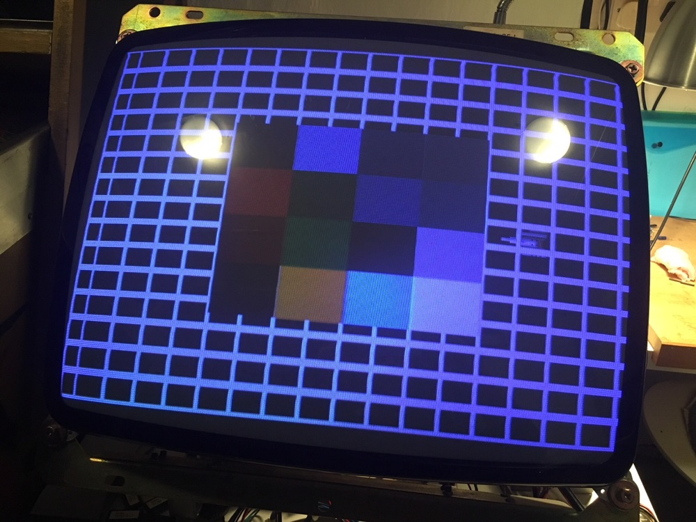

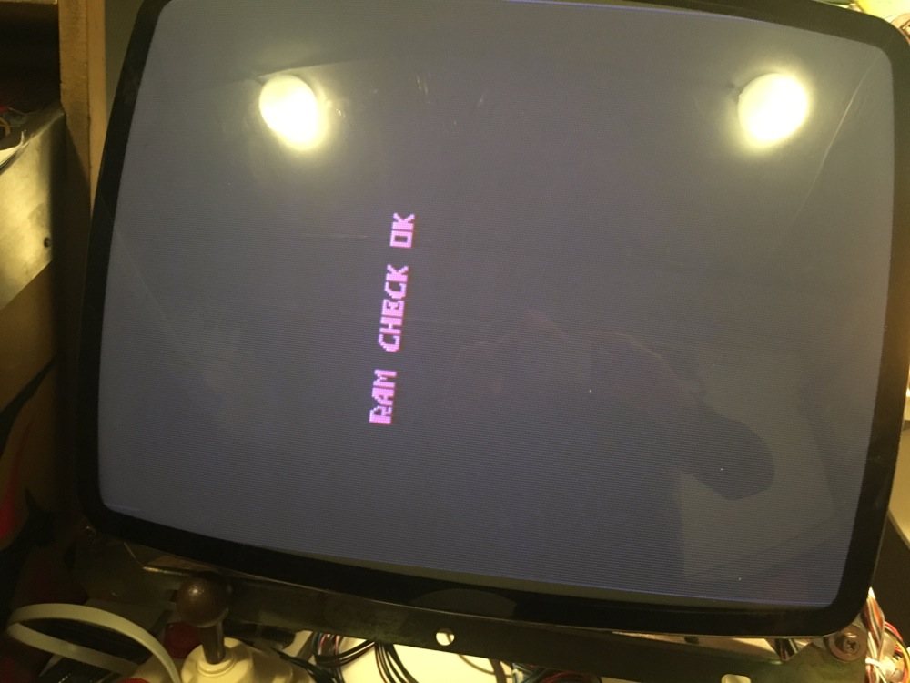

More updates. I solved my repeating text on screen issues. There was a broken trace on the board for the enable on 3H. Was hard to spot as traces on these boards aren't great quality. What are the other boards quality like? Some bootlegs i've had before are actually pretty good quality but not this one!
Now have this with regular game roms
I'm now at the point of trying to work out why the board is stopping at the ram check ok message and not reporting bad roms or rom check ok message.

Ahh, that's excellent progress there. Many thanks for spotting the extra gates in the write signal, no wonder I'm seeing so many problems getting test software to try to run on Tiger Heli when there are yet more hardware differences from Slap Fight.
That extra circuit looks quite crude and asynchronous, using the two inverters at 3D back to back to form a delay. Certainly something that could be very sensitive to timing if it were to be replaced by a more modern 74HCT device, or possibly even a same model chip from different manufacturers.
I'll check my own Alcon PCB later and also double check Tiger Heli to see if it's missing or not there too.

Multiplexer enable fault at 3H would certainly explain the repeating images!

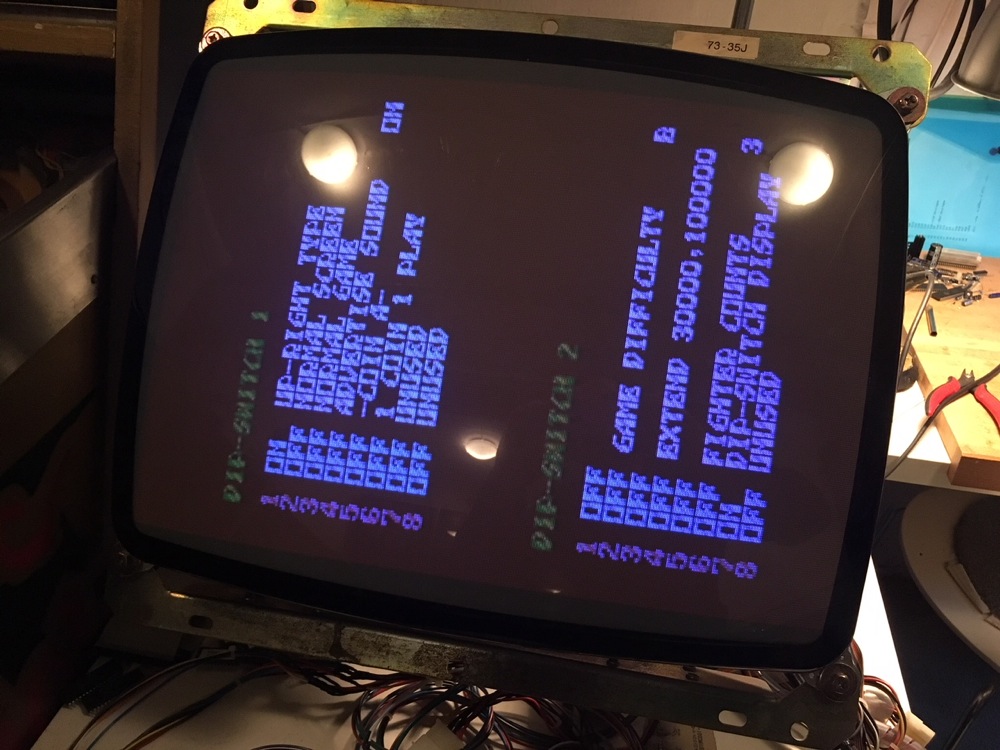

Also found some handy test menus in the dip switch settings
screen test
Live updating dip switch page

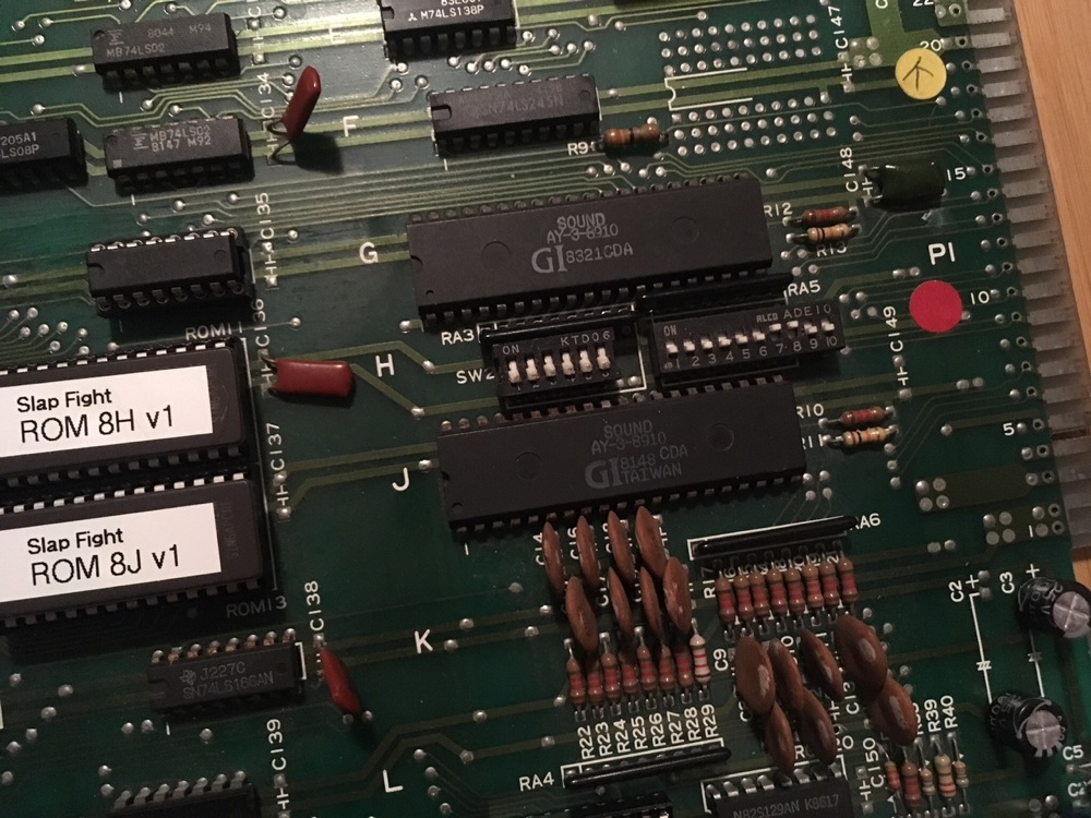

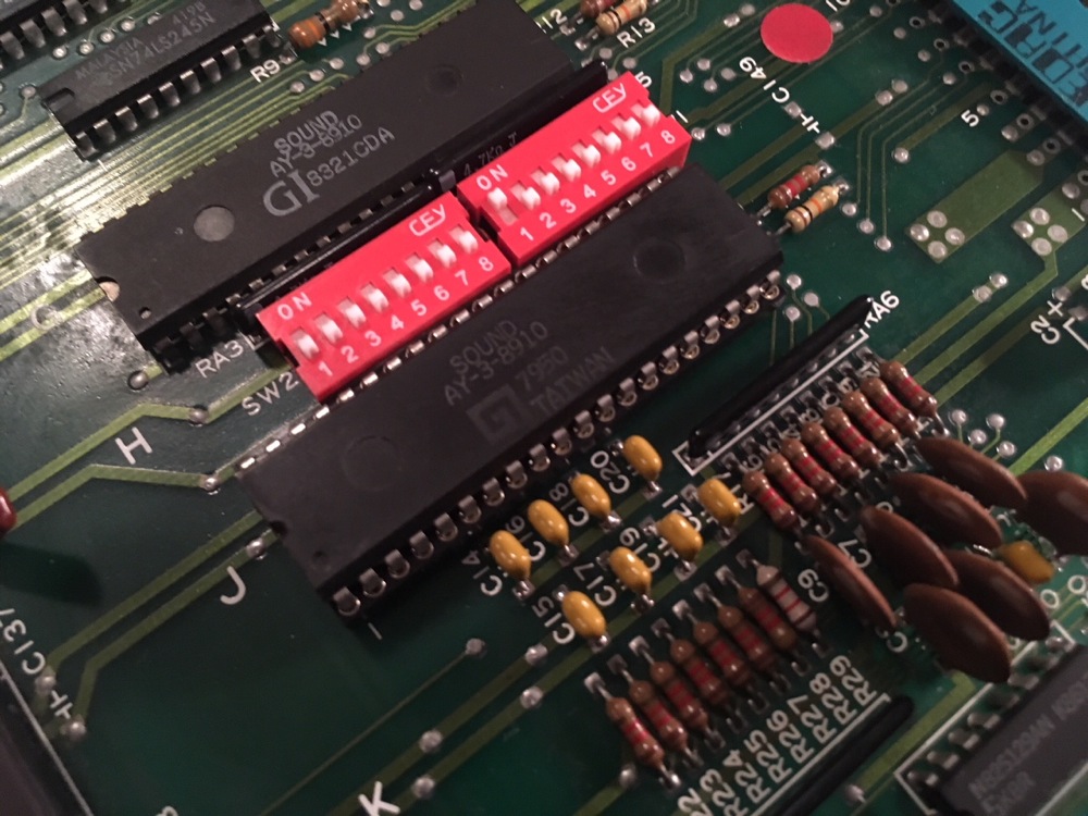

I did some work on the dip switch area and the control switch line caps whilst is fixing some of the faults related to the AY-3-8910 sound generator ic at 11J on the sound/sprite board.
The original boaters had installed nasty dip switches that were too short and too long! Also the caps had all seen better days, so i replaced with MLCC instead of nasty cheap ceramic.
before
after
That brings my repair for this board to a close. On to the next:) I am continuing to help Neil and Alex out and also hoping to work with them to create a high score save solution to for this board set :)

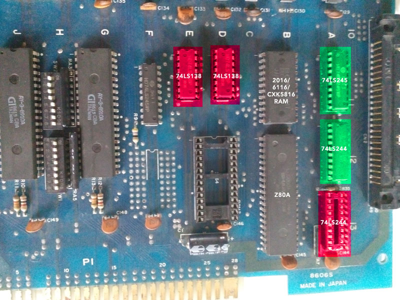

My board set seems to have it's problems with the top 'AUDIO' board - the one with the external connector on it for reference
Neil's Test ROM is clever enough to talk to all the sections of the RAM from the bottom 'CPU' board and identified that it was having problems trying to talk to the Audio RAM that is shared with the second CPU on the top 'AUDIO' board
The way to get the test to function is to dis-connect the board connector nearest the top 'AUDIO' Z80 and then the test can continue with a forced FAIL
Testing the Fujitsu chips on the top board, it turns out that the pair of 74LS138s 3-8 line decoders and one of the 74LS244s that do the memory addressing are failing so my next step is to finish replacing those and see if we get the test ROM to talk to that area of the Audio RAM as well

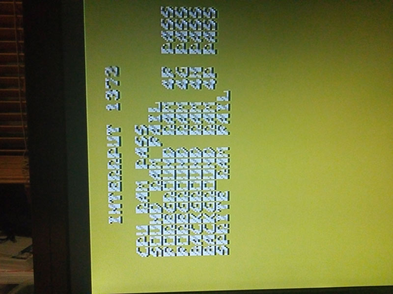

Interestingly the integrated boot test on the actual ROMs hangs at this point too, as it can't return from the RAM check, even though the first reported back result is a ROM test!
Here's the output from Neil's new Test ROM (you can change the colours to make it more readable by removing / adding the 3 colour proms on the top 'AUDIO' board

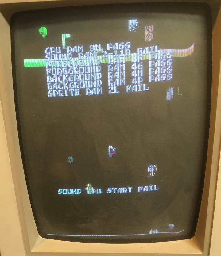

Thanks for posting the test ROM! It's giving me this screen right now:
It's a lot more helpful than just dying at RAM TEST OK, that's for sure.
The SPRITE RAM 2L FAIL message is interesting because that chip is most definitely good. I suppose if this ever gets ingame again we'll know what's up right away.

If you could, that'd be wonderful. When I first got this board it was dying at a RAM error, but since I didn't know that much about fixing this stuff at the time I changed out the sprite RAM first before realizing where the CPU RAM was. It then booted, but I didn't realize I'd messed up a trace when desoldering the sprite ROMs and was having graphic glitches. I must've changed dozens of chips before realizing that I'd messed the trace up. I got it fully working after finding the bad trace. It was working for years until I turned it on again a couple days ago and it's developed this error out of the blue.
dankcomputing2021-10-22 05:40:00
dankcomputing
23CR
I finally got it to boot. Dumb mistake on my part - I didn't quite have the voltage high enough. I thought it was high enough since my Tiger-Heli was booting (and it's almost the exact same board) but there's some scorching on the 5v line on my Alcon that's not on any other board, so that dragged it down just far enough to cause problems.
