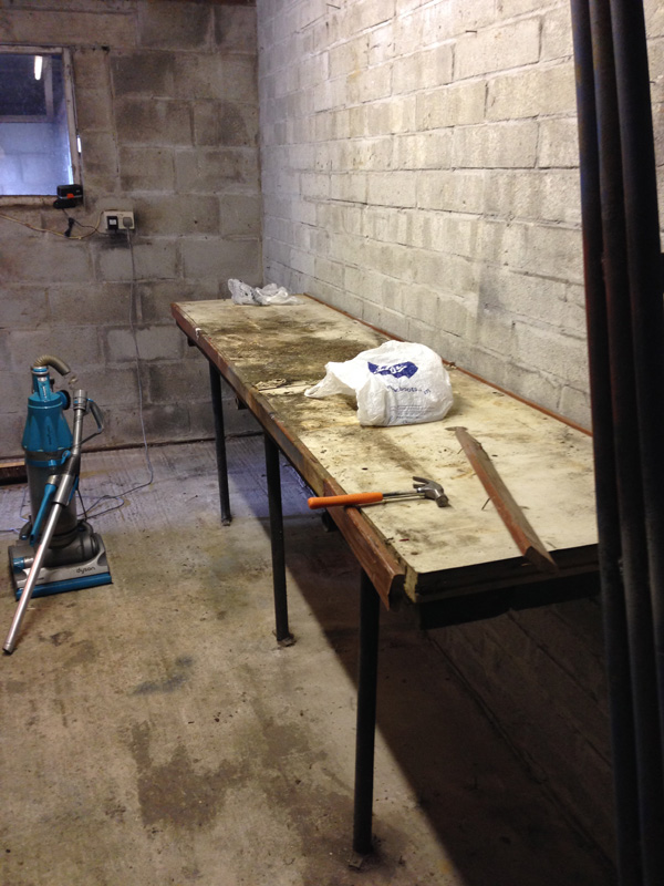

First job is to put move all the non-arcade stuff out and remove the old bench and other crap, then pull out any nails and stuff - just generally give the walls a good clean up.
Man that was hard work to remove. It was pretty much scaffold with railway sleepers on top
Anyway, got rid of it.

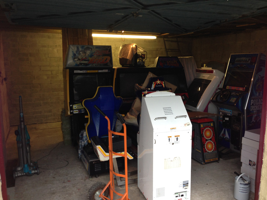

Edges of the room are all clear and cabs have been all wedged in the middle to give me some room to work.

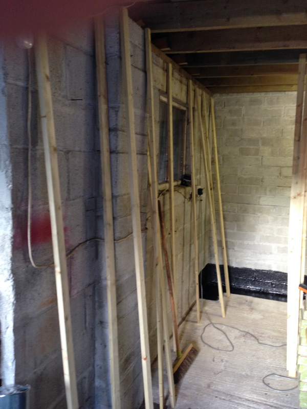

Next was putting some bitumen up the first 2 courses of block and across the floor.

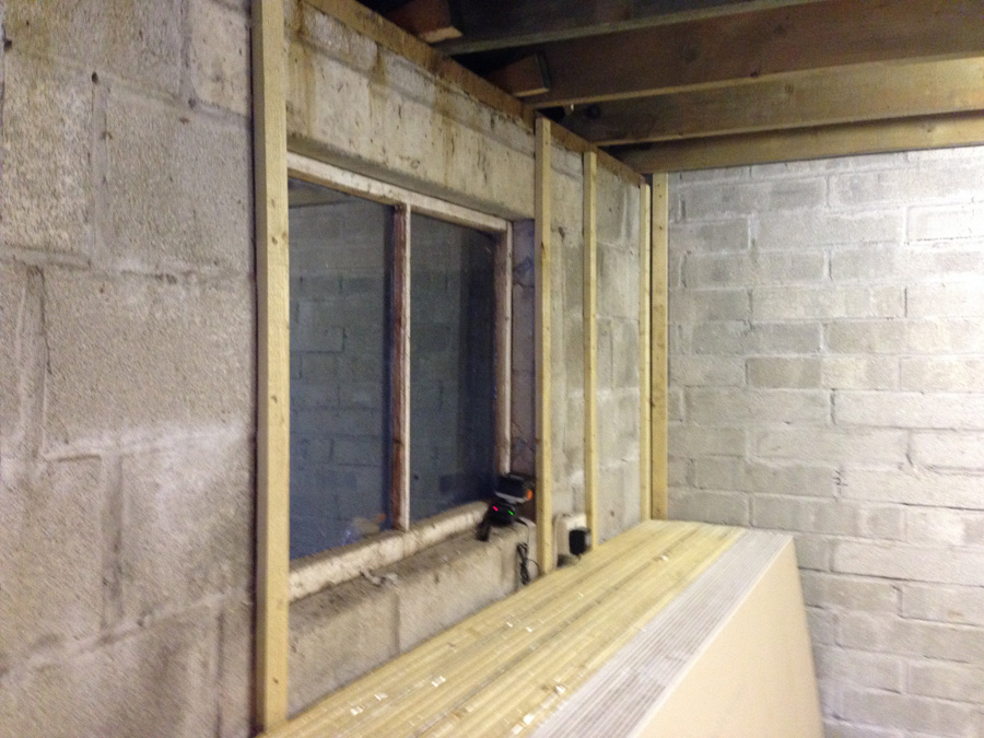

I let that dry for a few days then started to cut and space the wall battens
First lot get fixed to the wall, just in time for my insulation (25mm Celotex) and Plasterboard to arrive.

Don't know if you've already done it Olly, but i'd recommend also giving it at least one good coat of water seal if it hasn't already been done, if it isn't already painted on the outside. You could do it on the inside as well as double protection.
vib_ribbon
484CR
i thought with this hobby, people need to know some basic electronics to upkeep their games and equipment etc. seems like you have to know how to building work too these days!
2,205CR
Luckily it's already been done, and the outside has been rendered and painted so it's all good there
I'm going to be putting a vapour barrier over the insulation, plus a high spec moisture guard underlay on the floor before I lay the laminate.
