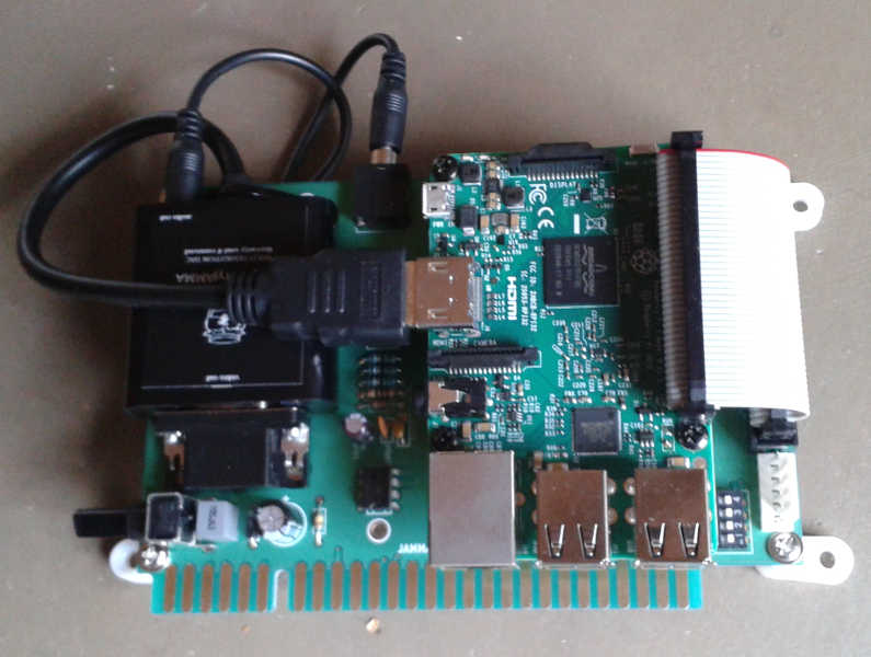

New software version is finally uploaded. Now with rpi2 and rpi3 compatibility, plus Daphne. I consider this a beta release as I haven't had the time I would like to test it but wanted to get it out there for the people who wanted to play with rpi3.

I can offer a video amp added to the underside of the board for an extra AU$20. It's a little hacked in but works well. New version of the hardware will be coming soon with it designed into the board.

Big news, v3 RaspberryJAMMA boards are now available to order. Improvements from v2 include video amp and switchable pure-JAMMA (w kick harness)/ 6-buttons-on-JAMMA. Price has gone up by $5 to AU$160 + delivery without a pi purely due to the extra parts. Full pi3 setup is AU$222 + delivery. Postage to the UK is $20.
