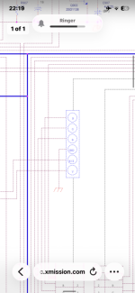

This is a
have you linked earth and common on power supply
have you checked 5v level
which pin is video ground going to the jamma connector
I have not linked earth and common .
Pin 14 vid ground not populated on my jamma harnes .. I did run a wire
From vid ground to field ground …
Didnt help ..
But that says field ground
Só best image I can achieve is when I link that Gnd In schimatic to dc common Gnd .
I dug out two other jamma harnes and they don’t have vid ground wire .. pin 14 populated either
