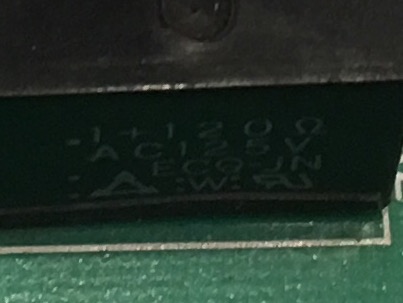

A question for anyone with access to a board, please
There's one or two 'snubber' modules fitted next to the triacs (ZNR1 and 2).
Is there any part numbers or markings?
I'm expecting to have to pin out these for alternatives, but would be nice to know the original values. Schematic scans are too rough to read the values unfortunately.
tin
670CR
I didn't purposely get a shot of one when I was taking random photos, and I'm away now, but this looks like it might be enough?
