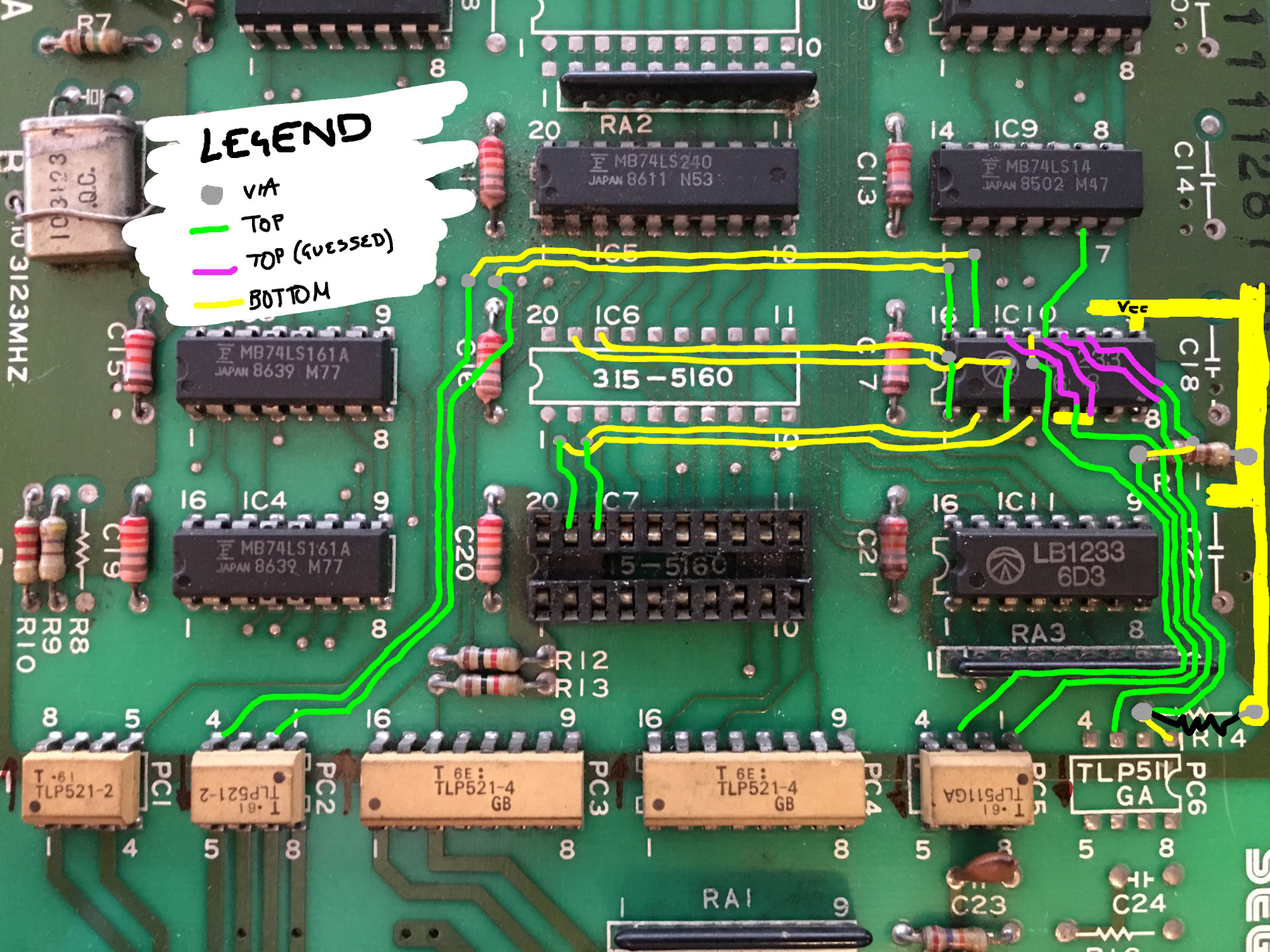

Schematic-wise, there's a few signals on the original that are joined by net names, rather than lines. I had to take some provisional guesses on some of them (ACZERO, etc), as they're just smudges.
Naoki might have validated some of them when routing, but I think we've got some confusion around IC2 (there's comments on the schematic).

Having said that I'm convinced ACZERO and !ACZERO are flipped. The routing does not make sense compared to PCB picture and how the board flows.
Also can we turn off thermals or prefer to leave them on? Either way doesn't affect me, just the original had no thermal relief

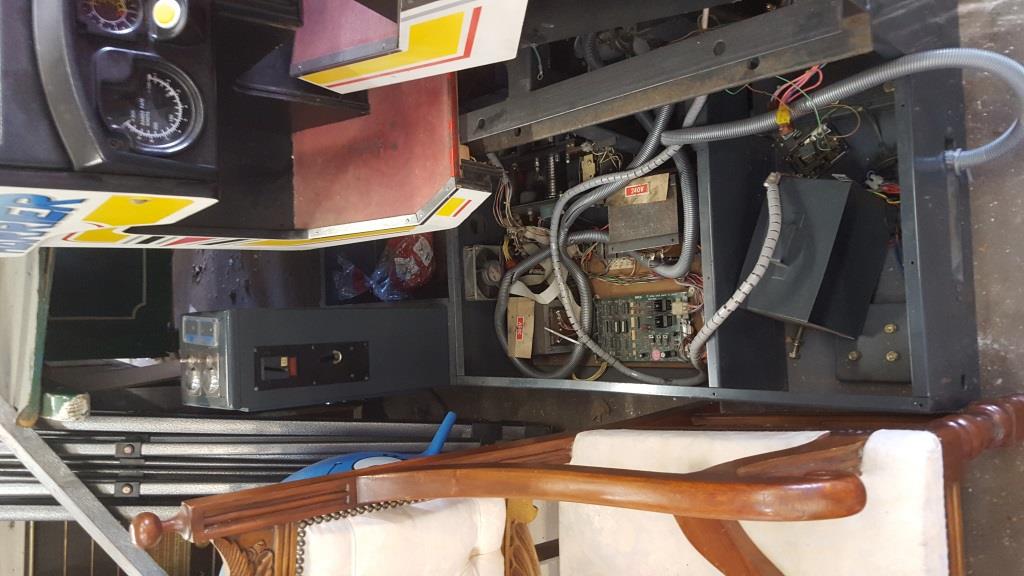

There's acres of space in the outrun cab, but to be sure I'll measure the clearance. It's also surrounded by wood, not metal in case of any short worries. Space harrier I dunno about unfortunately. Anyone able to comment?
John Bennett
5,198CR
Thanks - loads of space.
Not expecting anything like the image I posted though - I'll hopefully find something resembling the original - it's the width that's the challenge, more so than the height.
