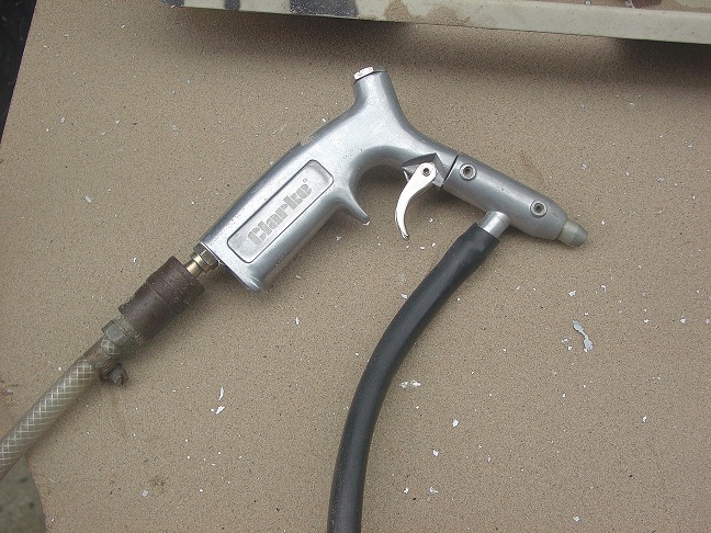

Will do Dan, still need to get some sand. It's very easy, the gun cost me about £20 from machine mart, all then needed is a bag of block paving sand (silica sand) and something to catch the flying grains. I found a big plastic storage box and a broken bezel works for me

You need a bag a Kiln dried sand otherwise the gun clogs up @ £4 from Wickes or equivalent
Then you need a small gun blaster from various places for about £20
Then you need a decent size compressor, no pic but you know what one is

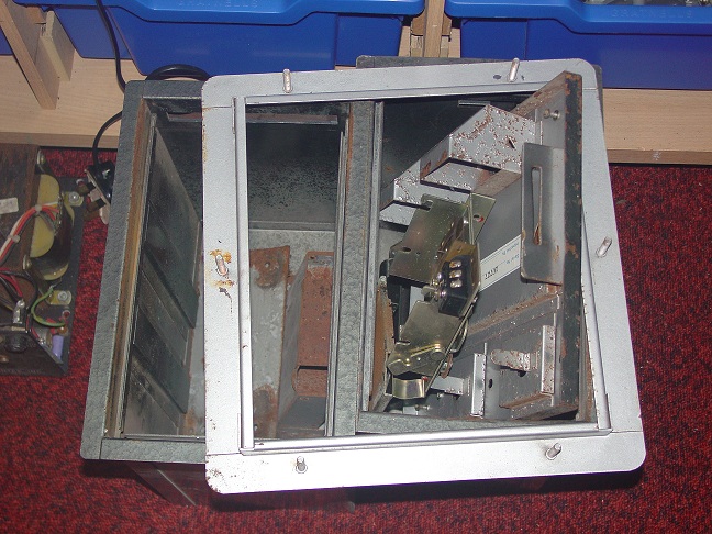

Two complete coin collection assemblies, coin boxes, doors, mechs, frames, chutes etc (earlier pic, hadn't stripped 2nd door yet)

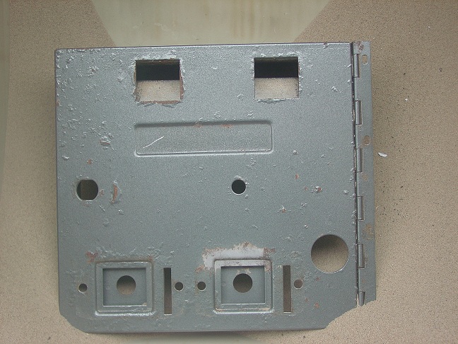

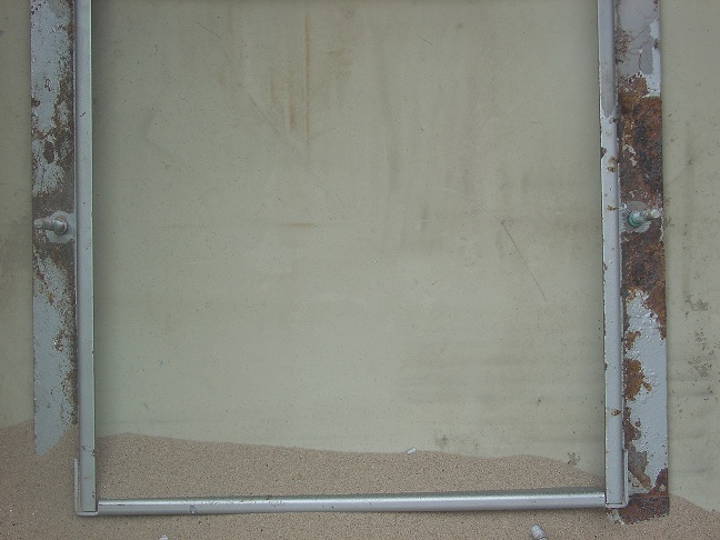

First up rusty things..

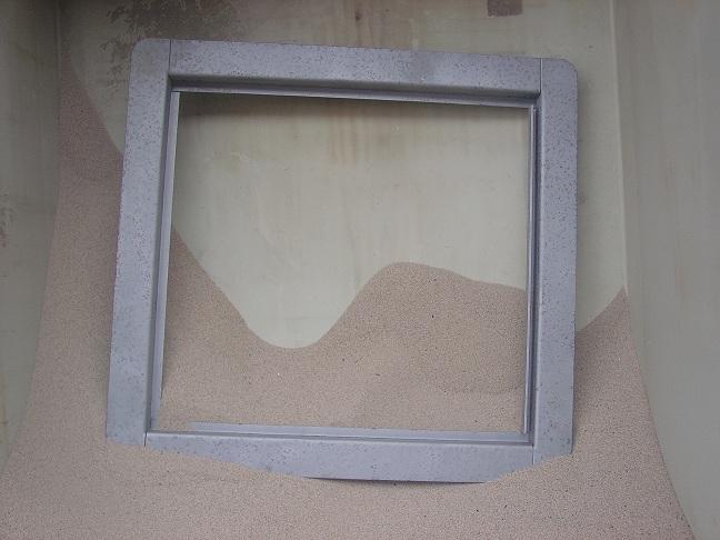

Also found a use for the knackered bezel, last one is frosted
stops most of the deflected sand but after a couple of hours, visibility is getting poorer.

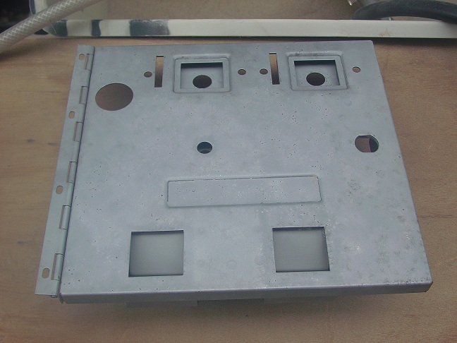

After about an hour we have...
Did the mechs, frames, 1 coin door, 2 Asty marquee rails and a Taito CP bar before I 'd had enough as it started bloody raining, typical

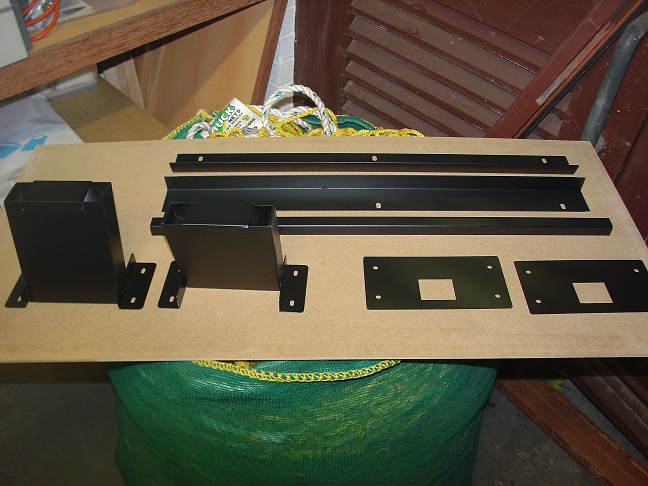

A little bit of progress, need some greys so will have to wait.

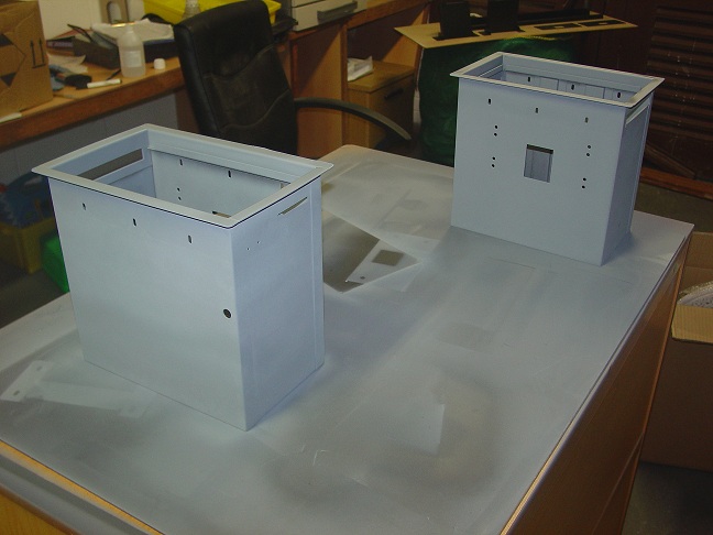

All black metalwork is now black
All of the coin doors and frame are primed and ready for top coat
(I need a coinbox door)
Both Coinboxes are primed and ready, might do them black internally, saves on the grey
Took them into work as weather was crap, nice warm boiler room to dry off
More to follow...

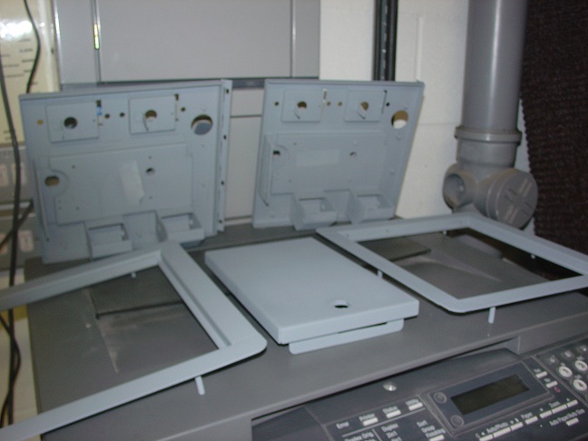

Ok, another thanks goto acidpants for a lift to Halfords, we have paint
(See pics !)
Pile'O'Taito !!
And door frames
Will lacquer them tomorrow and reassemble when dry, stay tuned
