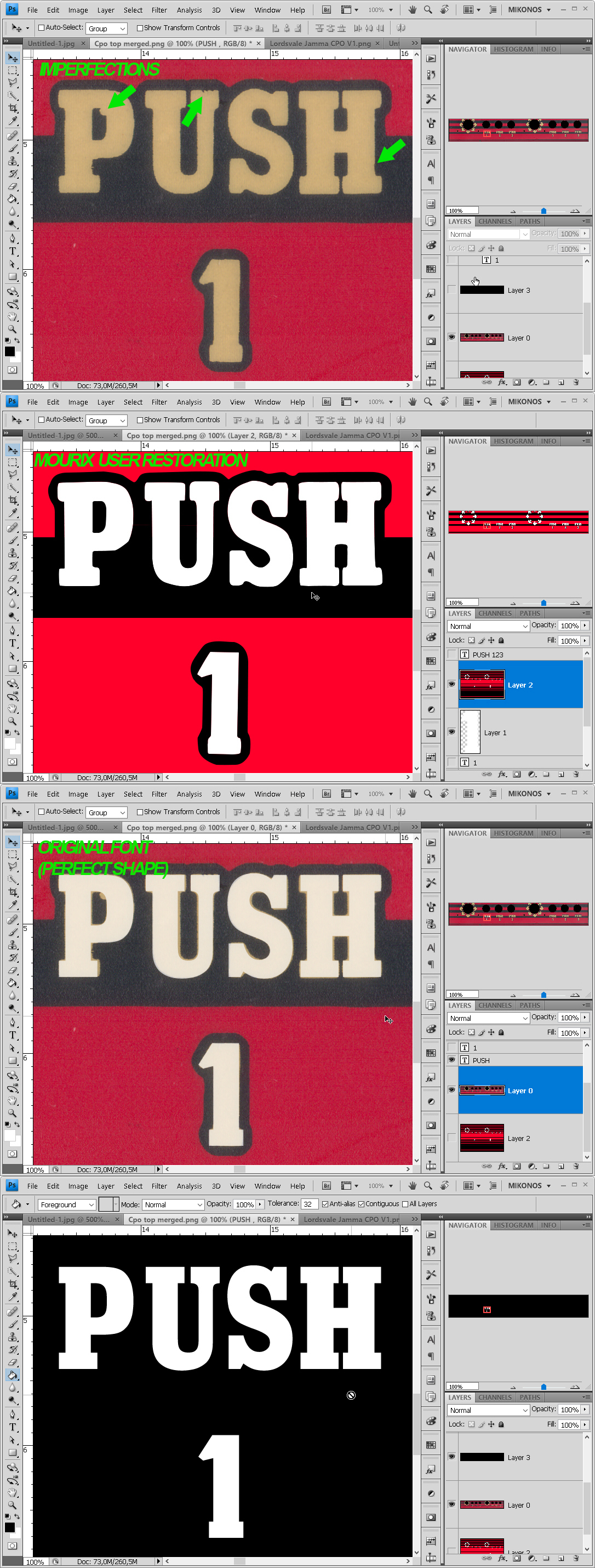

I love to restore original like they are, but when there are geometric form, I take some exceptions: Is better a perfect line than a irregular line, same with simple letters in some cases, like lordsvale Neo Geo CPO.
ADVISE 1: Letters
Is better to invert some minutes to find original font in pro to get the best result possible. Webpages like "What font is" and others are good options to find original fonts.
Example:
Lordsvale Neo Geo CPO - Restoring letters
Thank you for this advice. I did not know about that site!

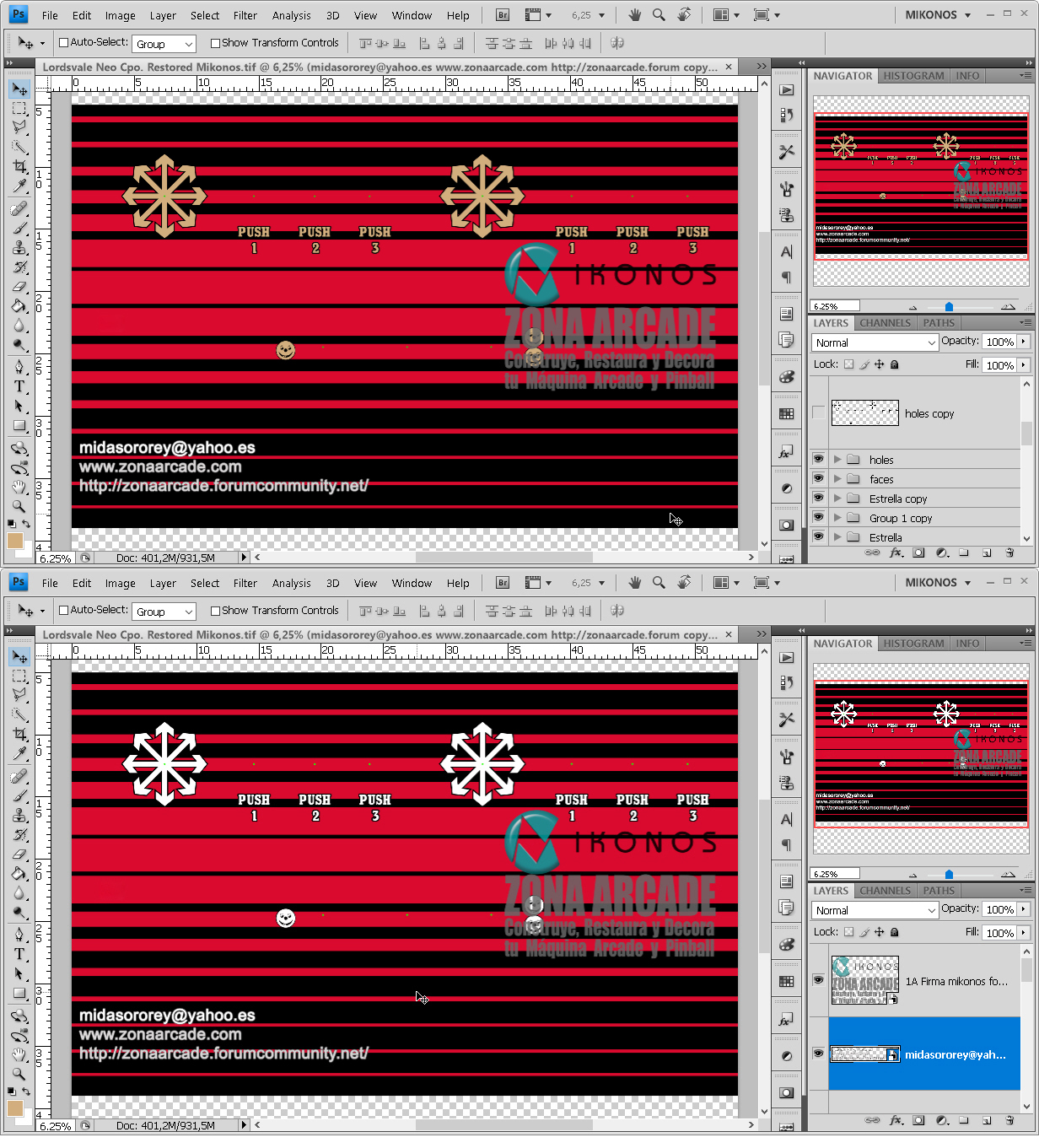

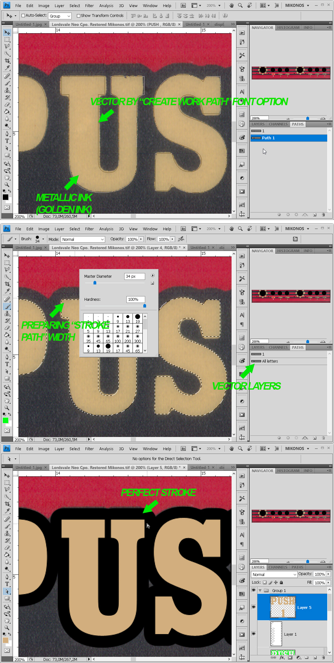

ADVISE 2: Perfect stroke effect for letters!
There are to way to draw the stroke effect in Photoshop:
1) With "blending options" and then go to strokes. This is not perfect because if you work with high resolutions and Stroke effect is so width you will see aristas all around curve shape. With of the stroke effect will not be the same in all shape. BEWARE!
2) If you have vectors taken from "Create work path" option, you only need to select pincel´s width and apply the stroke effect in "path layer"panel. Perfect results with perfect rounded shapes!
"Play Scene Lordsvale Control Panel Overlay" (LORDSVALE LEISURE LTD.) in restoration - Perfect stroke effect! By Mikonos.
Greetings

ADVISE 3: Perfect Star of Directions and Perfect sharpened stroke effect.
The only way to get a beautiful and perfect star of directions is to take all measures of all arrows and to promediate measures, even to premediate position of arrow to centre to get the best performace and draw a "vector figure"! :)
Automatic sharpened stroke effect is not possible in "Photoshop" but we can complete sharped effect drawings all corner by hand from original rounded stroke effect.
"Play Scene Lordsvale Control Panel Overlay" (LORDSVALE LEISURE LTD.) in restoration - Perfect Star of Direction and Perfect Sharpened Stroke Effect for Arrows! By Mikonos.
ADVISE 3: Perfect Star of Direcctions and Perfect sharpened stroke effect.
The only way to get a beautiful and perfect star of directions is to take all measures of all arrows and to promediate measures, even to premediate position of arrow to centre to get tthe best performace and darw a "vector figure"! :-)
Greetings

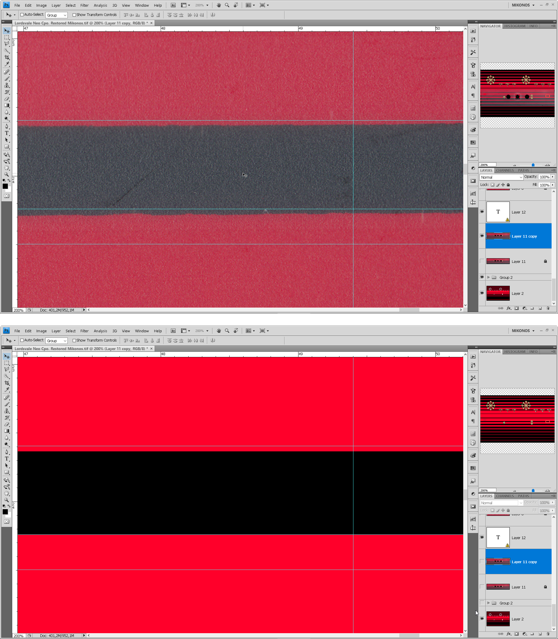

Well, I have a rules for my work: "If there is not alternative possible, I will vectorize it!" Why this is in that way? Because I respect so much the original artist´s handmade or I respect original printing formule.
In this case, you had copied imperfect nature of original; OK! but, why this:
I'm going to answer this for you, but don't be upset with me: It is because you wanted to save time. I respect it because you are not an artworker and this is the reason because I´m showing you some tips.
If I respect imperfect nature of original, I will respect it to the end.
Best regards

The reason was the original artwork was not put on straight, and I tried to approximate them in a straigt way. The difference is the tolerance of my guesses.
Mikonos11
92CR
Of course! What did you expect?
Straight Lines are not perfect straight lines and curves are not perfect curves.
In text fonts there are lines that must be straight, in arrows occur same, in stroke effects same. If we speak about curves...
