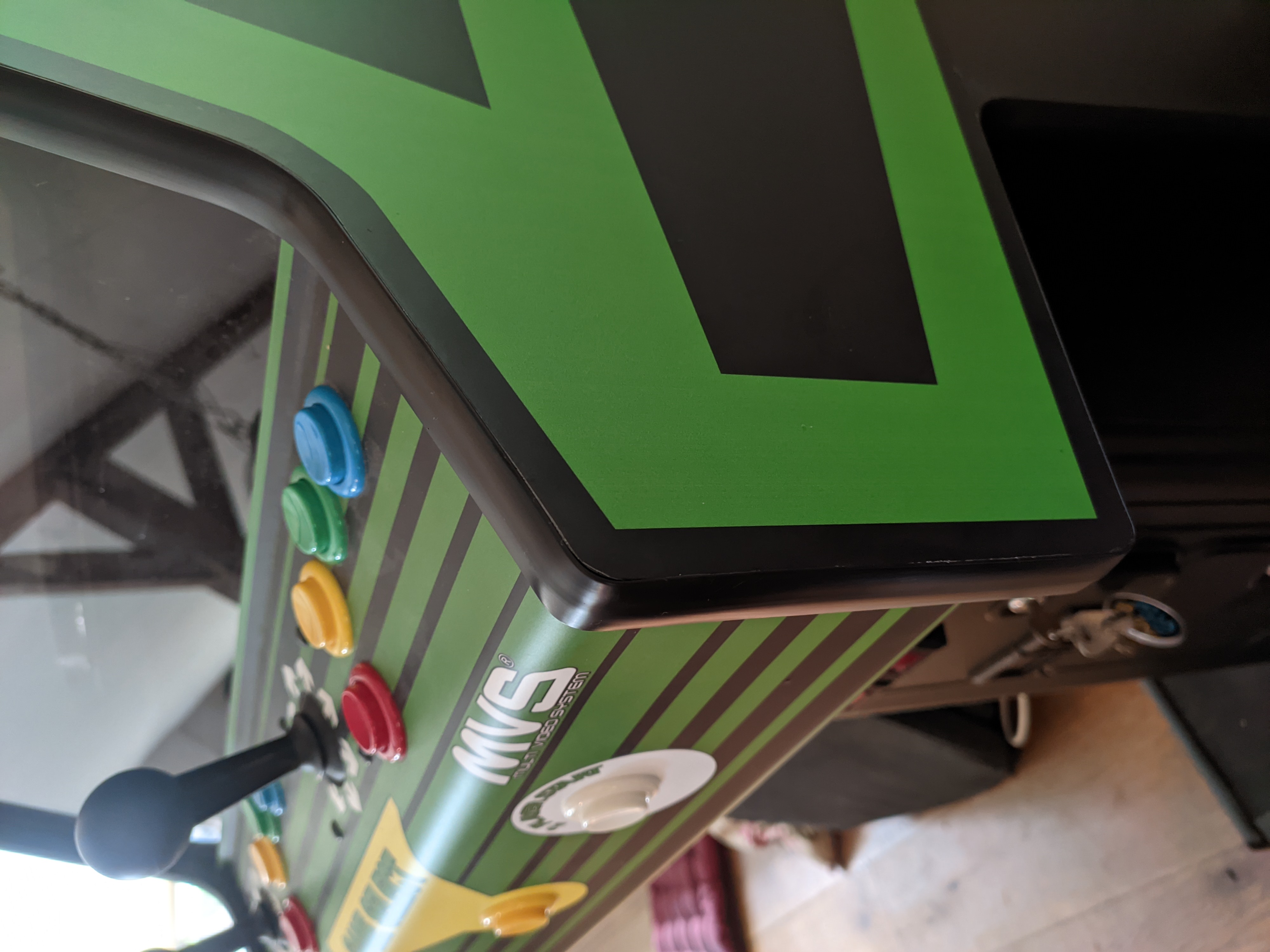

Control panel time
This was the original control panel. It had only three buttons per player despite the wiring for the fourth one being available below. The buttons are not dirty, they are in fact disintegrating to dust...:
This is my result:
So how did I get here? Well, this one turned out to be quite difficult. I had a simple idea of using the metal from some dollar store stainless steel plates. I cut up pieces and braced the bottom:
Drilled starter holes based on a template I had printed:
I then filled the holes and started dry drilling with my hole saw:
And then... BANGG The hole saw got stuck in the steel and completely bent the drill. I then tried to drill the last holes, at which point my whole drill machine quit working entirely.
Oh, and the steel also got loose. Fast forward to me buying a new second hand drill machine and cutting up some softer metal..:
Finally filled it for real this time. The holes are a bit on the big side, but this will work:
Hit it with some coats of primer:
Finally, the long discussed CPO is on:
I kept the original Suzo sticks but swapped the buttons with Ultimarc Goldleafs:
Repainted the joystick bolts and it's done!:
I am pretty happy with the result. Main lessons of the day:
*Don't use stainless steel if you don't have the experience to drill it, even if the sheet seems thin.
*Use a stepped drill instead of a hole saw if you want perfect holes.
*Use drilling grease for metal.
*If a drill gets really hot, stop drilling or you will have to buy a new machine...
