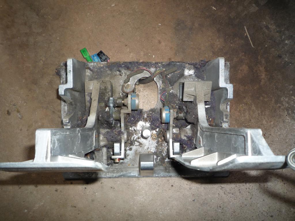

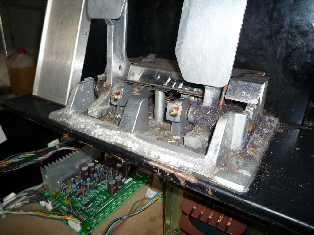

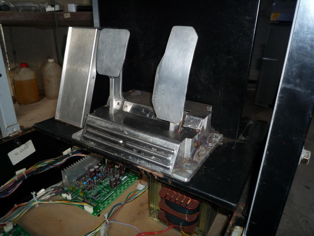

Initially the pedals didn't look too bad....
After taking the cover off, it became apparent the pedals may have never been cleaned!
Yep, looks like these have never been opened....

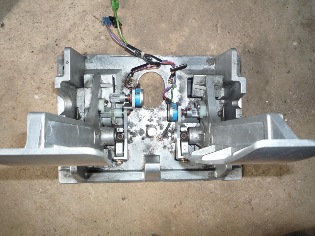

The first clean, just to remove the excess shyte...
A bit better, but I really gotta get the base sandblasted and powercoated as the rust needs sorting out....
