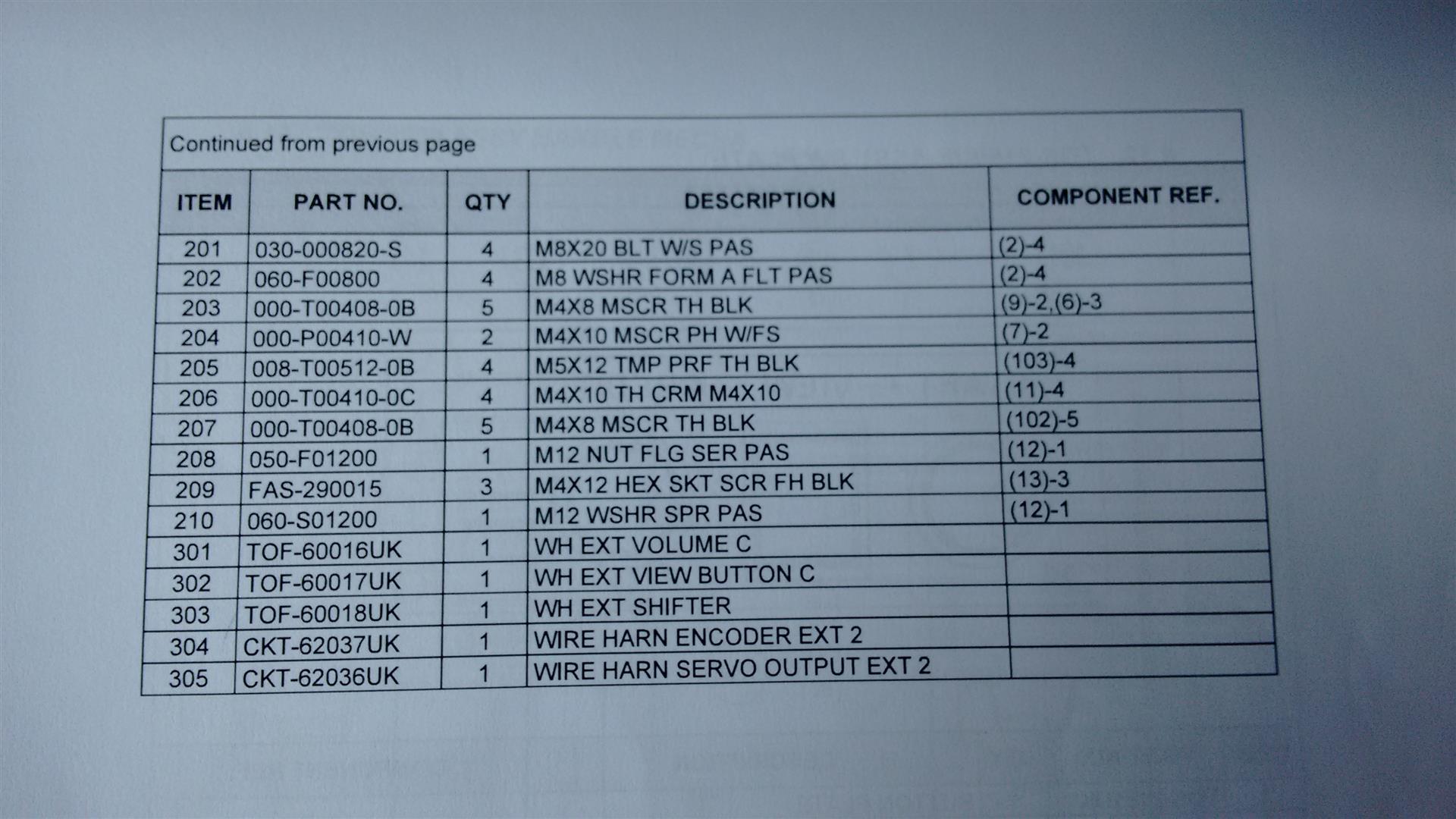

One other quick noob question, sorry. Looking at the manual (see picture below) what do the numbers mean in the Component Ref column?

The component ref generally shows the quantity of that item required for another associated item (shown in brackets). For example in the top row, item 201, four of these bolts are used on item 2, which I believe is ASSY HANDLE MECHA detailed on the previous page of the manual.

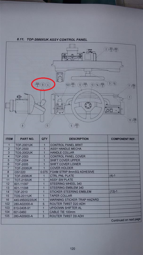

Makes perfect sense now. I could see the quantity and the screw/washer part number on the diagram like in the below image circled in red. But for some reason didn't associate this with the component ref.
So for item 203 in the previous picture it's now obvious that 2 of the 5 are used to attach item number 9 and 3 of the 5 are used to attach item number 6 which is also shown in the diagram below.
