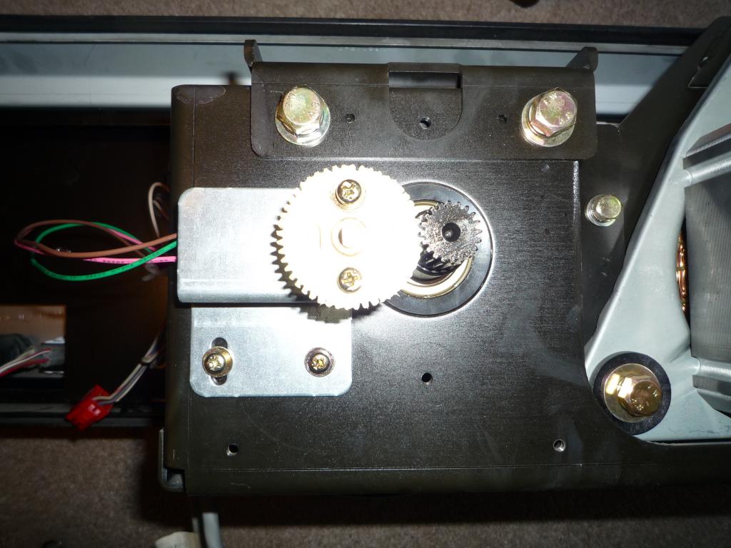

Also fitted a new pot to the steering assy, it looks like the motor was replaced in 2006 which is a nice surprise. The pot didn't need replacing tbh, but I did it anyway and will keep the spare in case one of the pedal posts start acting up in future.

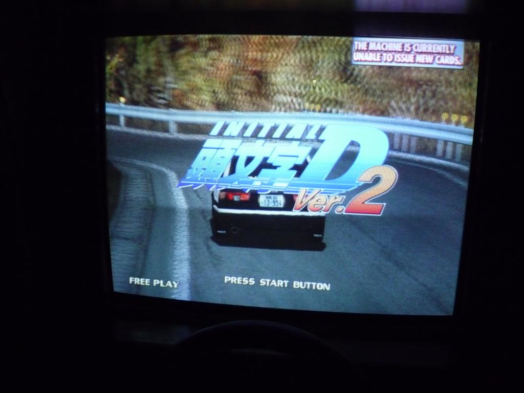

While the Naomi2 board is working I've been happlily playing away.
Card reader works fine as the next pic shows.

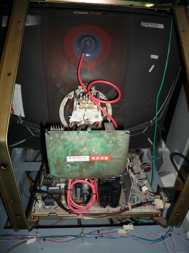

I did notice my monitor shorting/making a sparking/cracking noise when first turned on, kinda like a cracking noise from the board I think. It goes away after a while when powered up, could that be a dry joint problem or something more sinister?

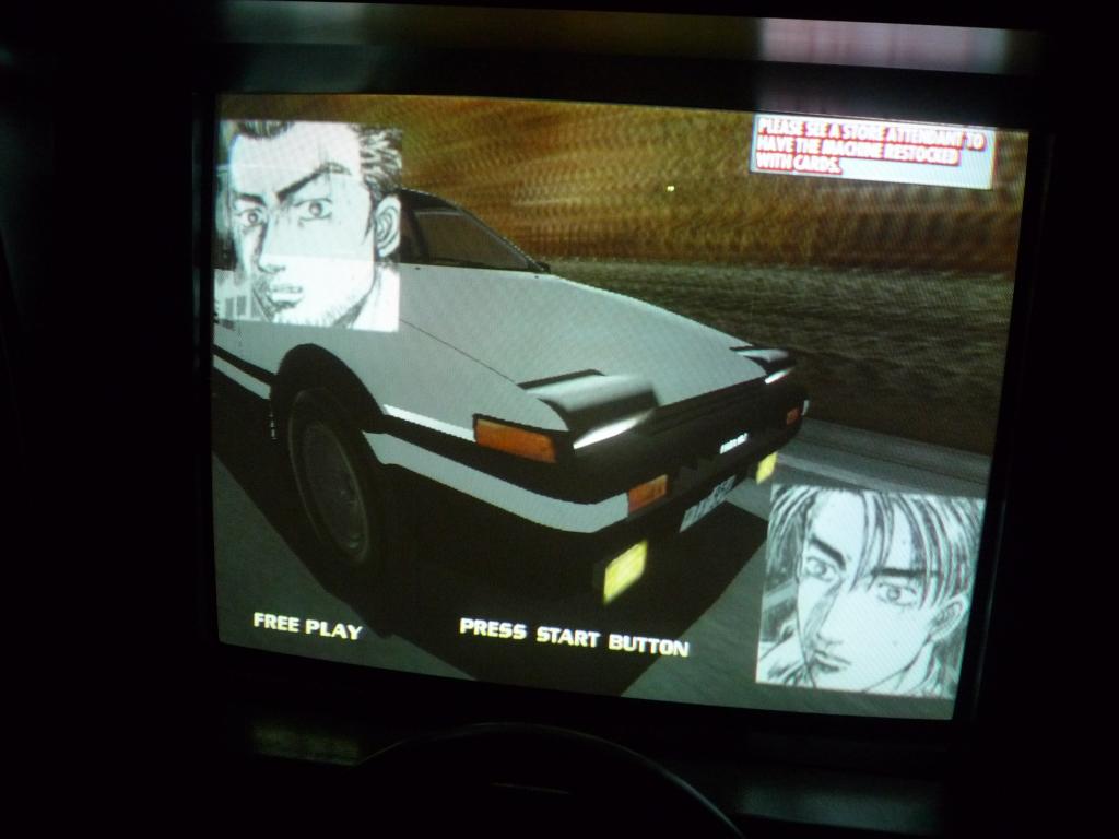

Also, would fitting a cap kit give me a slightly better image quality?

1/ Replace the rubber stopper bush inside the wheel assy as it's started to crumble.

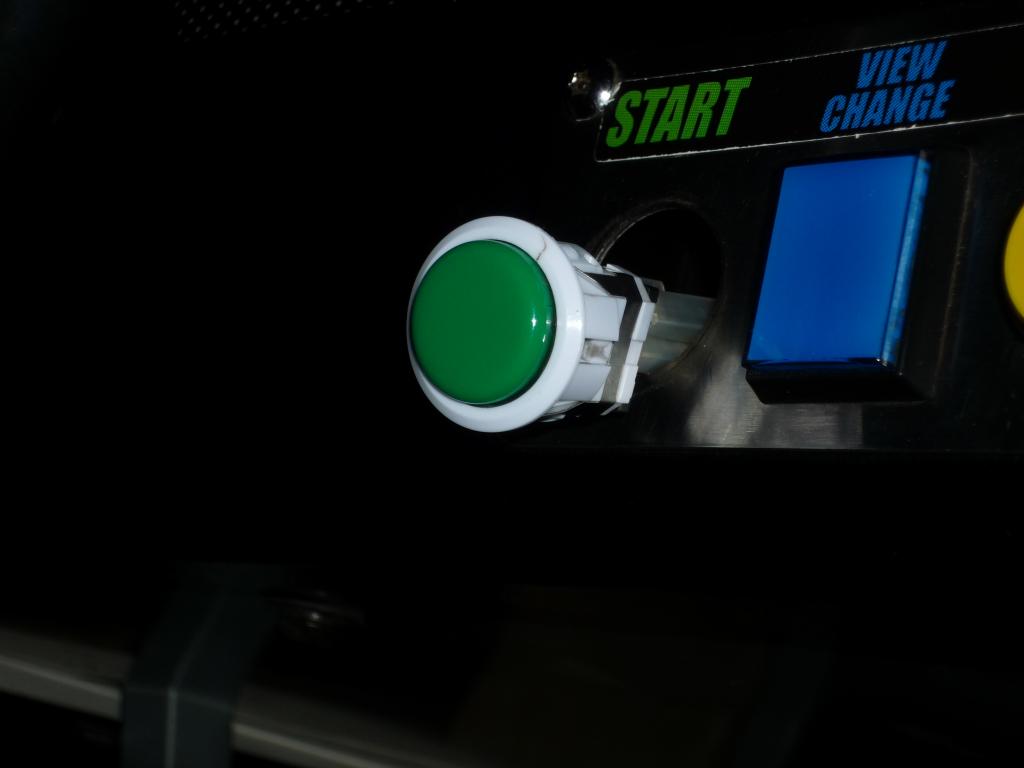

4/ Sort out the dim start button lamp. (I'm not sure how to remove the bulb if possible, or if I need to buy a whole new button?)
Goodo on the seat, erm another seat rail will have one :p or if you can borrow one to get a metal works to fab you a new one, simple sprung bar really.
Cracking, it's prob the cap on the top back of the tube, remove clean, mebbe lube and replace (be careful voltages etc)
The start button bulb will be popping out the button, either pull from front or push from back, then should pop open easy enuf, will be wired from either a 5 or 12volt feed incase it's the wiring at fault.

the focus isn't as sharp as I remember playing when in Japan...could that be the that the Toshiba tubes are that superior to the one I have? Would a cap kit give a bit better sharpness/definition?
Cheers.
You can adjust the focus at the back of the chassis.
This, it happened to me the other day. I got an HV probe to discharge the tube just to be sure, cleaned and refitted the anode cap and its been fine since. I need to get the high insulation silicon grease on to it though

I don't think a cap kit will help the picture to be honest. You can try tweaking the Focus pot but you might find that if you cure the centre of the picture, then the corner will be out of focus- that's how it works I'm afraid. Still, good you managed some improvement on the colours.

Call me a div, but I'm not sure how to get to the bulb on the start button.
I've tried prising it open with a small screwdriver but it just wont seperate? It does have a little crack, so I may as well buy a new one. Maybe it is the wrong button for this cab?

Well the picture isn't too bad TBH, I've tried using the focus pot but this is the best I can get. It feels like it could be a bit sharper thats all, at least as sharp as my DC on my PC monitor using a VGA box? I guess I have been spoilt by my trusty Sony GDM-F900 24" CRT. I've had it for years now and it's a beast, but, I just can't let go.....
It scared the crap out of me when it first happened, I seen it spark and then thought it had blew up!
Where abouts is this anode cap guys? I'm a complete amateur as to what the terminology is regarding monitors.

Heres the cap
also heres a guide how to remove a chassie (you only need the anode part)
When i get round to doing mine i was going to use a screwdriver and use a wire with 2x croc clips and attach one to the screwdriver and one to the frame , or i might invest in a HV probe , im like you , a little scared as ive never done it before

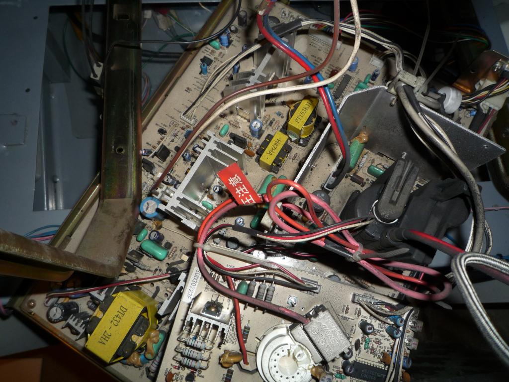

A little update.
The LOPT on my cab eventually got to the point where it sounded like a machine gun when the cab was powered on. So, I ordered a new one off Mo at a cost of 40 quid + shipping.
It was the first time I've ever discharged the Anode so I was a little scared/apprehensive, but I'm still here to tell the tale! After fitting the LOPT I initially thought the moniitor had completely packed up, it ended up being the Screen pot on the LOPT was turned right down.
Anyhoo, the monitor is back up and running and giving a decent picture, no different to the picture before but at least it isn't spewing sparks of plasma.
Old LOPT
New LOPT

Now to tackle the slightly squeaky steering wheel when the FFB is tightned, it may be the belt slightly slipping/creaking as it's quiet when the FFB is off/loose. Think I'll try some platen cleaner and see if that works....
