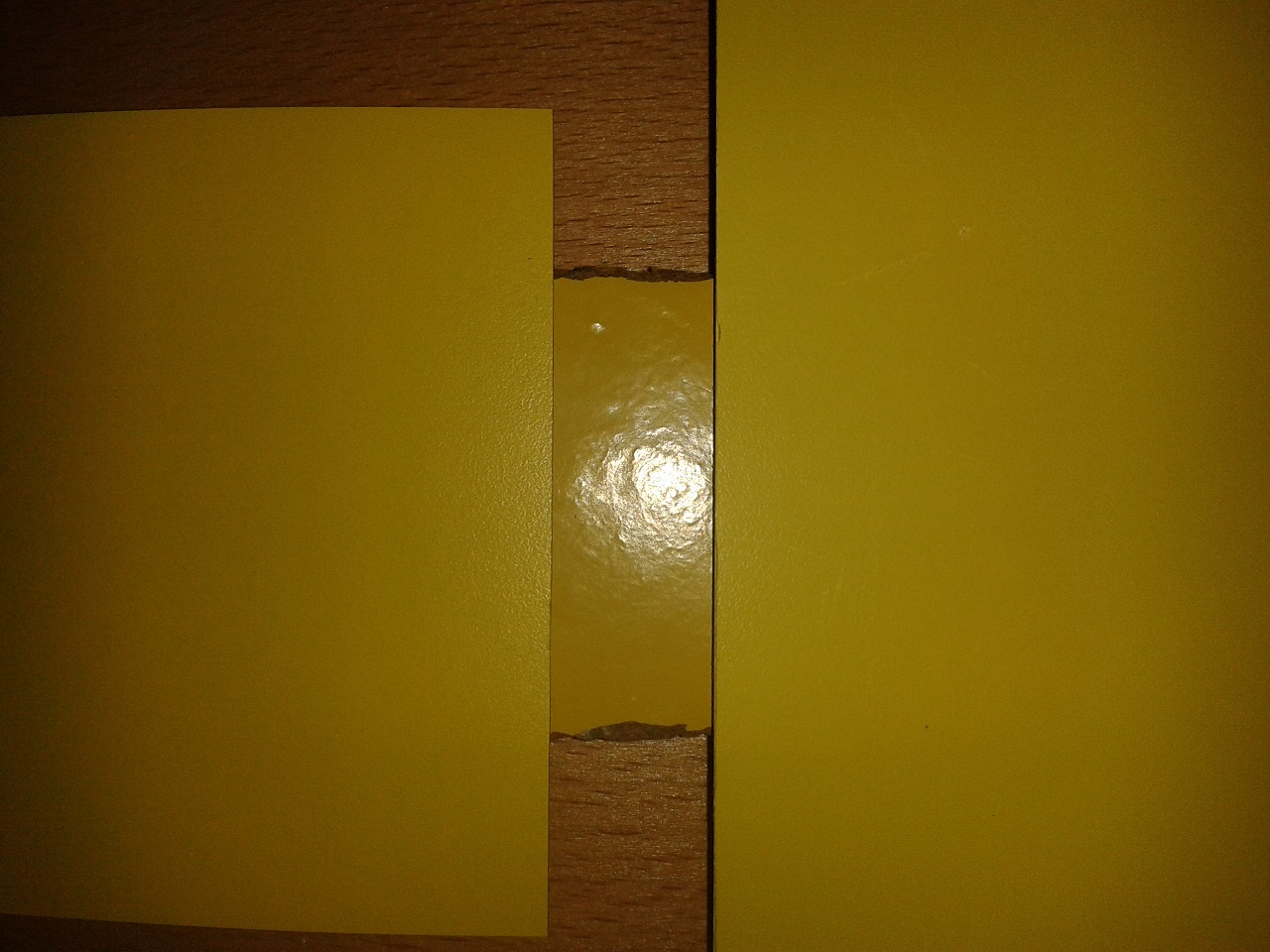

It's not going well so far. From a short distance the formica samples I have look fairly close to the original (original is on the left):
But when you get really close up they look miles different (original in the middle):
I may just have to go with the one of these as they might be the closest I can get

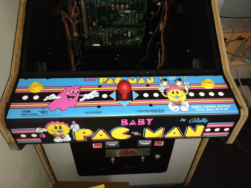

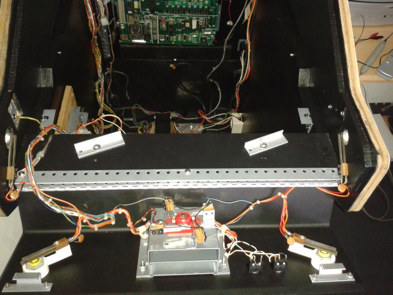

Done quite a bit of work on this the last couple of days:

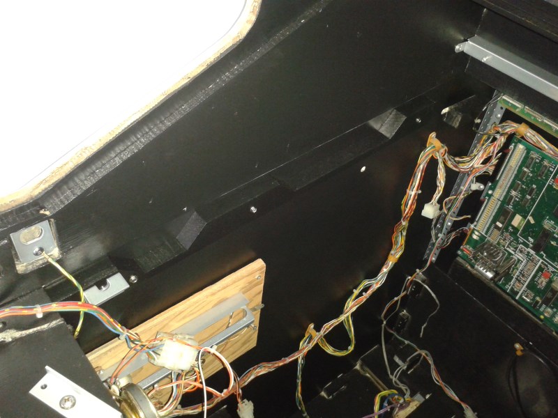

CP area is pretty much done! I've disassembled pretty much everything due to rust and clean it/resprayed it.
Removed the rails and repainted them, and also cleaned all the screws and brackets attached:

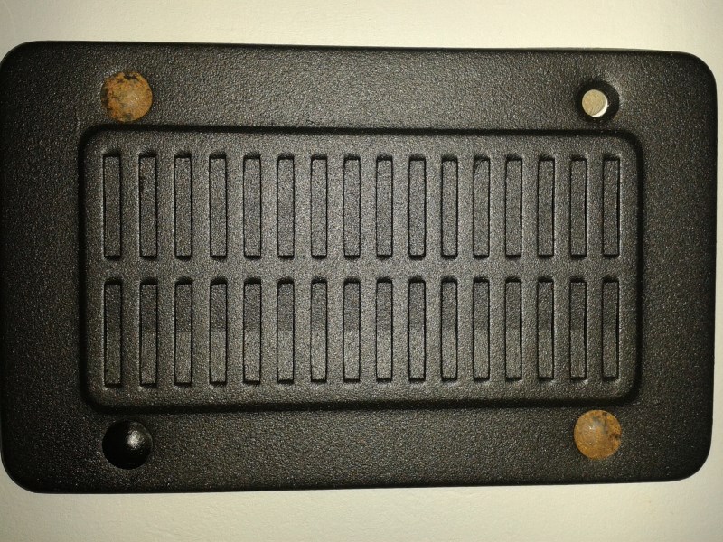

.....and I've started work on the speaker grills. They've been recoated, but you can see how bad it was if you look at the screws. Here's a before and after pic, as I did one of the screws today (bottom left) :)
Finish this off then move onto the coin door. That needs quite a bit of attention still :-(

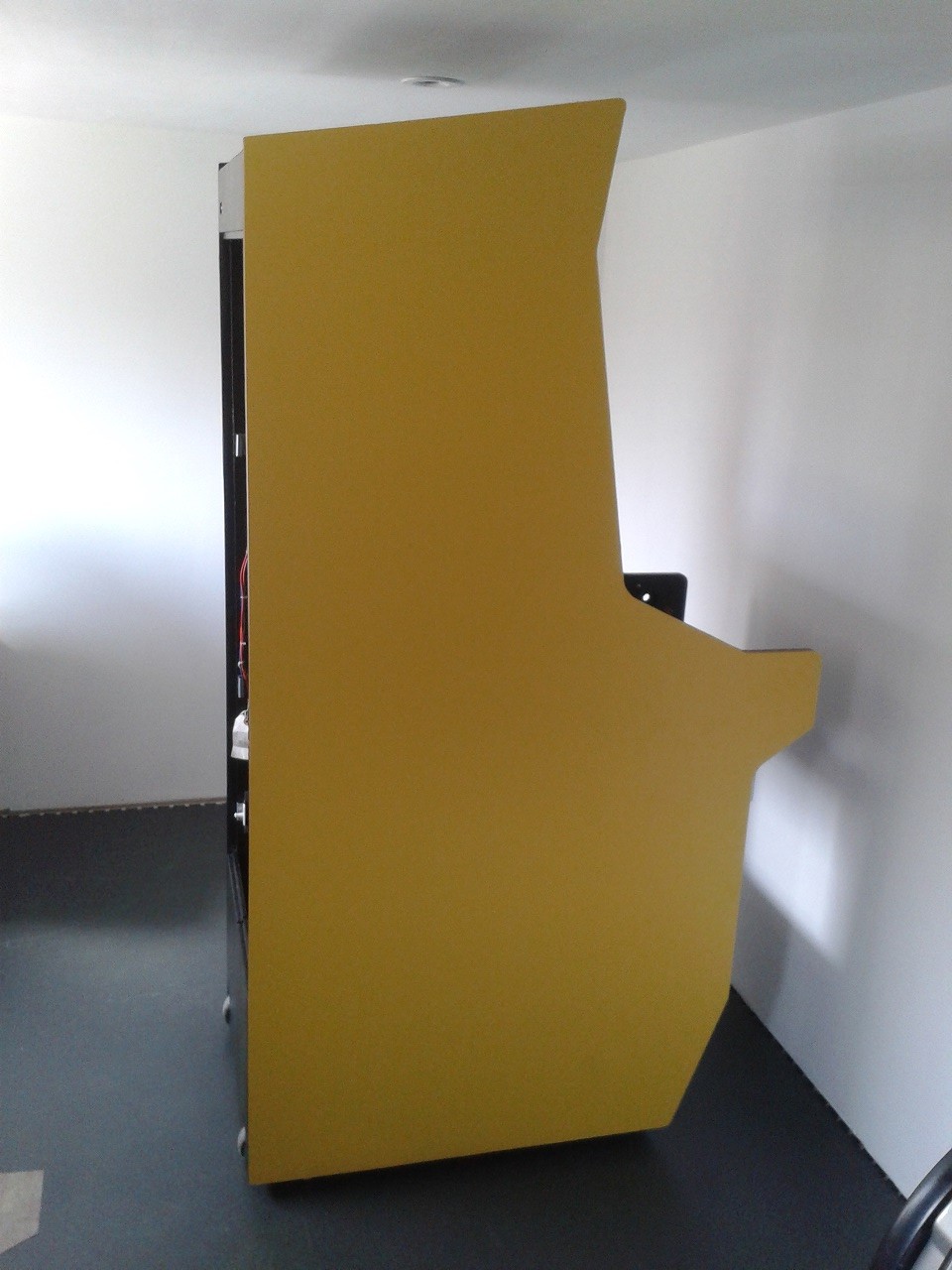

Spurred on by Strykr's recent restoration I thought it was about time that I did the sides and front on the Baby Pacman
So here we are with one side covered in Formica and routed:
Generally went ok. Let's hope the rest looks as good

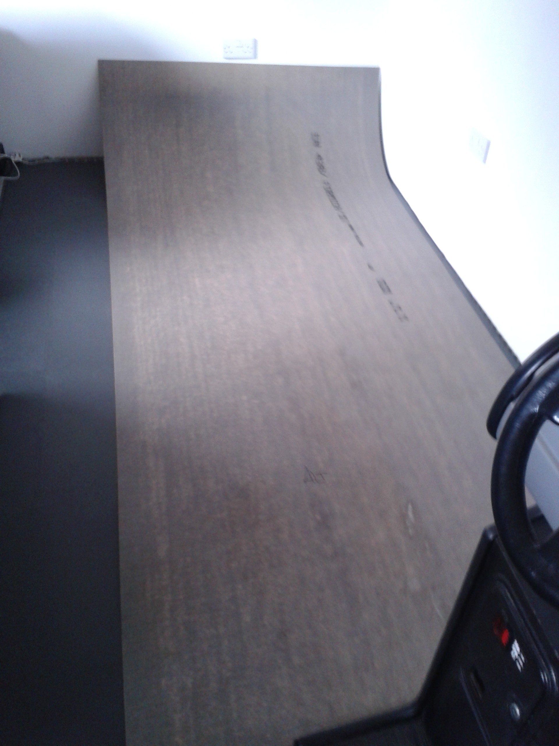

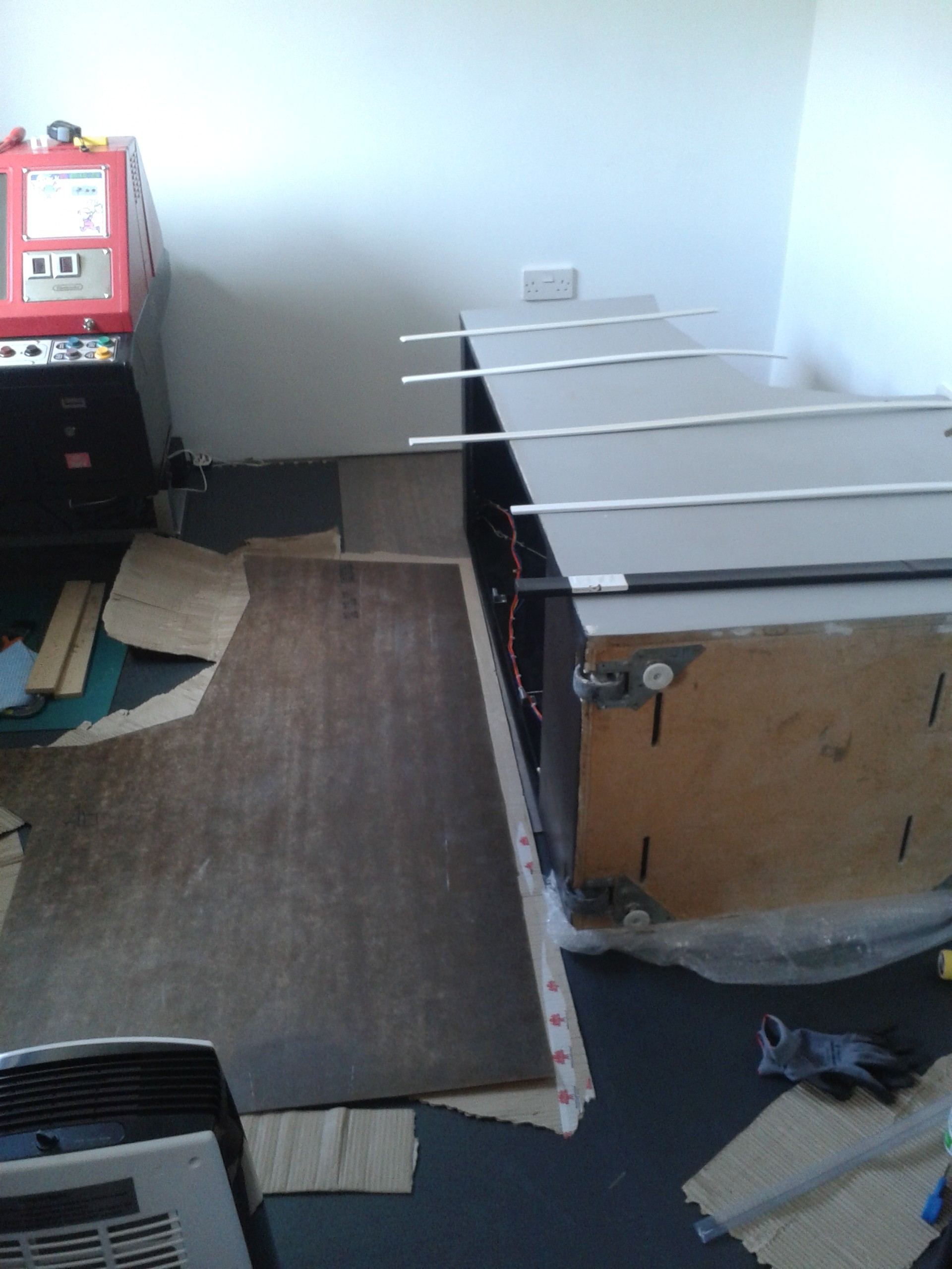

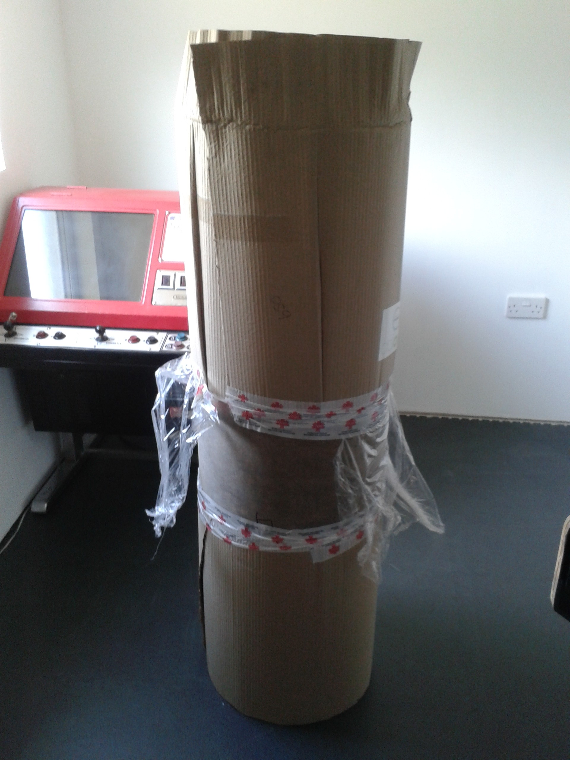

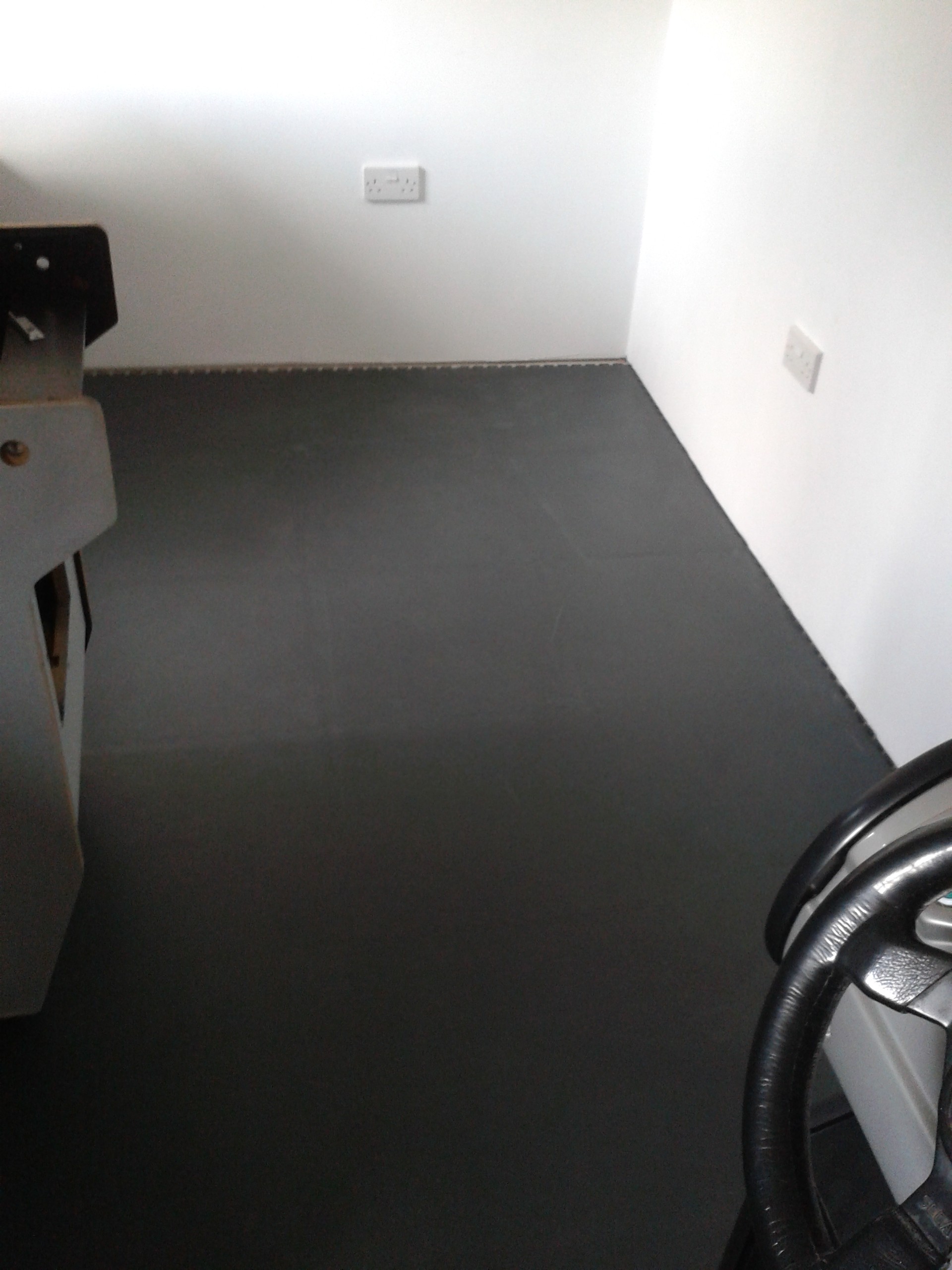

I thought I would add the story of the last two days to maybe help someone who may attempt this in the future. I've never used Formica or a router before but I'd say one side was fairly straight forward. The centre pieces are going to be the tricky bit.
So day 1 - Monday
I empited most of the cab again:
Cleared a big space in the garage:
Lightly sanded down the side of the cab with some fine sandpaper just to get rid of any bumps, and brush any dust off:
Formica time!
Unwraped the Formica, and let it flop level:
Then placed the cab on its side and drew round the cab adding an additional 1/2 inch all round:
Then cut it out with a stanley knife and got a basic template. Then brushed down the Formica to remove any dust:
Day 2 - Tuesday
Stuck some glue on both cab and Formica. I used Thixofix Eco which is really good stuff, and non hazardous. I used a foam roller to get a nice even spread. A good idea is to use a new foam roller on both cab and Formica:
Then cut some plastic strips, approx 1/2-1 inch and placed them on the cab so that the two parts do not touch:
Waited until the glue went clear, and then placed the Formica on the plastic strips. Moved into position and then pushed the Formica to the cab using a small wallpaper roller, and went along and removed each strip until the Formica was bonded to the cab:
I then got the router out with the flush trim bit, and cut off the excess Formica. The trick seems to be to let it glide round the cab without applying any pressure. But boy is it messy!
1 side done:
(see above)
Same again tomorrow!
