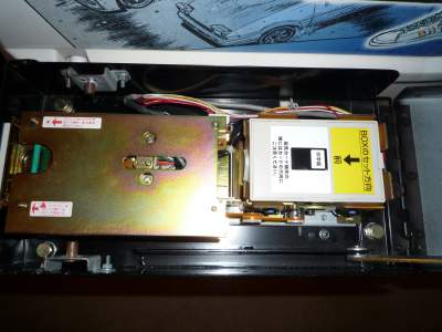

I met up with Mo today (a really nice guy) and bought a coin tower with a single type card reader bracket attached, heres a pic of my old one, ignore the random sticky substance that was there when I removed the card reader.

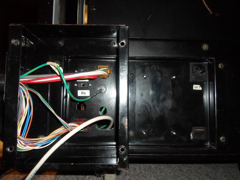

Can you take a photo of the back of your cab where the card reader loom plate is please, it should have a hole and 2 screw holes where the plate attaches. swapping from a twin type card reader bracket to a single type bracket, the place where the card reader connects is different.
Cheers.

IDCHAPPY said:
Has anyone got some pictures of how the card reader bolts on to the coin tower? the holes for my card reader don't match up at all, I have one bolt holding the card reader in place
There should be a bracket inbetween the coin tower and the card reader - this makes the flat surface for the card reader to attach to.
I'm guessing you have a UK card reader..?

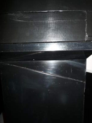

As Gary said, the coin tower has an extra bracket on top of it that levels the surface for the card reader to mount on. The pics are not that great tbh, but hope they help.
If anyone has a single cabinet a pic of where the card reader loom attaches to, that would be helpful to me.
Cheers.

This is the back of my initialD single cab. Single cabs have a box and plastic pipe covering the looms that run from cab to coin tower. This shows the box (to the left) with cover removed and AC plate (to the right) as I know people often want to see this too. The card reader loom is on the yellow connector.
Remember, this is a single cab so the AC plate doesn't have a link out the a slave or master cab like a twin would..
