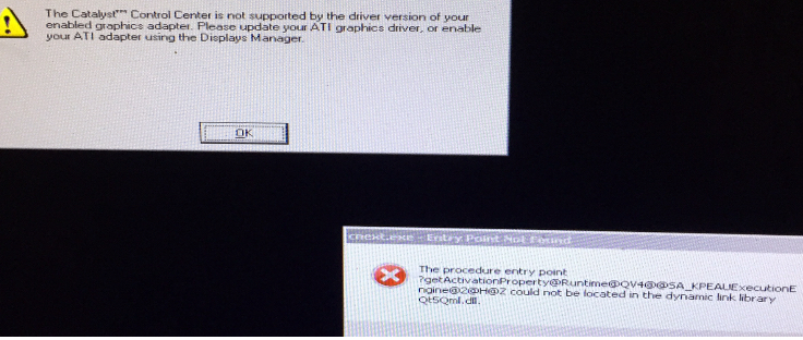

After video modes genaret
I can’t click install
And video card is standard vga adapter
And warning box days the catalys Controll center is not supported
Retroman8392020-07-04 18:44:14

Weird, can't work out why it's moaning about the CCC, I don't think it gets installed. Which option do you choose (1,2 or 3) and does the correct card name appear in the ATI window before it reboots?

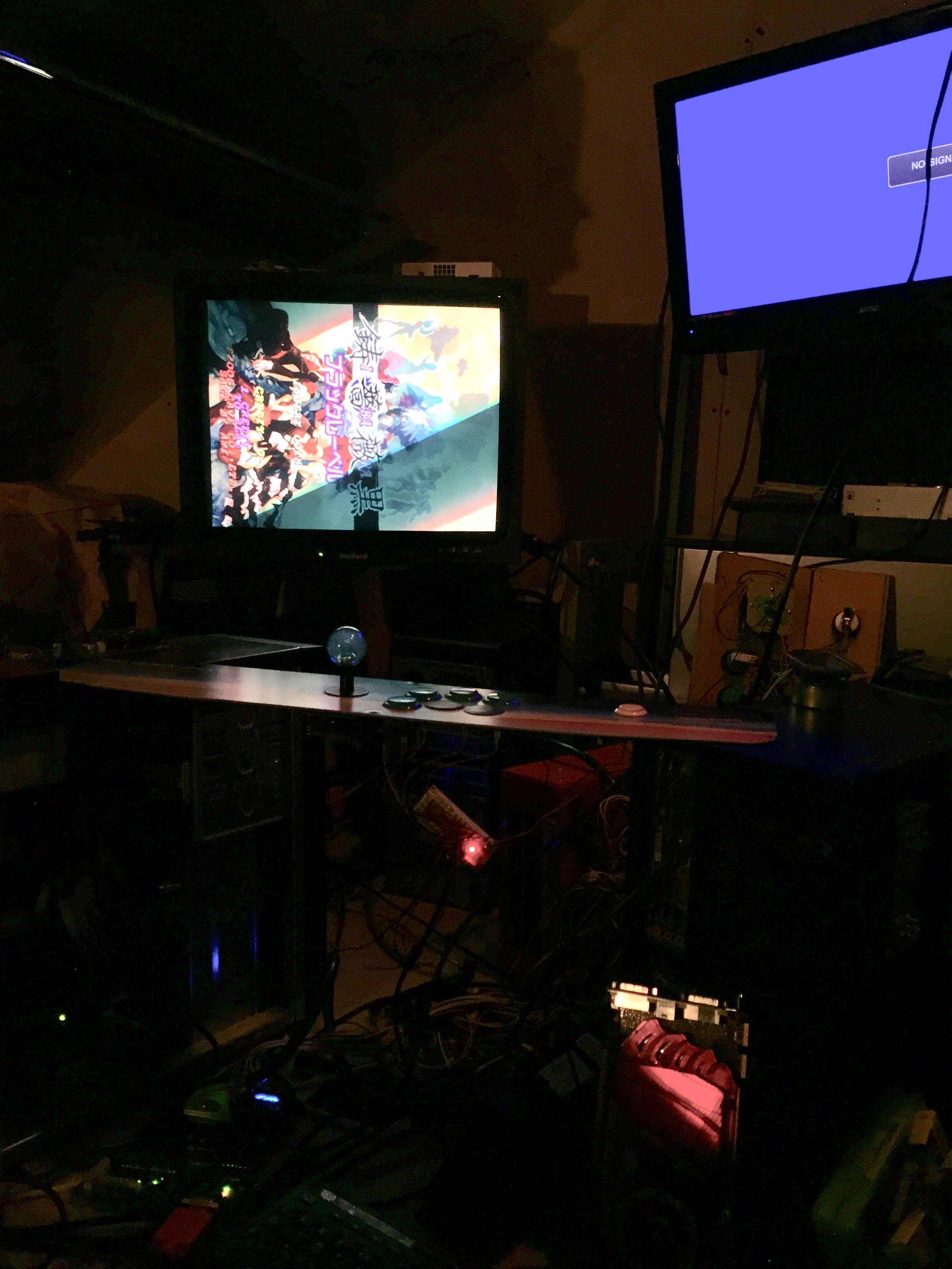

Rich thank you for doing this....
It’s awsome!!!
Finally and calamity
I was just trying to many things you know!
Went back to the r7 360 2 gig gpu card
Deleted the amd driver that I installed ( incorrectly I have to add !!! I have read your instruction but I’m a bit countryside if you know what I mean!!) prior..
Then just manually went through the crt drivers one buy one
It was the 2.0. Beta that recognised the r7360 card....
And that was it I knew I was in then....
So I went through the vmm in each of the different crt emu drivers
Until I found the one that installed the 120 mode lines....
Can’t tell you how chuffed I am with this big gratitude to you
And calamity... the win7 embeded rocks!!!!
This is going straight in the egret
And on to the next I got 4 pc here and like 6 gpus. Man this has been like a year project for me
As learning Neo geo repairs and crt chassi repairs all simultaneously and after 2 years it is all slowly sinking into place! I’m even doing my own bios’s Too!!!!
Massive respect ?
