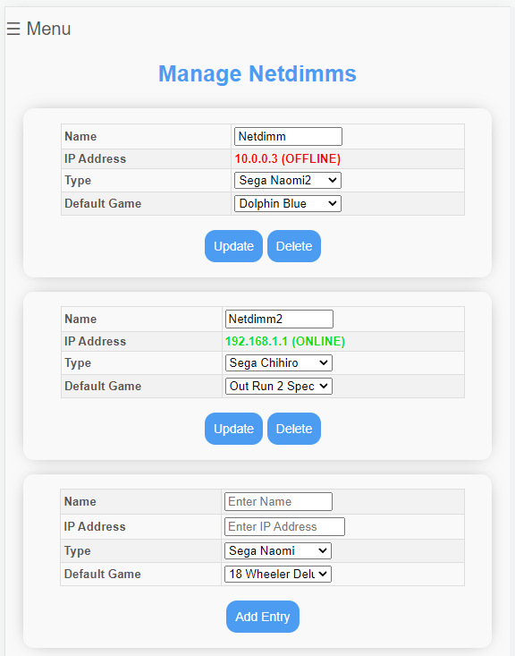

No problem, I've added the code to handle a default game per netdimm so you control it using the Netdimm Management screen. Just need to update the check script on bootup to read the file and send - give me a couple of more days to test and I'll send you the files
chunksin
21 (100%)
733CR
OK, this should work: https://drive.google.com/file/d/1UKsWMNS5cuWZCTRvF1hk2a7ucki2c6mY/view?usp=sharing
Copy the files from the zip file to the relevant locations on the pi and it should work fine, it will reset your configured netdimms but just set them up again and choose a default game from the menu. When single boot mode is enabled it will send the selected game to the relevant netdimm if it can be reached on the network.

My Setup:
WiPi with your updated files on Raspberry 3 ... (Replaced the files with WinSCP over LAN)
IP 10.0.0.1 connected to a switch which is then connected to the two Chihiro´s one has:
IP 10.0.0.2 the second one has IP 10.0.0.3
I set GW and Primary DNS on both of them to 10.0.0.1 (One thing i still can´t figure out is what the MEDIA and CORE Setup on Network is for on the Chihiro´s)
It won´t single boot at all (which is activated in the menu) any of the two chihiro´s. Only if i manually load the game again via the menu i can load both systems "Manually" via the Webinterface.
I tried random reboots in different order.. first the Chihiro´s than the RPI as well the other way around.
Something else worth nothing as soon as i boot both of the systems manually.. one of the Chihiro´s "Dies" with a reboot and Gateway error.. Probably related to the Timehack (it is enabled in the menu) since i do have Zeropics installed but the seem to be the ones that don´t work probably (bought them from someone in Spain on Ebay)
Any tip or help is appreciated!

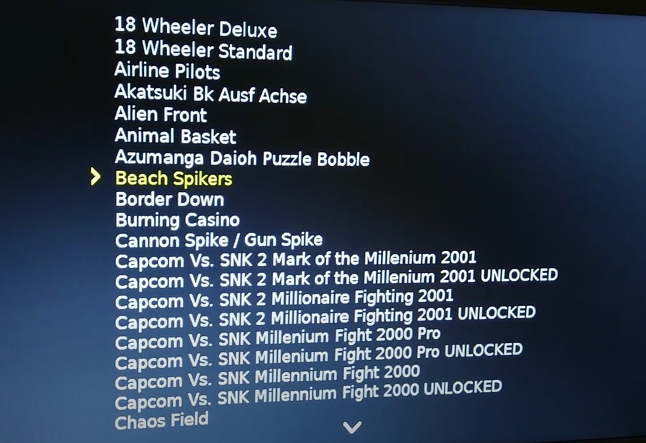

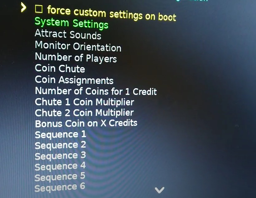

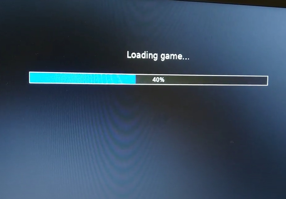

This release includes an on screen menu for game selection that runs on a Naomi or Naomi 2 and pretty much makes it a Naomi multi solution, no need to use a little LCD screen or connect using a browser any more. You can set the menu to be sent to one or more netdimms on startup and resend the menu on cab reboot.
A vid of my early work integrating the menu: https://youtu.be/T7OxV7hRFJ8
For games using the card reader, please launch from the web menu, support will be added for the on screen menu later
Controls can stop working in the on-screen menu when using OpenJVS, use the button combo to resend the menu - hold Start + 2 other digital buttons for 3 seconds

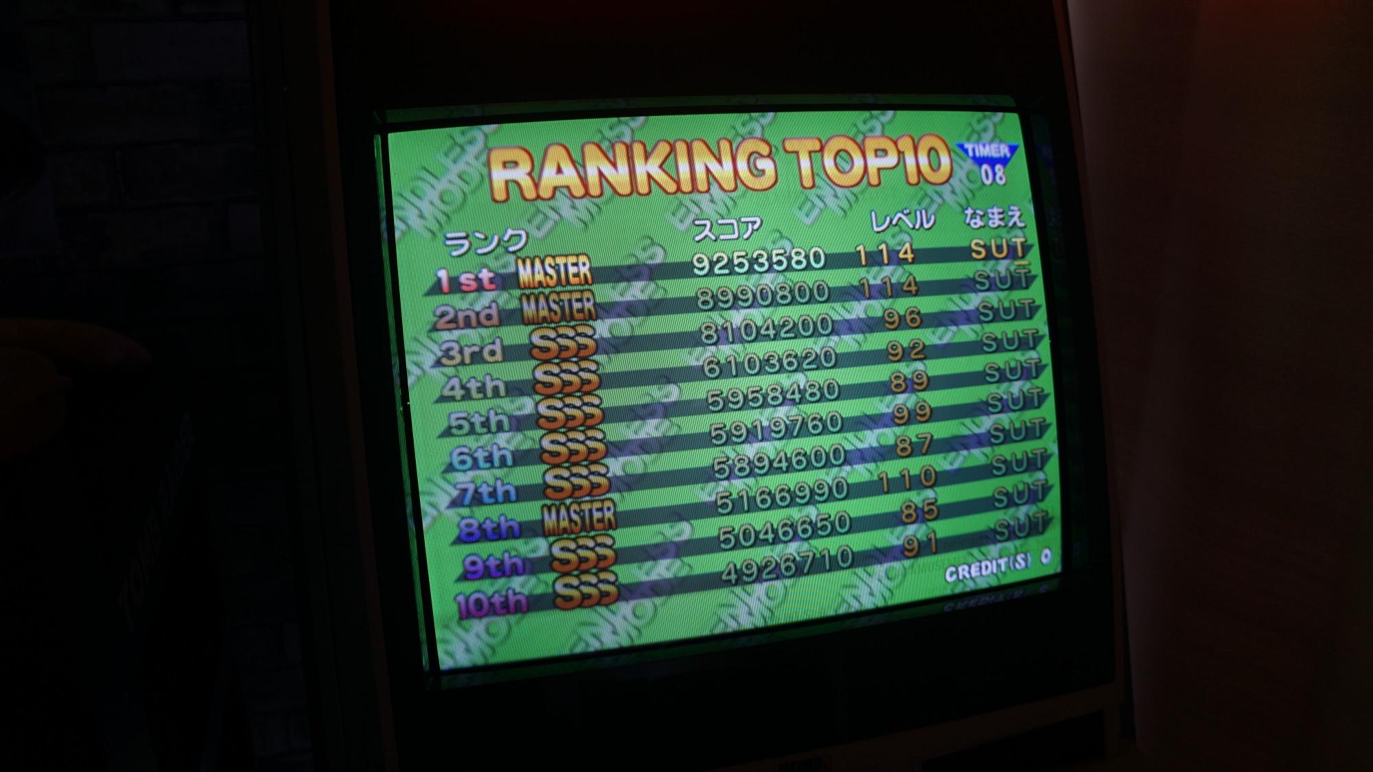

Does the the Naomi on screen menu affect already stored High Score/Game data?
Since loading a new game wipes everything.
My Naomi has been running ONLY Cleopatra Fortune Plus for 6 months+ now and I've gotten attached to my high score board:
Would love to be able to play other games again and not have that score board reset, without having to buy a second Naomi.
Would such a functionality to back up that data and re-insert it ever be possible?

So this would be possible using attach/extract SRAM functionality?
Is that built into the new menu system/original wipi user interfaces in a way that command line is not required? Didn't notice it in your demo video.
Suteneko2022-02-11 11:22:18
chunksin
21 (100%)
733CR
SRAM attach I think works if you have data generated and saved from an emulator like Demul. I don't think you can read it from a powered on Naomi because you would need to load a custom homebrew rom to be able to read and save it and by loading that you would probably flush the contents so it's chicken and egg, I will ask though
